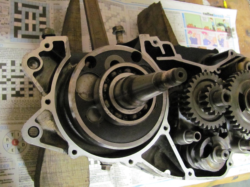

Re: ty 250 mono aftermarket parts
Right back to thread, fitted IT crank into TY Mono. 2mm shims either side have centred crank nicely and it all fits lovely ! As can be seen there is now a lot of empty space in there that would originally have been TY tractor crank. This has the effect of increasing volume and reducing scavenge pressure within the crankcase. Time will tell if this is detrimental to the performance as it basically undoes the benefit of reduced inlet length, etc.
Shall order a 70mm Wiseco YX MX piston from Birks and this should bring displacement back to 250. These have the large crescent cutout at back so again its a another unknown added to the pot!!
I would think the fact you have probably reduced crankcase compression by around 30%, that this is likely to have quite a noticeable effect on performance. But I guess if its something that was carried out on the works bikes back in the day, that its got to be something thats well worth doing.
Ferretflasher
- Posts: 102
- Joined: Fri Nov 24, 2006 7:45 am
- Location: grimethorpe, UK
Spoken to a local scooter racing guy other day and he thinks that because I have increased the volume of fuel/air within the crank case then there is more fuel/air to be scavenged into the transfer ports and hence more into cylinder. With the standard flywheel, there was not much free space left in there, most of the volume was contained in the 2 halves where the rod is located, it really is a snug fit in there as standard.
Its either going to go 1-of-2 ways .... it will be either totally rubbish or will rev like a good 'un !! Time will tell !!!
Bought a clutch of eBay other day and it contains dimpled steel plates .... never seen a TY with dimpled plates before ...... its a trick often used with Mont 315R plates as these are same as CR250 'Sureflex' MX clutches. Dimples hold oil and prevent drag when faffing with gears etc stops the steel plates sticking to the friction plates.
So reducing crankcase compression is not a works mod you have on your ex works MA motor then?
