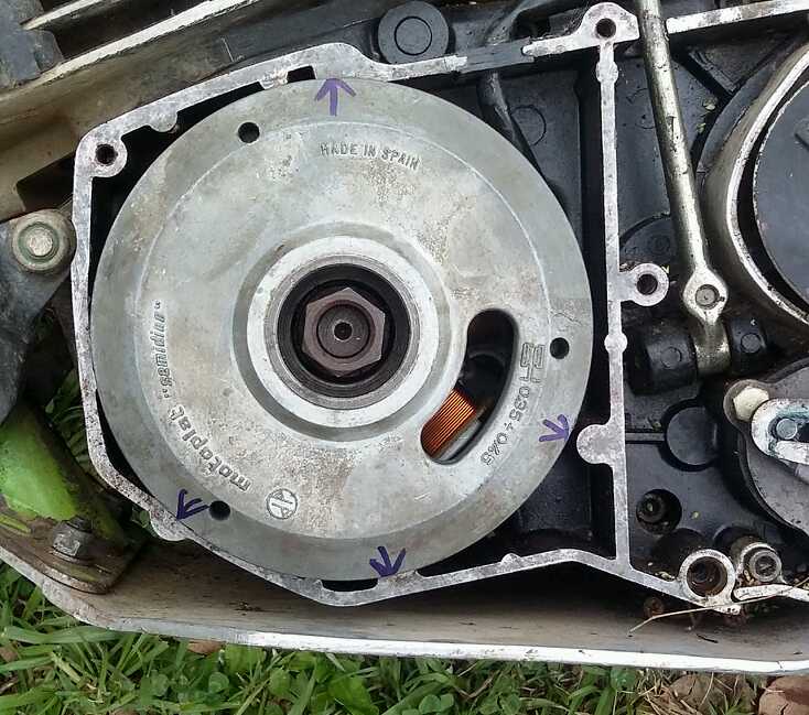

It is PLAUSIBLE that ITALJET used DUCATI motors. Here is a photo of magneto which looks bigger than the original designer intended. I have marked where other mounting points have been rendered obsolete, so more than 180 degrees around crank has no magneto cover screws.

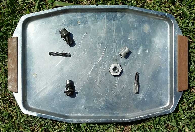

It was my first ride after fixing gear selection problems when I broke the kickstart. Gear selection had always been a bit tight and it took me a little while to work out what was going on. The aluminum detent bung was deformed, most likely been hit and jammed the ball end part (bottom right of photo) not allowing the spring to compress. When I pulled it out, there was a crack most of the way round, so it was easier to break it off to release the ball end part. Luckily :yamaha YZ80E detent bungs are the same thread and made of steel. :yamaha TY 175 (bottom left of photo) ones are similar, but the bore is too big.

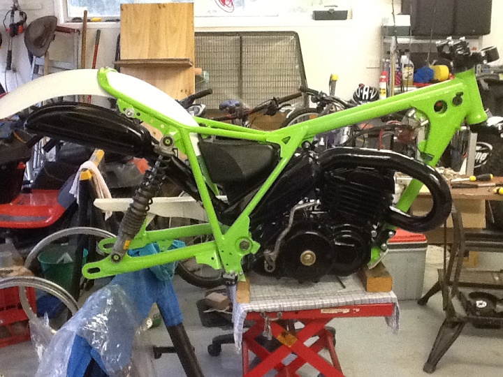

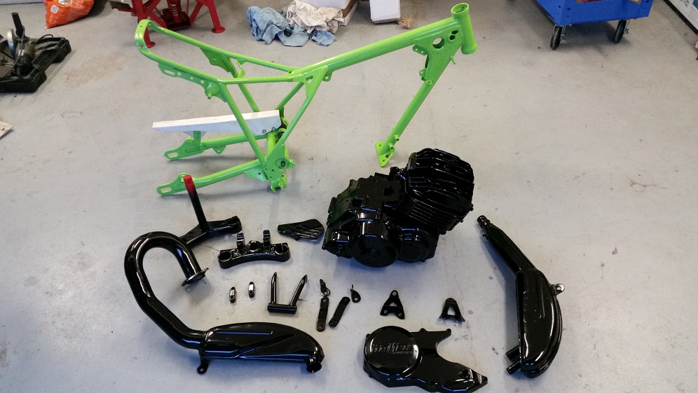

resurrect a Italjet
Post by darrenc »
just for you Greg
Your Italjet is starting to look quite good Darren. Now you need to make it run as good as it will look I reckon. :mrgreen: Graham.

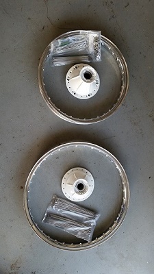

Darren, bikes in bits is how I like to see them, your 250 PIUMA is looking the part, a little different to when you gave me a ride at Kyogle! Are they Stainless Spokes?

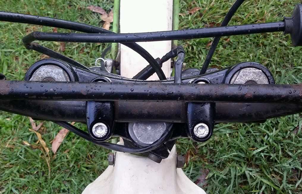

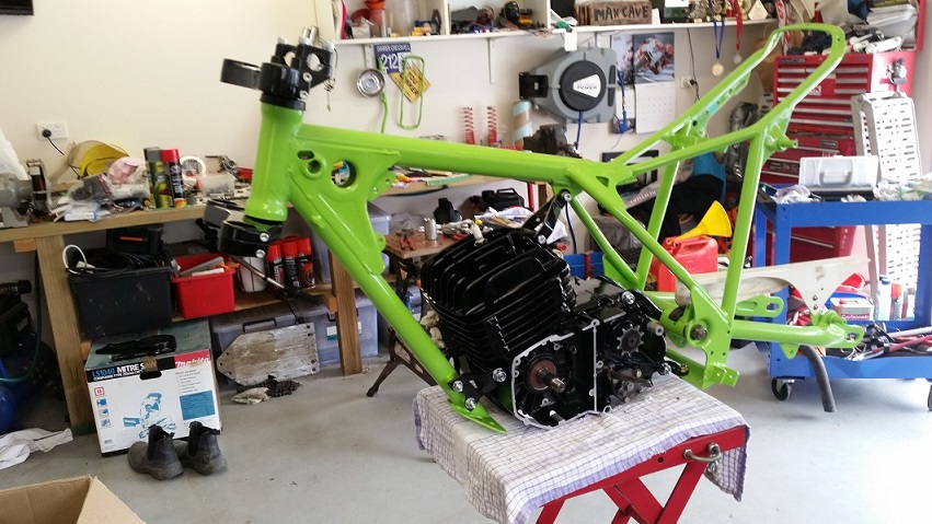

Just sharing an update on my 350 PIUMA
Having the handlebar mounts behind the headstem can feel a little funny, (sometimes called Tiller steering makes the bars swing in an arc) is another complaint I have heard about ITALJETS. My long arms make me a little cramped with the standard set up, so I have moved the bars forward 32 mm.
Has anyone else done this, I would be interested in feedback as I am not sure if I am simply justifying the feel after going to the Effort? Theoretically, manipulating the handlebars can give the same handle grip location in relation to the headstem. That is something that I learnt when reworking handlebars, I even experimented with 6 bend bars which work well on :yamaha TY175. Both Franken KT and FANTIC testarossa have had the same relocation and both feel better than standard. As for the PIUMA, it feels better standing and balancing.................
If only I could start It?
