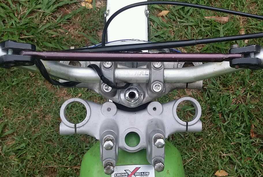

Curiosity got the better of me, so I roll started the PIUMA on SUNDAY! Had to adjust the bars after riding it for a while to find the right position for me and I am very happy with it now. The main advantage of moving the bar mounts as I see it is the angle of the grips does not change like it does with simply rolling the bars forward.
Below is a photo of :kawasaki FrankenKT with bar mounts moved forward along with a standard top:
It is an easy conversion with no welding required. I simply cut the mounts off with a hacksaw and filed them flat. Then re drilled 4 holes using the 2 front holes for location and tapped them 8 X 1.25mm. Then drilled the middle pieces out to 8 mm, longer bolts were my only Expense!
Greg that's got to be the most creative and economical method I've ever seen for doing the bar mount move mod

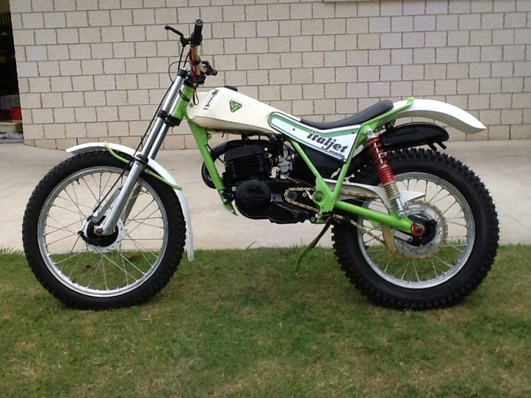

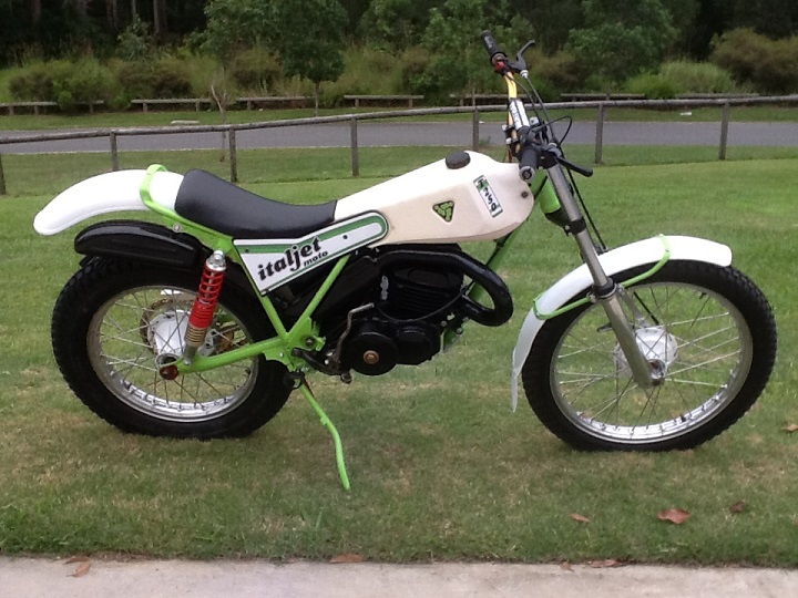

all done just need to do some tweaking
Nice, Darren. What shocks are those and are they good?
darrenc
Posts: 25
Club: logan river
Bike: gasgas280
Post by darrenc »
magical shocks. don't now yet but rode my mates bike in the uk with them on and like them so we will see how they go
That does look good Darren. Very nice!
