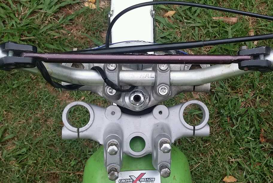

Curiosity got the better of me, so I roll started the PIUMA on SUNDAY! Had to adjust the bars after riding it for a while to find the right position for me and I am very happy with it now. The main advantage of moving the bar mounts as I see it is the angle of the grips does not change like it does with simply rolling the bars forward.
Below is a photo of :kawasaki FrankenKT with bar mounts moved forward along with a standard top:
It is an easy conversion with no welding required. I simply cut the mounts off with a hacksaw and filed them flat. Then re drilled 4 holes using the 2 front holes for location and tapped them 8 X 1.25mm. Then drilled the middle pieces out to 8 mm, longer bolts were my only Expense!
Posted: Mon Feb 01, 2016 10:39 pm
Greg that's got to be the most creative and economical method I've ever seen for doing the bar mount move mod
