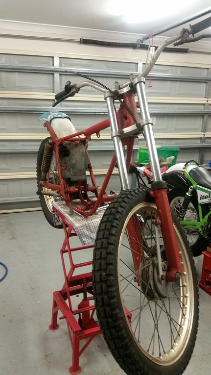

Just thought I would post up another photo of the
242 rear shock and it is quite a long shock at 250mm eye to eye..

Those are Gas Girlings and while they were popular shocks at the time, would not have been the original shockies on 242s, so may not be standard length for a 242

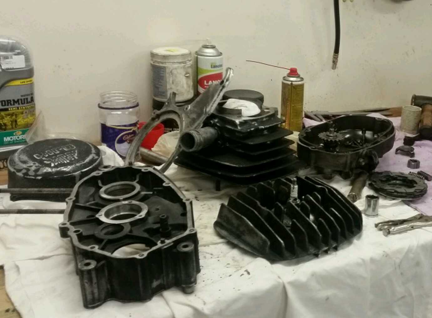

320 Greg .just to make things more interesting working on two at the same time
- 20160504_181512.jpg (202.24 KiB) Viewed 6609 times
- 20160504_181546.jpg (136.91 KiB) Viewed 6609 times

Ummmmm 350mm or the 349 and 348 are 360mm the 247 is 330mm
