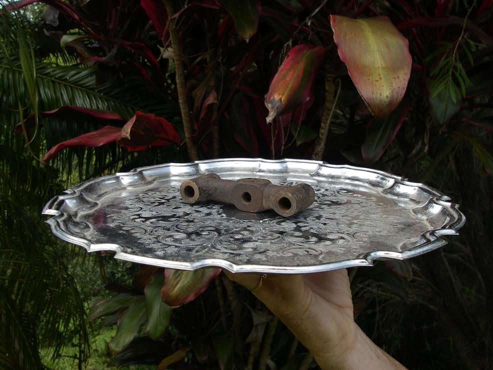

There is no pulling the wool over the eyes of Trials Tragics! Yes, it is the straightish darkish little rubbery strappy thingy between the side cover and air cleaner as so accurately described!
Below is a photo of it ready to serve after being cooked in the solar powered wok. Any ideas as to what it is??????
Re: Basket Cases KT 250 Foreign part
WAG No 1 is that it is a swinging link from a set of girder (motorcycle) forks

David, girder forks you say, makes sense to me. My thoughts were that it is old judging by the way its made, because the middle bit is turned in a lathe from squarebar, what the? Rather than machining from barstock and milling flats in a milling machine. Then the ends were oxy welded which dates it because such heavy material would be easier to electric weld. So its old or made by someone with just a lathe, drillpress and oxyset. This piece is very similar to the link with three pivot holes on a monoshock bike. However there is no provision for bearings or bushes, even a Fantic 301 has bushes! BTW, those mudguard mounts could be off a TL125 or TL250 which are both different! I know some people who are looking for some of each.

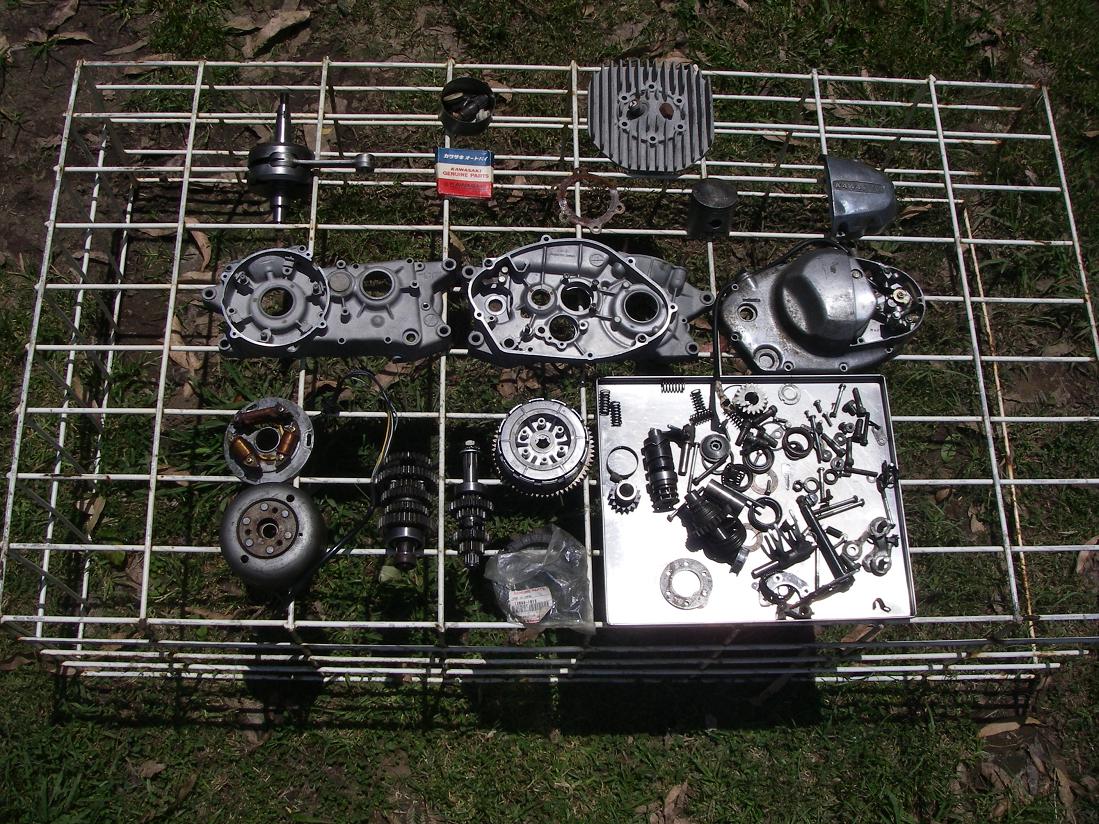

Raining in Coffs Harbour still, found enough time between showers to snap a shot of motor parts, yes it`s in pieces and now you can see what is missing! There is a foreign extra piece, can anyone identify it?

Greg I will put you out of your misery..... The silver plated item isnt as old as you may think. In fact it is good you didnt discard it, as you will need it for your KT. I had it on very good authority as to where it was used on the KT.
It happens to be the two spacers that go between the motor and the frame at the front and the two bolts go through the two large holes to secure the motor.
Someone in its past life has welded that piece in between to strengthen/secure it maybe.

Andrew, Ah starting to make sense NOW! After looking at the two crankcase halves sitting in the frame cradle, I can now see what you mean. Knowing all too well that we males only look at the instructions when ALL else has failed! Still baffled as to why someone has added weight in this way? Below is a diagram from the spare parts manual and part number 10 (4 off) is listed as collar,engine mounting. Nice long weighty bolts almost as long as TL250 front engine bolts (perhaps this is why KT`s are almost as heavy)!

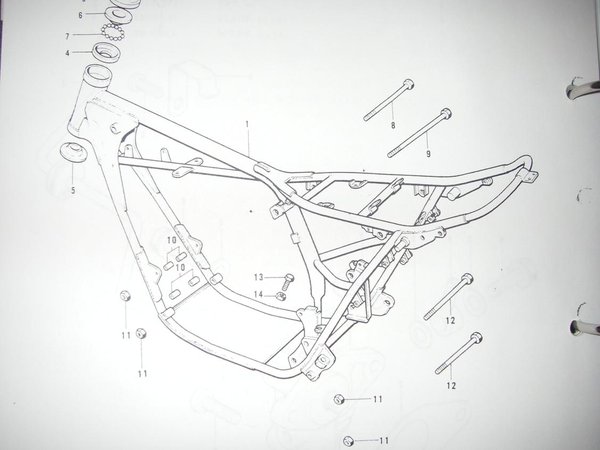

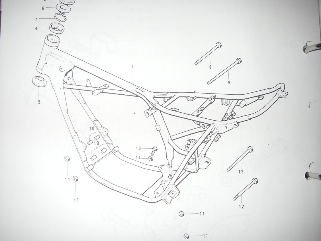

Scorps, the diagram below has revealed modifications to the frame as you suggested, it appears to have the collars welded to the frame before powdercoating. Checked the frame number and starts with KT2, but has different numbers.
The second foreign piece mixed up in the motor pieces (now I am sure it`s not KT because made in Australia on it ), can anyone identify it ?????????????????????????

Greg, I have had 4 frames come through my possession over the last few years, and all of them have the spacers on the right hand side welded on, ie, they have all had only 2 loose engine mounts.
Having said that, all my frames are KT2, so maybe the older frames have this set up.
Maybe a sidecar mounting modification.
Scorps, the frame diagram above is from the KT250-A parts book, which I assume predates KT2.
PA, A sidecar mount you say, hadn`t thought about that but it makes sense. Interesting to note that a South Australian picked that up! Is it true that 2011 Aussie Titles will have three classes for Sidecars?
Still no takers for the second foreign piece in the motor parts photo? It`s pretty obvious when you look, not looking good for someone to solve it this year!
