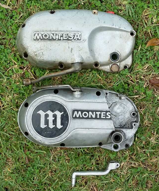

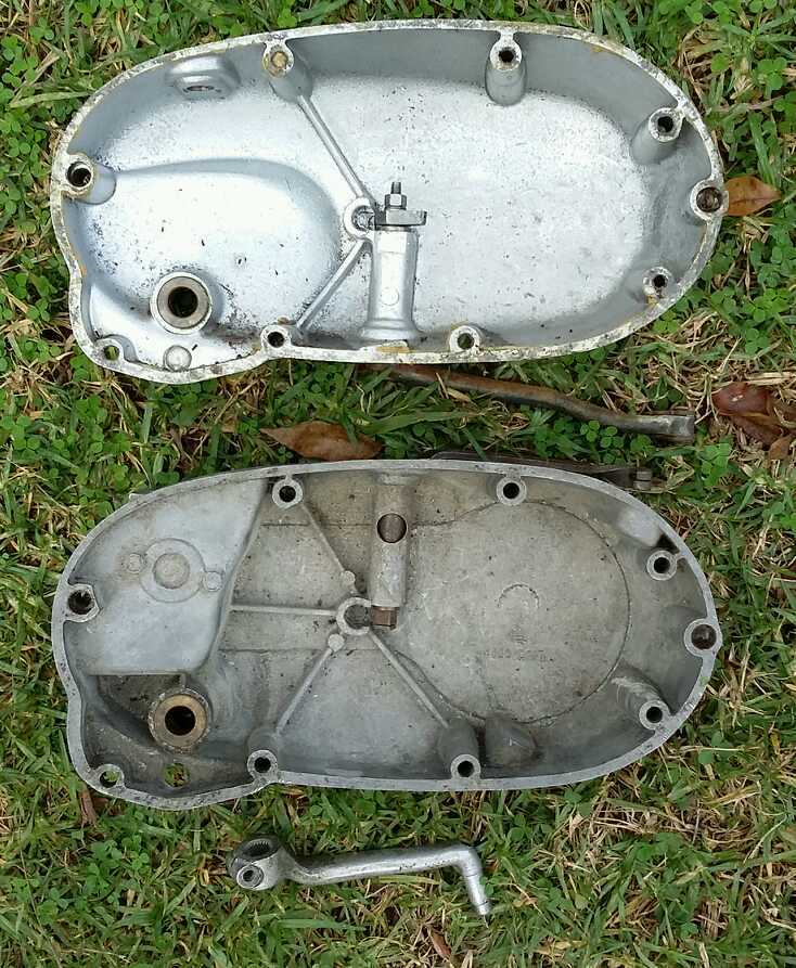

Firstly I would like to thank Trevor who has been swapping some :montesa 247 parts with me, the clutch cover, arm and gear lever has turned Up! Other than the motor, pretty much the rest of the 247 is surplus to my Needs!

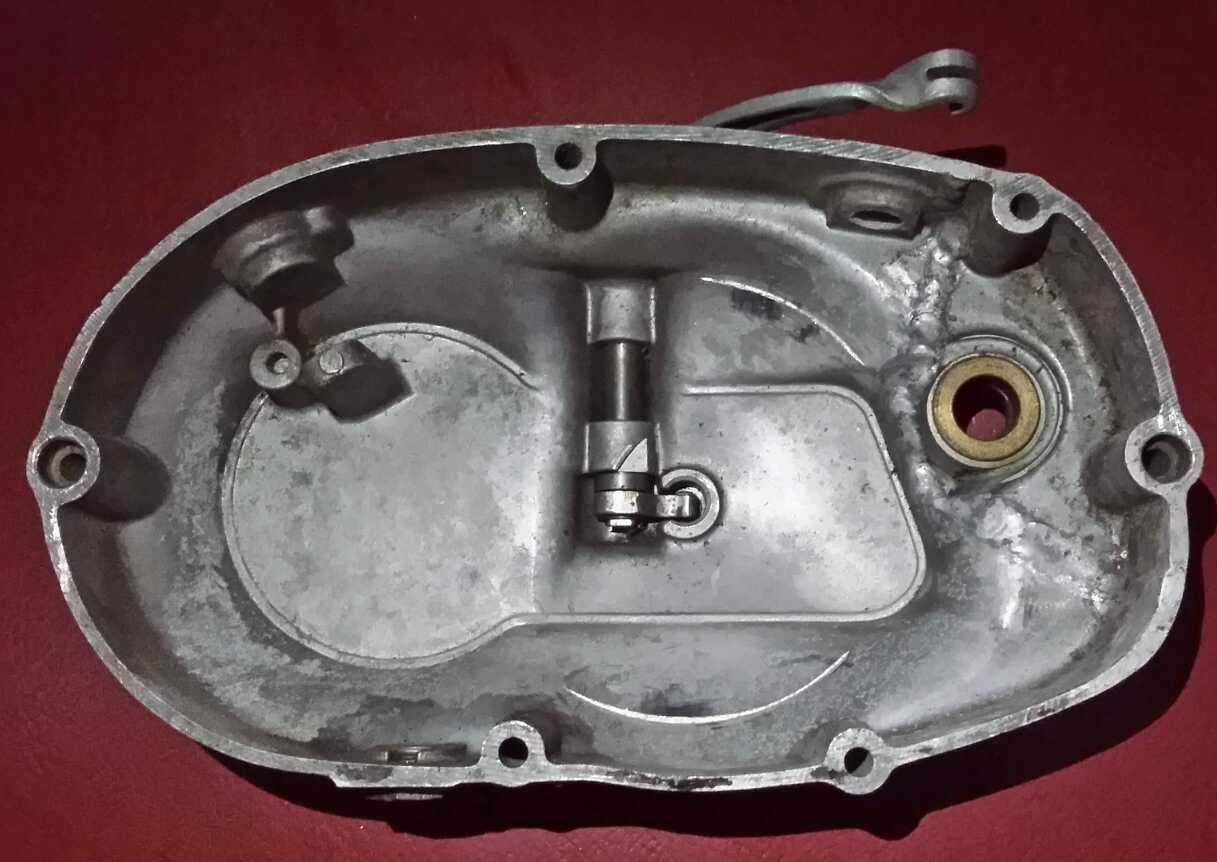

Secondly I had better explain my plan, that is to fit a :montesa 247 motor into my :montesa 242 and I will pick a random reason: the kickstart mechanism does NOT Work! One of the stumbling blocks is the :montesa 242 does not have a frame cradle under the motor and I think having a clutch arm under the motor makes no sense so I want to convert it to clutch arm on top as per 1976 I think onwards models, mine is 1974. So now I have the later model clutch cover, arm and gear lever to compare I now realize I will also need the later model gear selector shaft/spline as it is longer.
Plus the "A" is missing in the form of the extra cover for a proposed oil pump, does anyone have one I could borrow to use as a plug to get one sand Cast?
Also I am liking the BIG "M" look and would like to get the matching magneto cover, anyone know where I can get One? A complete later model motor or bike in any condition would solve a lot of problems, HELP!

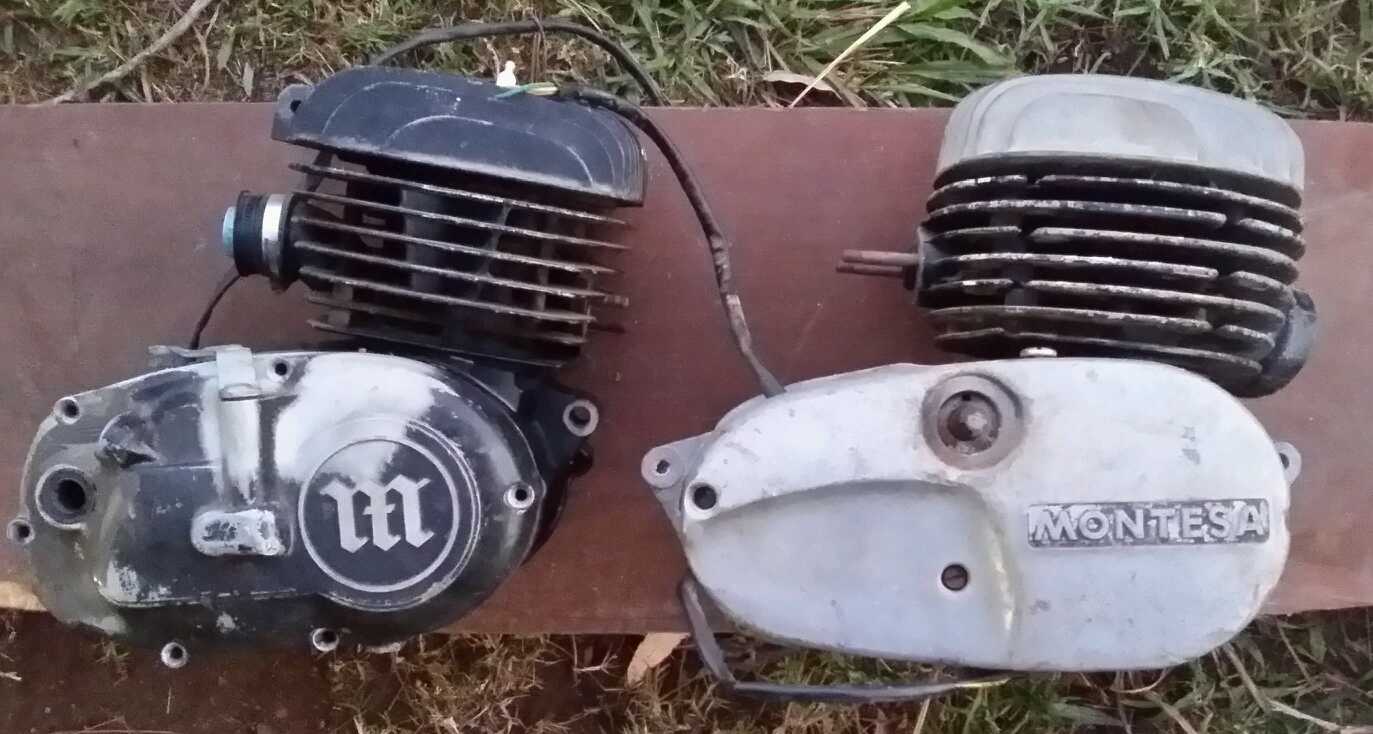

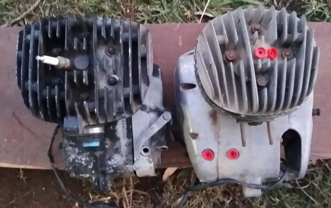

Just sharing an update on the :montesa , I had another look today and measured a few things, scratched my head and pondered for a while but no real progress. Here are some photos of :montesa 242 and :montesa 247 motors:
Surprisingly both motors have same capacity, bore, stroke and con rod. Plus you can see an evolution from 1974 to 1985 with some things making sense.
Greg what evolution can you see between the 247 and 242?
Re: Basket Cases Montesa Madness
David Lahey wrote: Greg what evolution can you see between the 247 and 242?
David, I like the big "M" :D :montesa :D
There is better insulation from the cylinder................................................................................................................................
BUT
I did not get a carby to test if it is better :!:
The clutch lever is on top allowing better access......................................................................................................................
BUT
I can't start it to check for feel or action :!:
There are more than 3 screws holding the cover that houses the kickstart............................................................................
BUT
it did not stop it from breaking free :!:
The kickstart lever is closer to the ground making it easier to reach.......................................................................................
BUT
I think they all ended up on the ground :!: :twisted: :twisted: :twisted:
