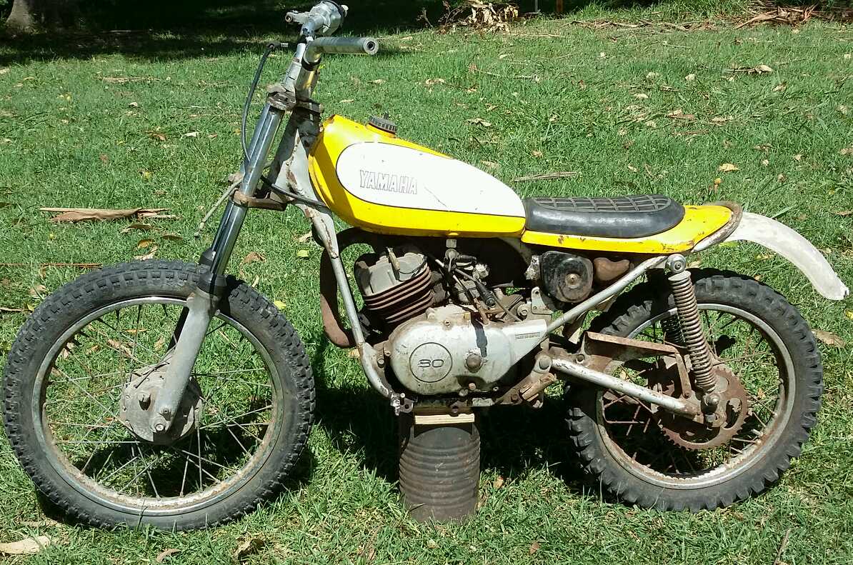

Nice work David! Christmas has revealed a bit if a TY Challenge for me:
A big thank you to the middleman in Team Boniface for being an excellent middle man. There is a few wrong parts, some bits missing and at some time must have been a Yellow Submarine as there was water in motor, gearbox and carby. Can Anyone help us with parts as we have been looking for a :yamaha TY 80 for a loan bike to fill in the gap between full size bikes and the :Honda: z 50:

Re: Basket Cases TY 80 frame straightening
Posted: Sun Jan 08, 2017 9:49 pm
Stu, you won't be disappointed with the TY Challenge!
As for my TY Challenge, I have spent a little time on it lately, removed the motor and worked out how to straighten the frame which must have had a fairly big collision with something Solid! Interesting how the frame has bent and forks are Straight!
The motor came out easily so the motor has held the frame in shape and limited the damage to just behind the gussets.
Framework to hold engine mounts and something for the Porta Power to push against to reverse the damage.
This is back to the standard dimensions and luckily all went well as there is no twist and motor bolted back in easily for now.

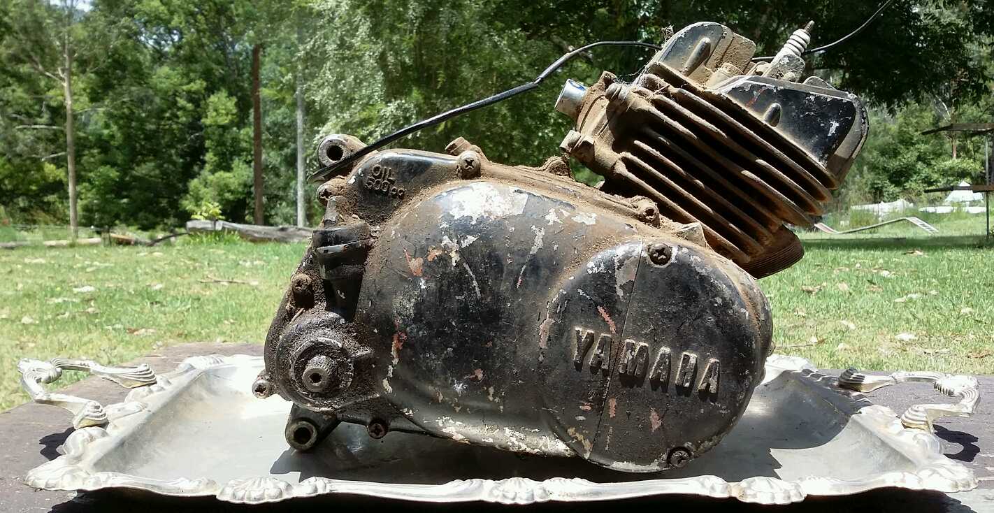

Re: Basket Cases TY 80 motor
Posted: Sat Jan 14, 2017 1:58 pm
In breaking news, I have scored another TY 80A motor (451 0XXXXXX)! Well actually I have had it for over a week and pulled it apart for it's first time ever and I didn't break anything! The crank feels good and the standard piston has minimal wear so it will be new bearings and seals, basically everything into the matching number cases and it will be a little closer to getting it going.
Still chasing the missing parts (see photos) if anyone can Help?
Now that I have been talking about it not being broken for a paragraph, I suppose it is no longer news and definitely not breaking news really?
