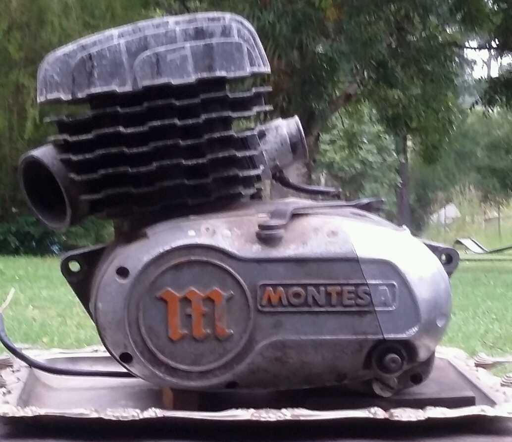

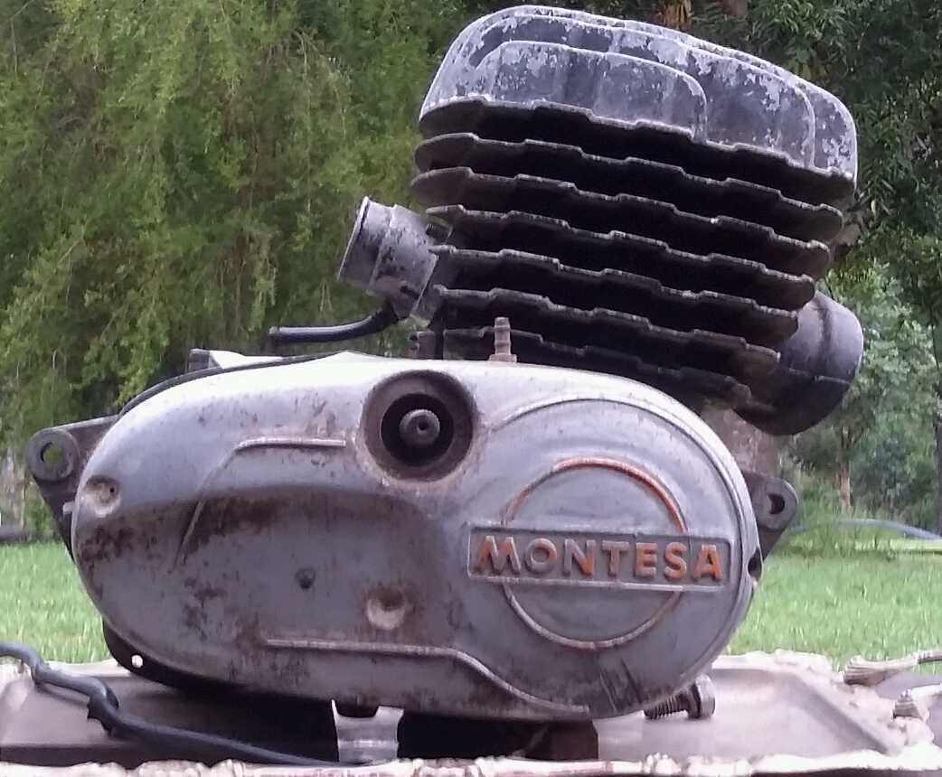

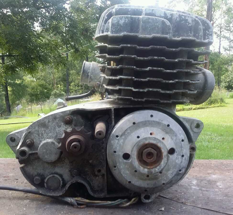

While we are talking :montesa , I had been hearing about a lonely crinkle finned :montesa motor in the boot of a car for over a year but the owner could not find it. Had all but given up hope of ever seeing it until Montyman sent me a photo, apparently it was in the back of a van. This is all that I got and the bottom end is surplus if anyone is Interested?
The prefix is 44M so all of you Monty fanatics will know it is a King Scorpion auto lube motor from mid 70s. At 246 cc and my first choice of engine size being 250. I am now thinking that I will make a better top end for my 247 powered 242. The cylinder studs are 10 mm instead of 8 mm (easy fix) and are on the same centre's making for an easier transplant than the 242 top end. Which meant boring the cases and relocating all of the studs. Here are some photos of the pre assembly:

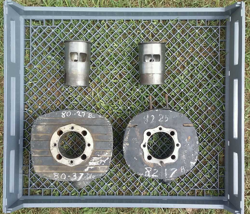

Just sharing an update on where I am up to and wondering if anyone can Help? The crinkly fin :montesa 44M cylinder slides straight on to 247 bottom end but is 7 mm higher than 247 so we have pressed the sleeves out. Now we are looking at boring the crinkly fin cylinder to take the 247 sleeve and reducing the deck height to match. What I am unsure about is the port timing and should we take material off both top and base of Cylinder?
The transfer ports are about 4 mm wider front to back and I can match port the cases to the new cylinder.
44M sleeve on left, 247 on right, the exhaust ports are a similar size in both cylinders and sleeves so I am wondering if we should simply adjust the heights to align the exhaust Tract? All the other ports will be determined by the 247 sleeve which matches the stroke or am I thinking about this all Wrong?

So you are putting the right side sleeve into the barrell on the left?
Why?
Getting the sleeve back to it's original height is important for the timing , getting the ports to match will be impossible with the crickly cylinder having much greater port heights. It will still run as the sleeve controls the timing. 7mm would normaly come of the bottom if there is enough meet there.

Yes George, I am considering the 247 sleeve on the right into the crinkly finned cylinder on the left. Here is a sketch and approximate dimensions of the ports inside the cylinders with sleeves removed:
There are a few differences mainly in the transfer duct only having 3 sides in the crinkly one using the sleeve for the 4th side. Now that I have thought about it a little more I am now thinking 2 mm off the top and 5 mm off the bottom and clean up the mismatch after sleeve goes back In? The castings are substancial and removing the material does not worry me. As you say, the sleeve controls the timing and I am not after ultimate performance but would like to keep the 247 power characteristics. Do you think these changes will be detrimental to power for Trials Use?
