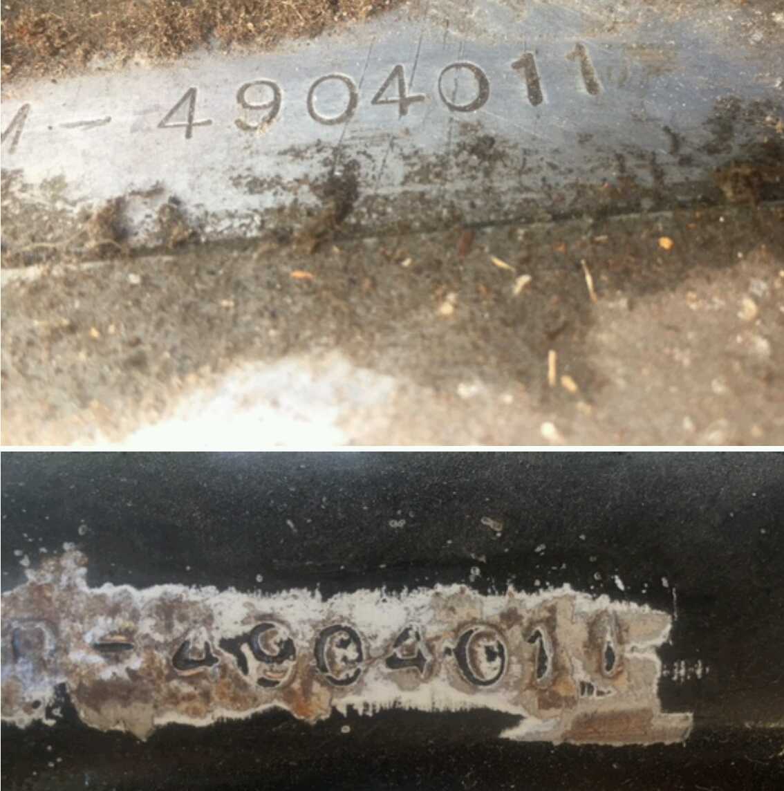

For about 5 and a half years now, my incomplete :Bultaco: M49 has been sitting on the back burner again until this week when :Bultaco: M49 no 2 turned up. A little rough and not all there but the motor runs really well with good compression and no play in the mains, Happy Days! My first thoughts were donor motor for my rolling frame until I saw the frame and engine number, last 3 digits in particular and it must have been close to to newer M80 Sherpa T?

That VIN probably still fits in the 1968-70 criteria so what is the problem?

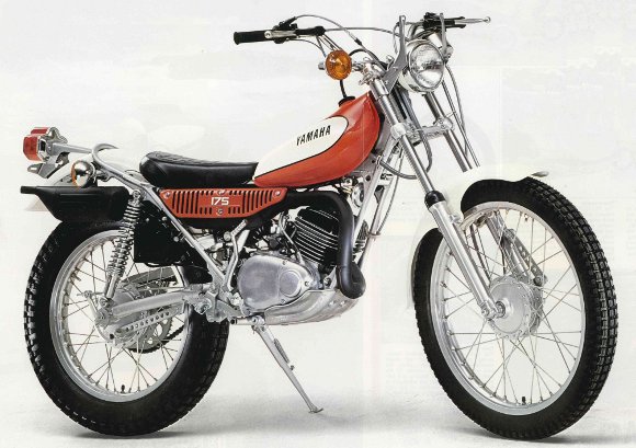

Hi Outforfun. As far as I can remember the TY 175 C`s had a black barrel with a alloy head on them I think. The engines were silver or unpolished aluminium alloy with a clear coat over them. The same for the fork bottoms. David is the TY expert on here though so wait for his answer before doing anything. Graham.
I know this is a TY175JC brochure but am pretty sure the cylinder and head on these were painted the same as TY175C. If anyone has a TY175C brochure please post it up.
As you can see, the TY175B brochure photo shows a slightly a different paint scheme on the cylinder compared to the C and JC
Some later model TY175 and TY125 came with black painted motor casings but the B and C and JC were all as-cast inner casings and clear lacquer coated outer cases

David, no problem really, I was just curious how high the numbers went for a M49? I can't see any evidence of a Kit De Campeon ever being fitted but I think it was only an option that you could fit yourself until the M80 came out?

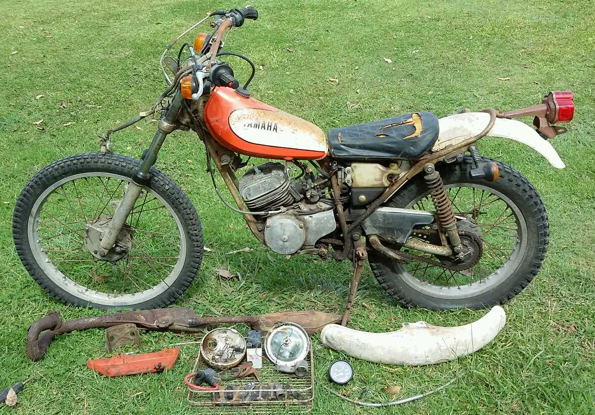

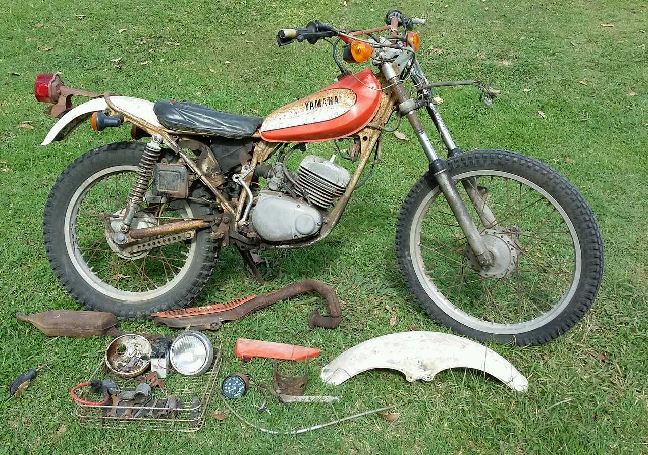

Don, funny how we have been doing almost the same thing. About the time that cyclone Debbie was causing destruction up your way, I received a call from a bloke wanting to sell a TY 175. His description of a 1975 B model was a little out but close enough for me. It came with a warning that the river he lived near had been predicted to flood and if it went over the levy, underneath his house where the bike was would Flood! Armed with his address and number I called a mate that lived fairly close and it seemed like he dropped everything and went on the mission. Apparently Pete drove through flood waters on the property to pick it up and the River rose to way over where the bike was later that night. Thanks Pete, I owe you big time. Anyway now that I have picked it up, here are some photos:

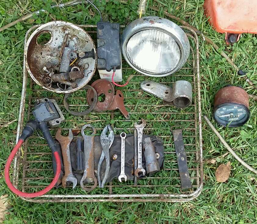

Yes it is a 1/77 JC and I think it will go, I checked in the toolbox and I found most of the original tools.
As for your question about engine colors, I think aluminum finish for the bottom end and black cylinder and head without polished edges.
Now for my questions, can you snap some photos of the blinkers as I think my ones are wrong?
Is the tail light right for a JC as it lines up with mudguard and underbracket holes?
Should the headlight have the chrome bars like yours on a JC?
Is the plastic infill in the chain guard right for a JC as it is different to my JE One?
Greg, I just looked up Historia de la Sherpa T and have part of the answer. The M49 frame change (to the frame you have which is structurally the same as M80) happened at 4902426
Wow that looks very complete Greg. The taillight, battery box and speedo are so often missing from JCs. Looks to me like someone used it for commuting (based on the undented tank and exhaust, tiny rear sprocket, worn down road-trail tyres and that they have fitted other blinkers to replace the originals)
The plastic bit that extends the chain guide is not standard from Yamaha Japan, but may have been fitted pre-sale to satisfy NSW rego requirements. I've also seen some (NSW TYs) with longer chain guards

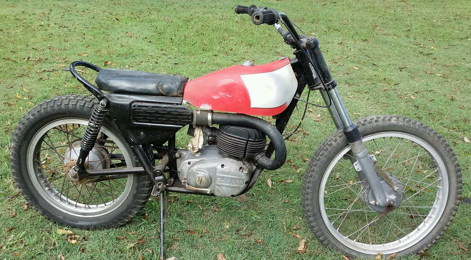

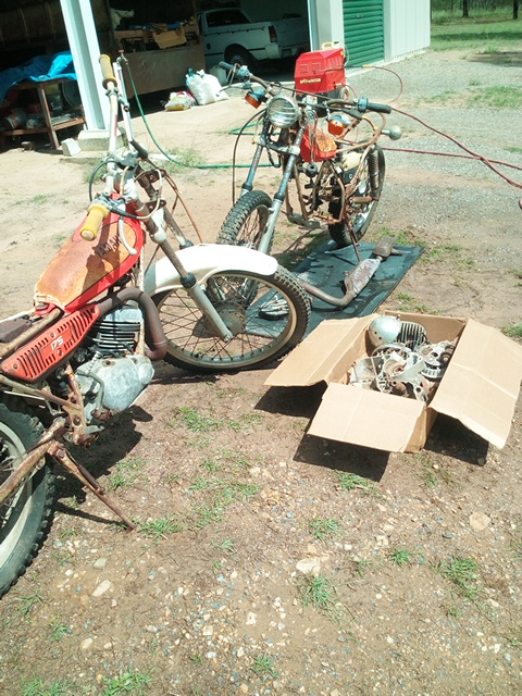

Yes I have been buying bikes, here is another one
Different I know but it's similar to the other one
So I am sharing these photos for you all to see
