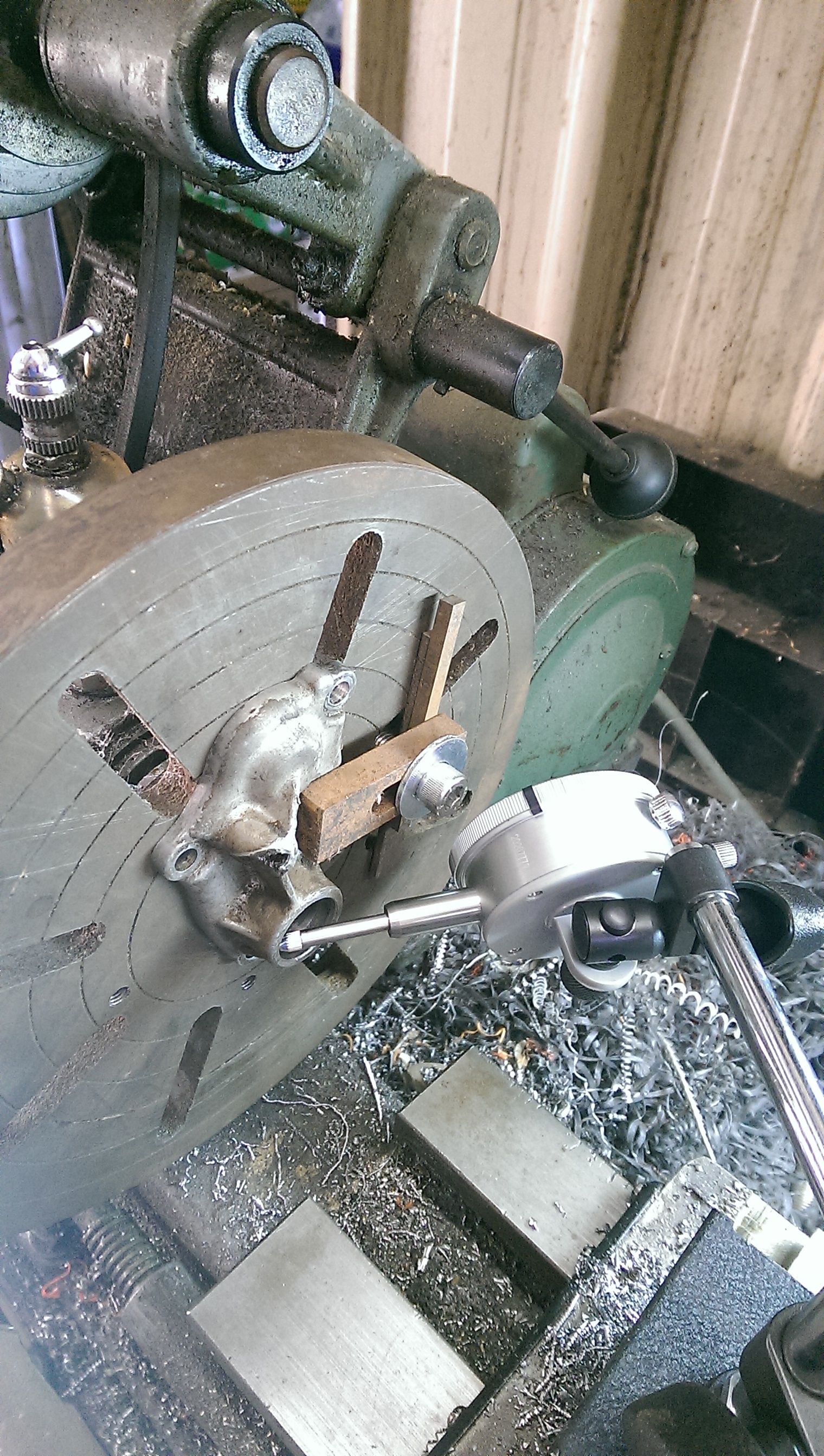

TY175 wobbly shifter shaft

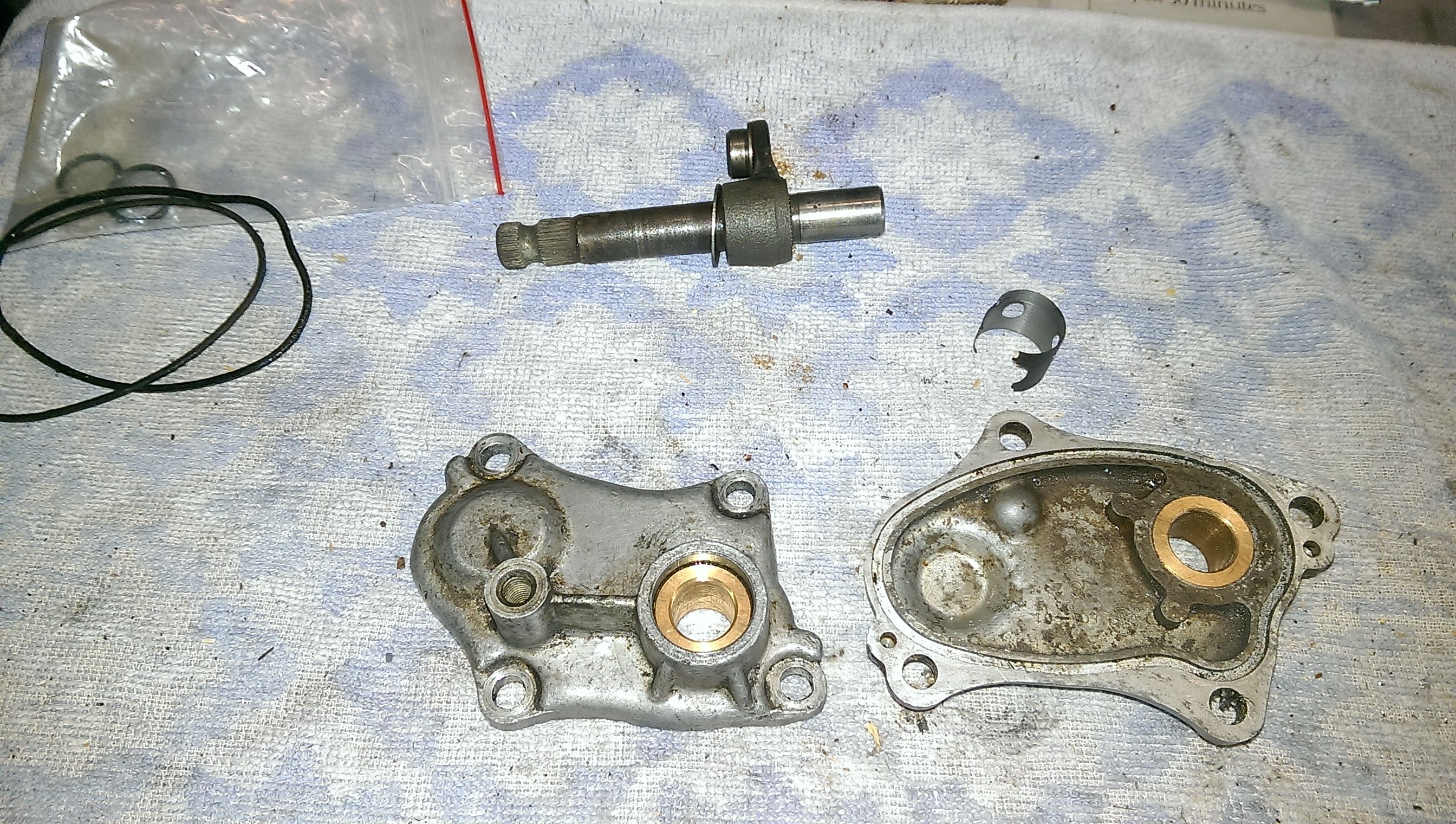

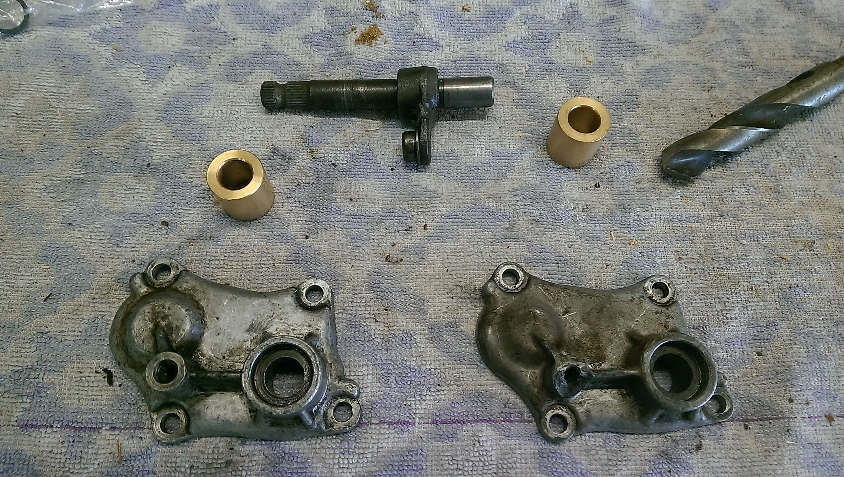

A feature of many TY175 motors is the sloppy wobbly gearshift shaft. Today I had a soul-food workshop session re-bushing a couple of them.
The standard aluminium cover has a cast-in cast-iron bush and a lip seal. These covers had the cast iron bushes bored out and replaced with brass bushes.

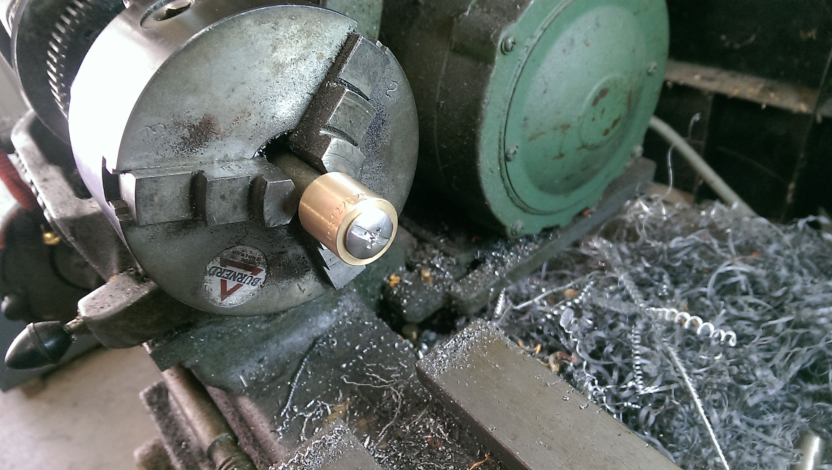

I machined the OD of the bushes on an arbour so I could be sure that the shifter hole would be coaxial with the OD.
I machined the holes in the covers using a face plate because I don't have a 4 jaw chuck.
The new bushes are a push fit in the covers.
I made the new bushes the same length as the old ones so there is space to fit lip seals.
A remnant of one of the cast iron bushes can be seen in the last photo.

That looks good David. I just bought one of those magnetic dial gauge holders with a dial gauge last Thursday. Now I know another way I can use it. Graham.
