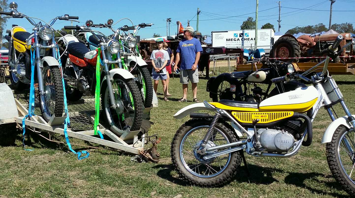

Just sharing some photos from this weekend, we decided to mix it up his year with a mini bike theme and only one Trials bike.
:honda: z50, :honda: MR 50, :yamaha TY 80, :honda: ATC 70, :honda: CT 70 and :suzuki RV 90 lurking in the background.
However there was a :yamaha TY Fanatic with some beautiful examples, all of the bikes on the trailer had club Rego. :yamaha TY 250A,The middle one is a :yamaha TY 175 C and not a JC! :yamaha TY 250D and :yamaha TY 80 in foreground.
Did I mention we mixed it up?

Posted: Mon Sep 04, 2017 8:47 pm
by billy
[mod=PA]Warning. The following picture contains a front mudguard mounted backwards.[/mod]
Re: Rusty Iron Rally
I'm not so sure your pic is a TY250D. They didn't have the blue body work behind the seat.
Posted: Tue Sep 05, 2017 7:03 am
billy wrote:I'm not so sure your pic is a TY250D. They didn't have the blue body work behind the seat.
Billy, you are right, they are more like a TY 175 seat. Mika and I were discussing his bikes and he asked me if I had the right seat, his seat was in excellent condition and would probably swap if anyone had the right seat. I told him I have a TY 250 C with the same dilemma and there was a TY 250 D for sale recently with A/B base painted blue. It seems a lot more :yamaha A and B models were sold making them easier to find?

Posted: Tue Sep 05, 2017 4:06 pm
Arrrrrghhh PA it's too late I saw it and now can't un-see it
Posted: Tue Sep 05, 2017 4:13 pm
Not only rarer because of there being not as many sold, but the steel C/D seat bases also rust, crack and fall apart quite rapidly. I think it was someone in Victoria made some new seat bases for C/D models using fibreglass a while back ( I know this because they used my D model seat base to make the mould from). I can't remember who it was though.
Posted: Tue Sep 05, 2017 5:16 pm
by billy
billy wrote:[mod=PA]Warning. The following picture contains a front mudguard mounted backwards.[/mod]
PA could be right.
TY250 owners - CHECK your front mudguard
