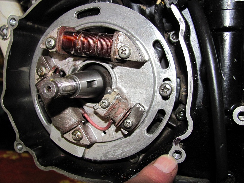

OK update on progress. Most work done and only remains to sort timing out, as previously stated the IT crank keyway is at 5 oclock position when piston TDC so that's where coil needs to be. The coil pictured (thats the supply coil, not the trigger at 4.4 ohms) was actually a poor scrap coil with only some 170 ohms impeadence rather than 250 ohm at it should, so this pictured coil was changed. Anyway got it going with no bother ......... and what a difference !!!!!
Certainly revs cleaner and the pick up is instant (well more instant than standard) and there is very little over-run on a closed throttle, the standard motor does take ages to decelerate so response is much much quicker. One point I did fall 'dummy' to was the odd noise the motor was making, I thought was a rough clutch bearing as it would 'whine' quite loudly. Turned out to be lack of barrel fin dampers, those bits of rubber that prevent the alloy fins from 'ringing', fitted 5 new dampers and now super quite. Still need to replace the standard steel reed valve petals with composite type petals to give it more umph!!
Have yet to ride it in a trial but work once again spoils an otherwise promising trials career !!!
Whats it cost ?? Well crank & flywheel from eBay (USA) cost some $80 (USA), new mains, gaskets and consumables cost about $55 (USA) big dollar item was Birkett 70mm Wiseco forged piston this was about $275 (USA) plus the re-bore costs $75 (USA) so actual spend up-front was $485 (USA) so approx 325 GBP! Hidden costs were parts laying about in chicken shed and in cellar plus my lathe work.
Anyway it is possible to make a super smooth short-stroke motor for a Pinky Mono just using an IT250 crank-shaft .... just make sure you buy the flywheel and ignition stator back-plate while you is at it !!
More later when I have ridden it.

Hi there late night stalker .... latest 'blog' offering. For those interested, I rode first trial last weekend but with timing a mile out. Referring back to photo above, I now run with stator back plate in next slot up with trigger coil virtually at 5 oclock position, ie more advanced. It now certainly lives and revs like a modern bike with the power more instant. I added some fibre 2-stage Kevlar reeds to the inlet, those stainless reed petals are pants and kill the intake velocity making for slow response.
So as a tuning method and exercise I can fully recommend the short stroke option to improve your mono. Birketts piston mod was most difficult to overcome with it being necessary to machine head down to put combustion chamber some 8mm further down the bore (giving me back 7mm squish). Second most difficult was to machine barrel base down some 4mm in order to get everything back in place a BDC.
Thereafter it was a case of just making everything fit proper. Extras I do are always personal like the stainless exhaust seen on eBay, use very light gearbox oil (30 grade), fibre reed petals and open up the airbox lid to aide breathing.
Still has all those virtues of the mono, good chassis, Jap quality in engine build quality and 1/2 decent chassis.
