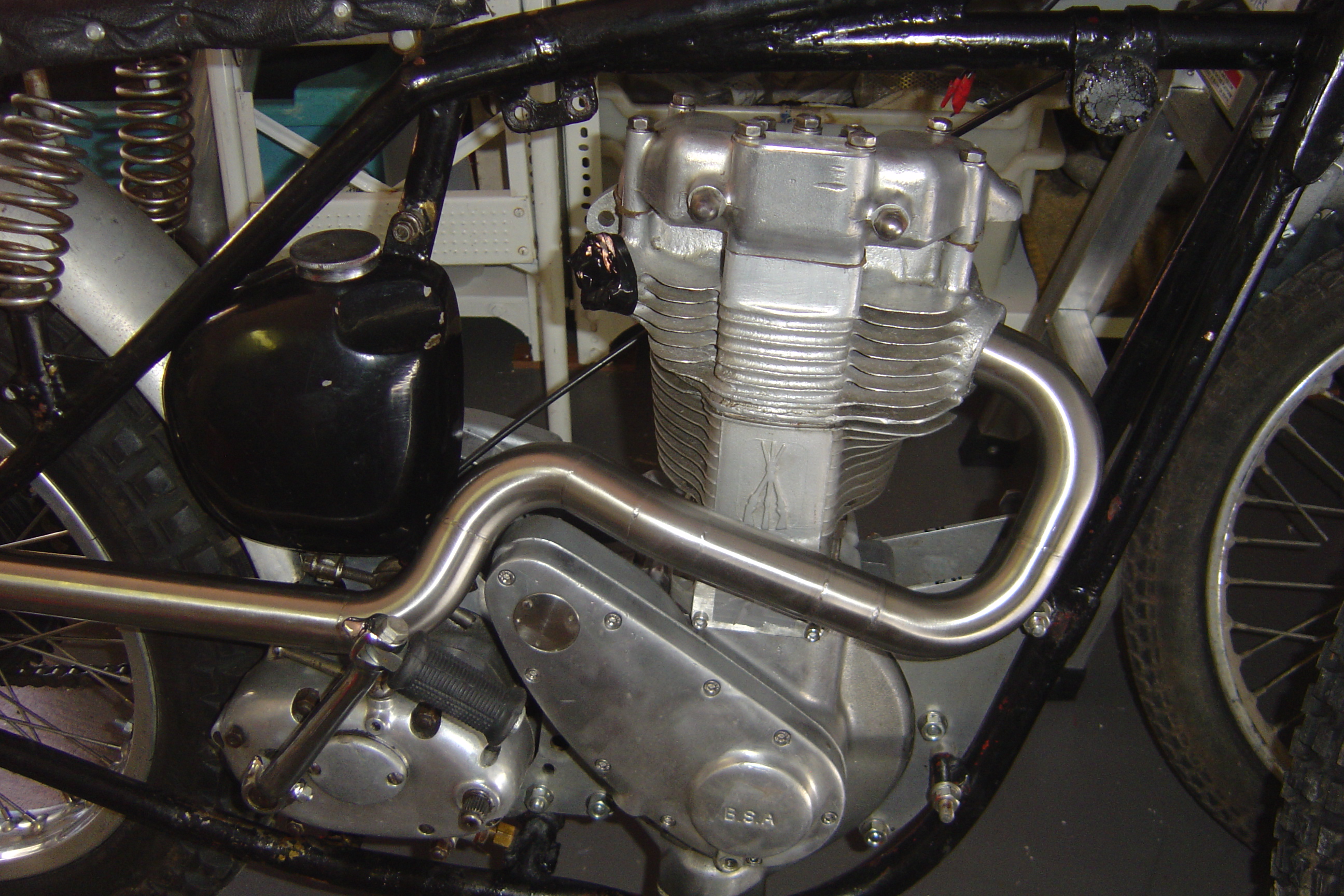

by Twinshock200
OK, I'll let you have the bottle of champers through the post Jon, you hit on the cast iron rockers, its also a cast iron head and barrel which means its not a Goldie motor therefore I cannot build it into a 350cc Goldie with that motor......
Which leads me to an interesting story.... The bike was built by my brother many years ago and when he passed away in 1988 I bought it off my sister in law and exported it here. I kept it for many years without using it and eventually sold it.
It was sold again later on but I always knew where it was, but its ZB32 Gold star motor was used in another project and I eventually bought it back about 3 years ago with this ZB31 cast iron motor.
At the time I was backwards and forwards to the UK so I started looking for a genuine Goldie motor and found one after months of searching at Alan Wrights Telford show. The owner lived in Ireland and the engine was too expensive to buy on the spot so it went back to Ireland. We did a deal on the price and his son took it over to the Pre 65 event in Scotland and we picked it up from there.
After that it ended up in a shipment over to Australia and is now firmly bolted into the bike, see pic.
Notice the difference with the push rod tower, on the alloy Goldie motors it was cast into the head and barrel and not a separate push rod tube.
Thanks for the suggestions especially "going fishing" and "not wanting to ride a rigid",,,,, but I'll persevere till I get it going again.
