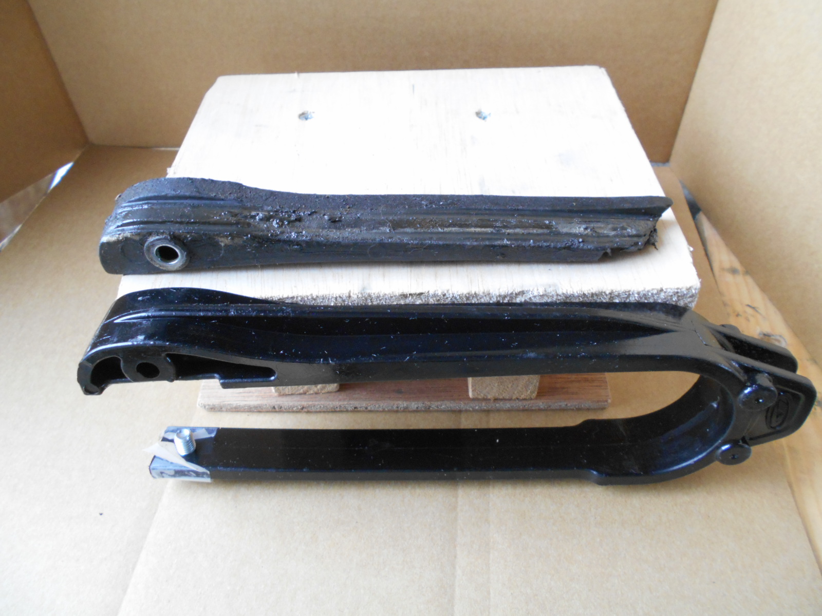

I am replacing broken block with new one.
I took a picture of old and new block as shown on attached.
Pre-owner seemed to give up replace wasted parts.

Chain slide block

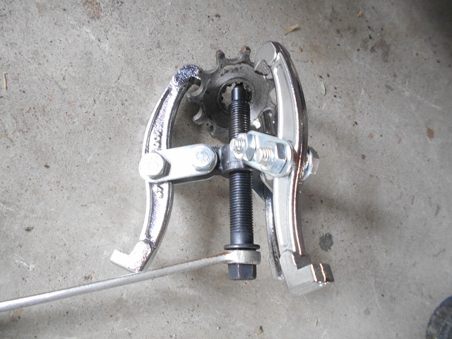

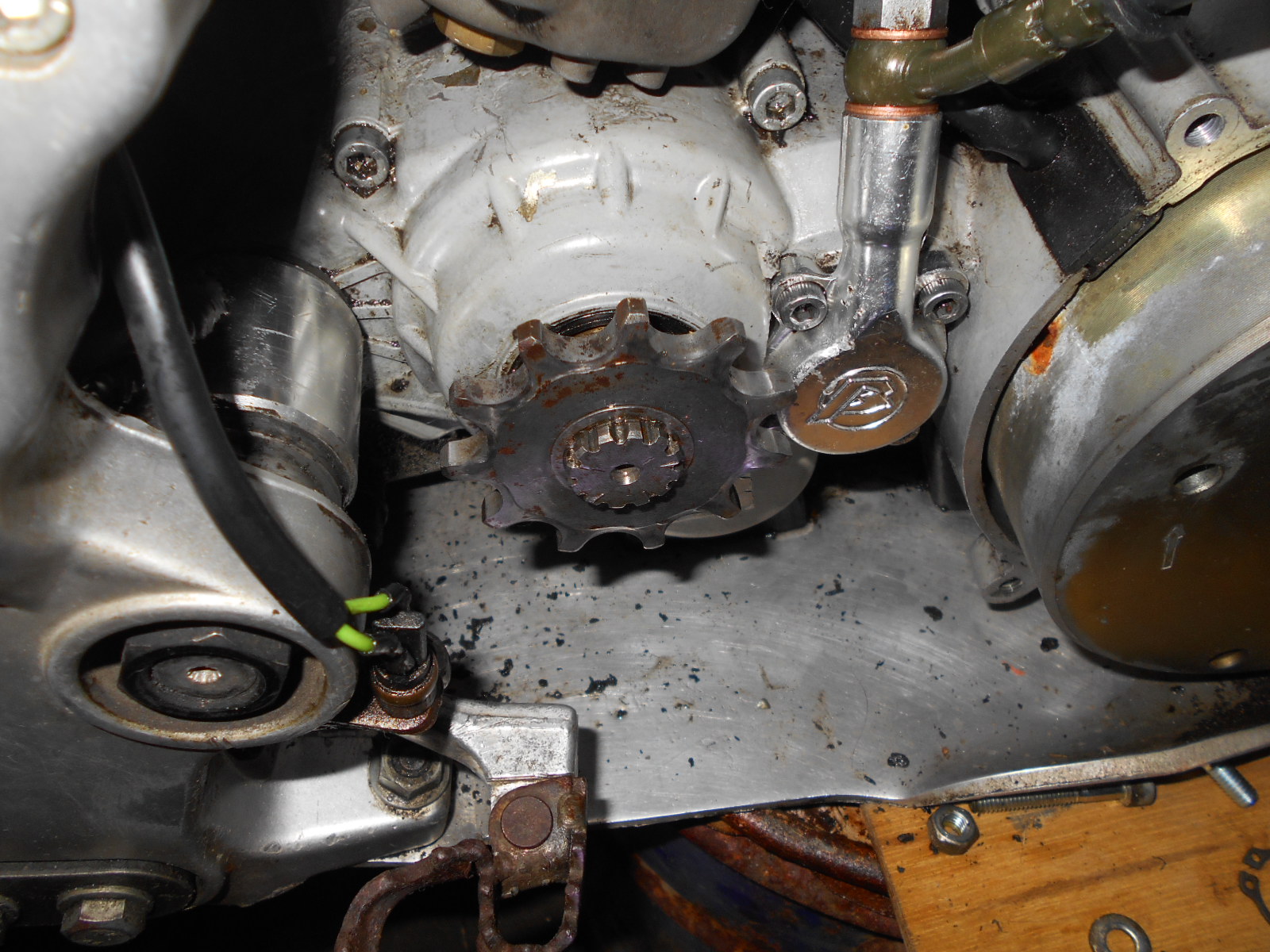

Front sprocket has to be removed when replacing chain slide block.
I tried to remove sprocket but could not.
Sprocket stuck on spline stiff. I am going to find good way to remove sprocket.
Then,I have decided to buy a 3jaws bearing puller to remove sprocket.

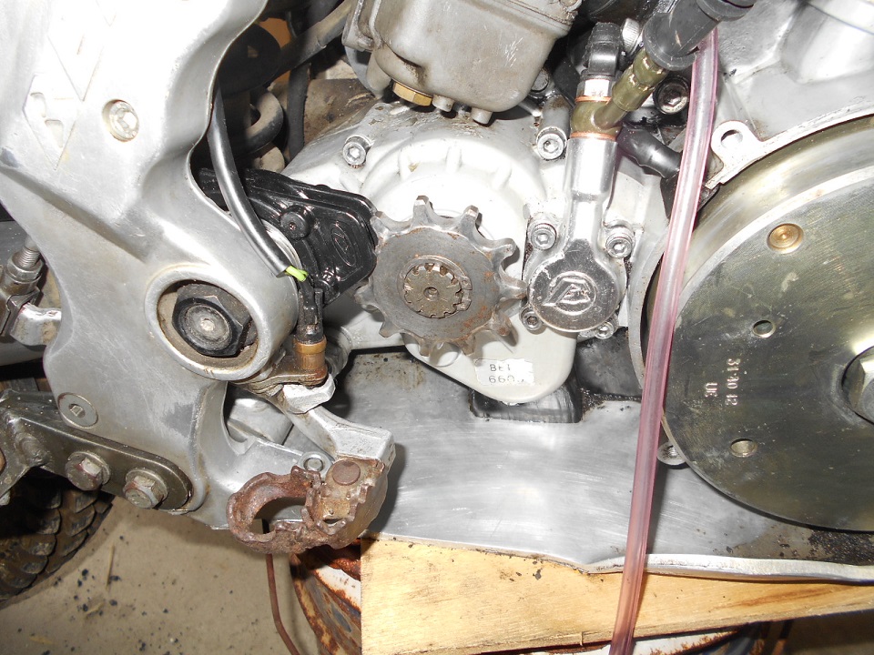

I could remove sprocket with bearing puller. So I installed chain slide block.

Good job. Better than pulling the swing arm out to do it.

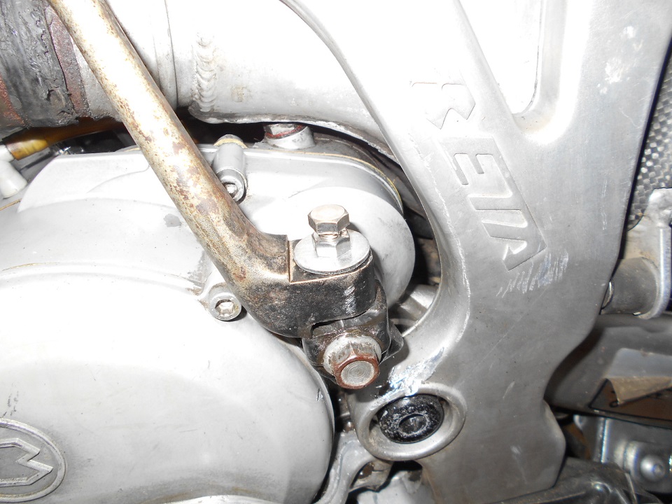

kickstart lever

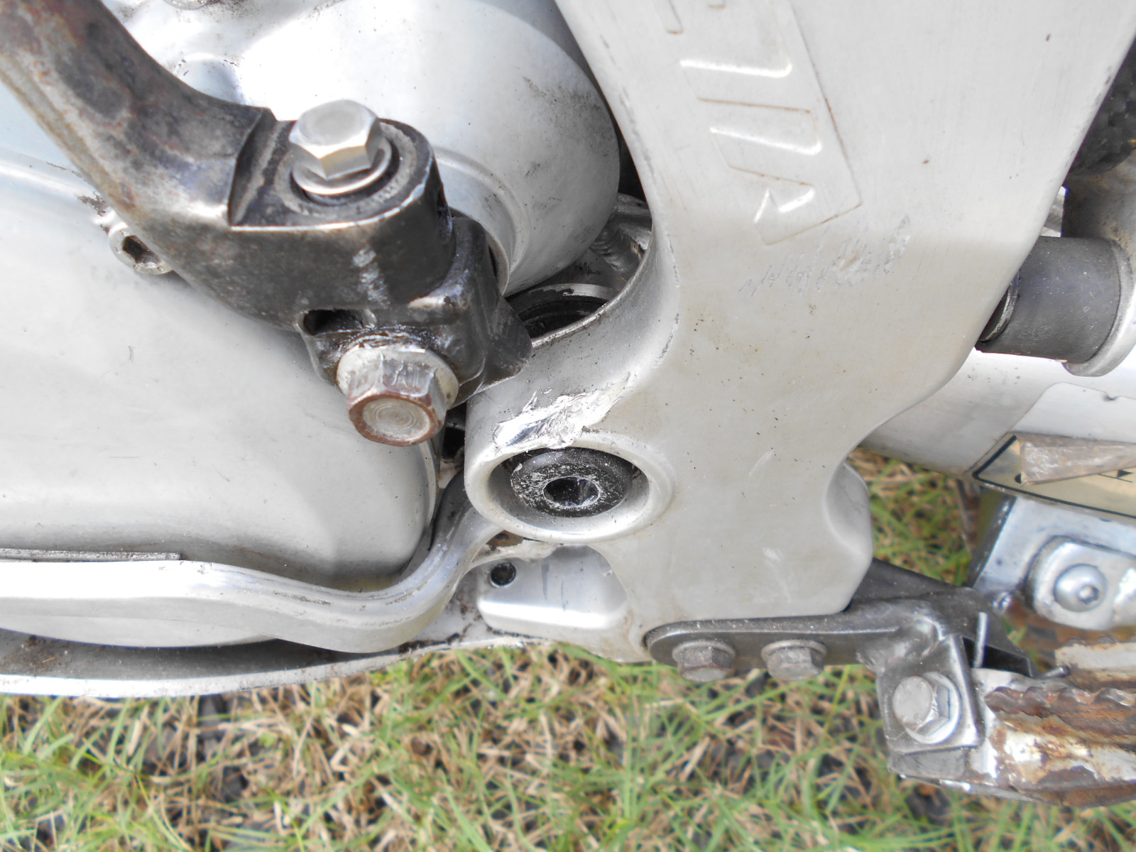

As I replaced leaking fuel cock with new one,I tried to kick start again.
Unfortunately loose arm hit the frame and frame was damaged as shown attached photo.
I know best way buying REV3's kickstart lever.
And I am thinking another way to fix.
- DSCN9467.JPG (475.28 KiB) Viewed 26414 times
ito
- Posts: 29
- Joined: Sun Aug 07, 2016 4:19 pm
- Bike: Beta Techno 1994
- Location: Aichi, Japan
kickstart lever bolt
Loose kickstart lever hit frame,so I put longer bolt with nut as shown attached. I hope it will work not to hit frame.
- DSCN9471.JPG (250.63 KiB) Viewed 25623 times

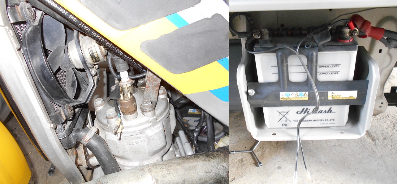

I have got another problem in cooling system.
I started engine and several minutes later,
boiling noise came from radiator. But coolant fan did not work.
I thought thermostat wrong.
I removed wire harness from thermostat and I connect it to car battery.
The coolant fan work properly. It turned out to be wrong in thermostat.

If the fan changes direction when you change the polarity/tweak positive-negative, then what you can do is set it so the air is pulled from the front of the bike towards the rear (that is from forks to engine)

You can bypass the thermostat by joining the two terminals. This would make the fan run all the time which you may not want when it's cold.

I used a tissue in front of the Radiator.
Sticks, its turning the correct way.
