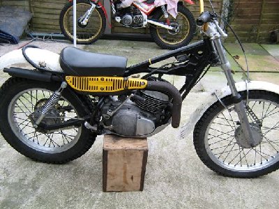

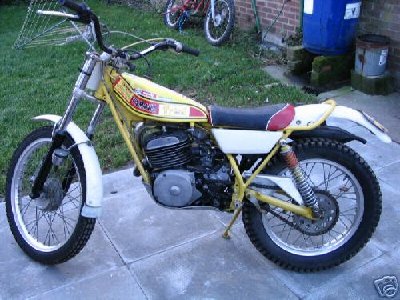

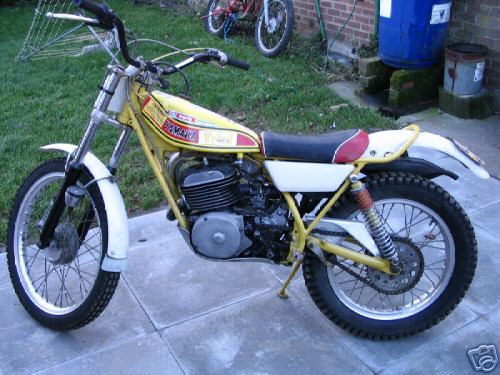

This is what the first series of Majesty 250/320 looked like. This is the series that used a modified Yamaha TY250 frame. The Yellow one is a recent photo of an unrestored 320 and the B&W photo is from a magazine test from the late 1970s.
The main benefits of the modifications to the Yamaha frame by John Shirt are that clearance under the motor is greater and rear wheel travel is increased
The mods included:
Moving the front engine mounts upwards on the front frame tubes
Shortening the mid and rear frame uprights at their upper ends
Bending the mid uprights forwards to meet with the main backbone
Bending the front downtubes rearwards below the toolbox
Relocating the exhaust mount bracket lower
Relocating the airbox/inner guard mount brackets lower
Removing the top shockie mounts
Fitting gussets to the front side of the uprights
Fitting new top shockie mounts into the uprights
Modifying the horizontal frame tube behind the airbox to provide clearance for sparkplug access
Bringing the exhaust pipe closer to the head (to provide clearance to the tank)

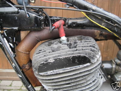

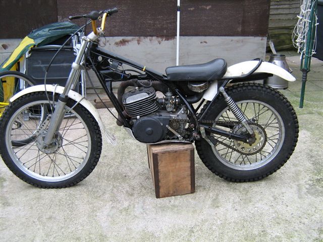

Here are a couple of photos of modified TY250s showing more detail of some Majesty-type mods. I can't tell if these mods were done in the Majesty workshop, or by someone else.
Note the one with the weird exhaust routing required that the tank be reshaped underneath for clearance.
