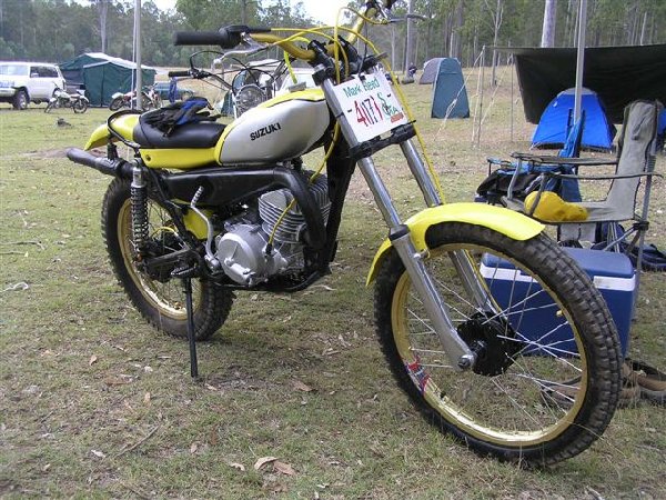

I need to know where the clutch cover came from on that RL you posted on this thread?
If it lightens my clutch I want one!

Re: Suzuki RL250 Exacta Mania
I'm no Suzuki expert but I do remember that in about 1976 or 1977 the TS250 motor (and a few other TS motors) started using a clutch cover that looked like that.

Post by Scorps »
Howdy Y'all,
Pipoca, that yellow and silver RL is my Dad's bike, the clutch cover came on the bike when we bought. The cover though, is off a 73/74/75 TM250 or a 76 TS250. Check Ebay USA there is one on there now:
http://cgi.ebay.com/ebaymotors/SUZUKI-TM-250-TM250-1974-CLUTCH-ENGINE-COVER-AHRMA-MX_W0QQcmdZViewItemQQ_trksidZp3286Q2em20Q2el1116QQhashZitem483036f5a4QQitemZ310046553508QQptZMotorcyclesQ5fPartsQ5fAccessories
If you want a lighter clutch though, just take out 3 of the clutch springs (every second one of course!). Dad's RL is running only 3 std springs and it didn't slip once during the Brooweena trial.

Thanks for the model number and the link Scorps! My original clutch cover has a patch on it. I have been searching all over for one and could only find junk on ebay. Tonight I put in TM250 and TS250 and I found about eight of the buggers. One of them is NOS. So, I have bid on two cheapies and bought one out-right off a 1972 TS250.
I have a belly full of spaghetti and a spare clutch cover on the way. I'll sleep well tonight.
