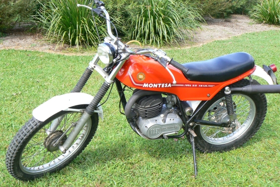

Well after all that here she is - not concourse by any means - but I bought her to ride not to look at. Fingers crossed everything currently appears to be operating as it should 8) - So I have just taken it for a ride up some serious hills and climbs and falls - hooray, it stayed together and went great :lol:
