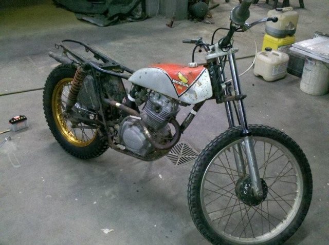

So we are almost finished. Ended up keeping it all pretty much original look except for the lights. Still need to sort out new rims and spokes and a pair of side covers and decals. But all in all I think its a pretty fitting tribute.
Original condition
Original condition
