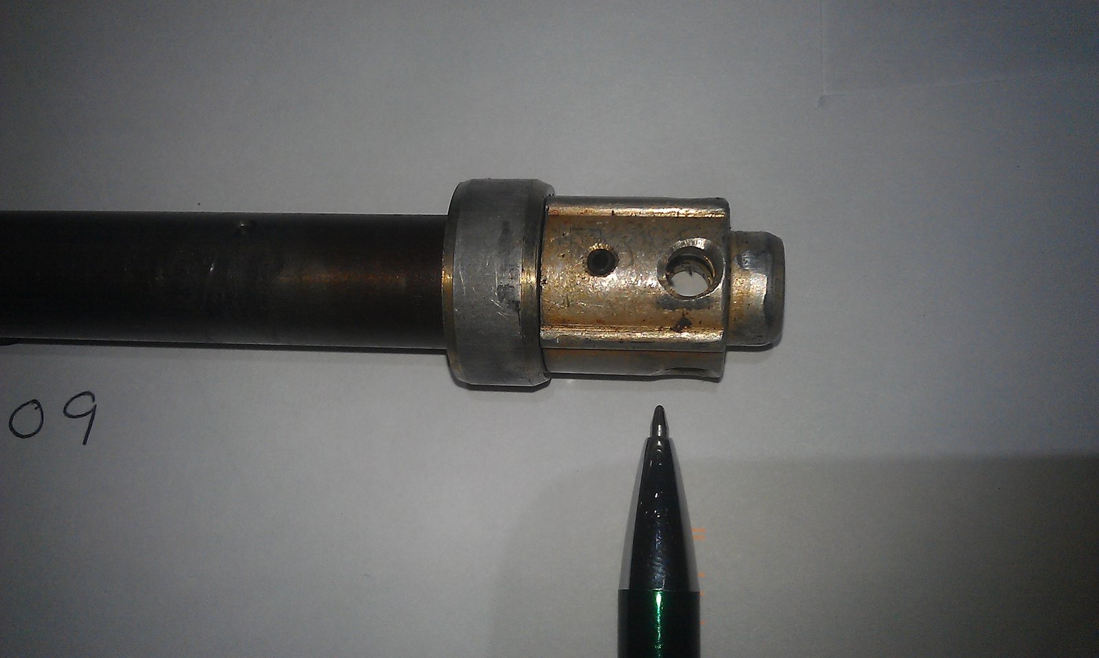

No you just have to machine enough off the end of the aluminium spring mount so that the axial hole through the middle of it is fully exposed. The amount you shorten it by is not critical because you will have to shorten the existing preload spacer anyway to end up with the same preload as before the mods. From memory I machined down to just past the radial holes, which also from memory was the same position as the end of the steel damper rod. I now wish I had taken photos while it was apart.
The photo shows a standard TY250 damper rod and the pen is pointing at where I machined down to.

Thank you David.
That sound right, I will do the machining either thid friday or the next and post picture so you can correct me or it will serve as an exemple.

I did the machining of the top of the damping rod ( I would have liked to post a picture but the file is too big ) and the lenght of the top from the circlip up is .965 inch. I also drilled the holes on the buttom of the rod. I should reassemble the fork this week or the other, but I don't think I will be able to test it soon, it' MINUS 11 cel. this morning and maybe snow this week.
