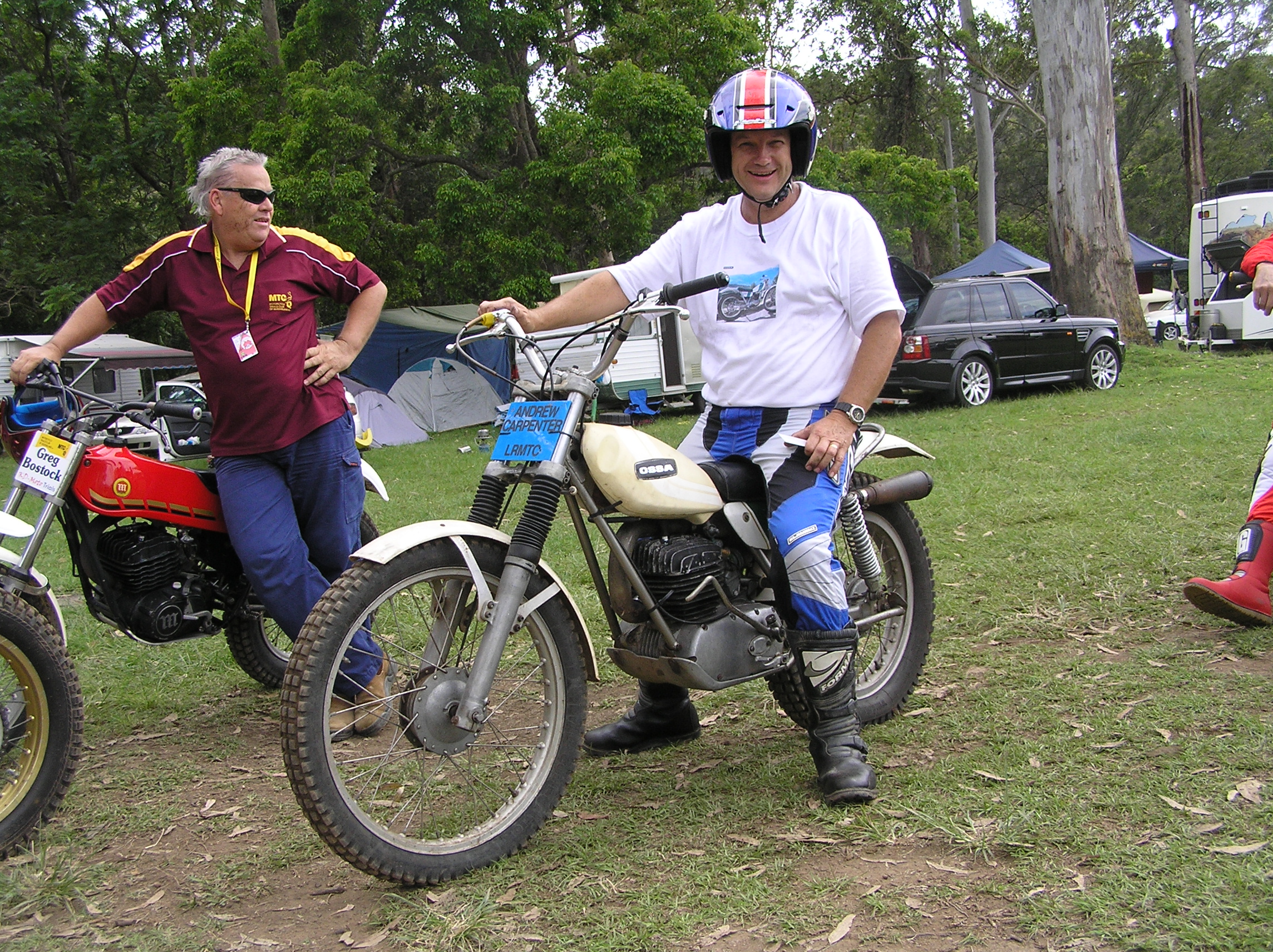

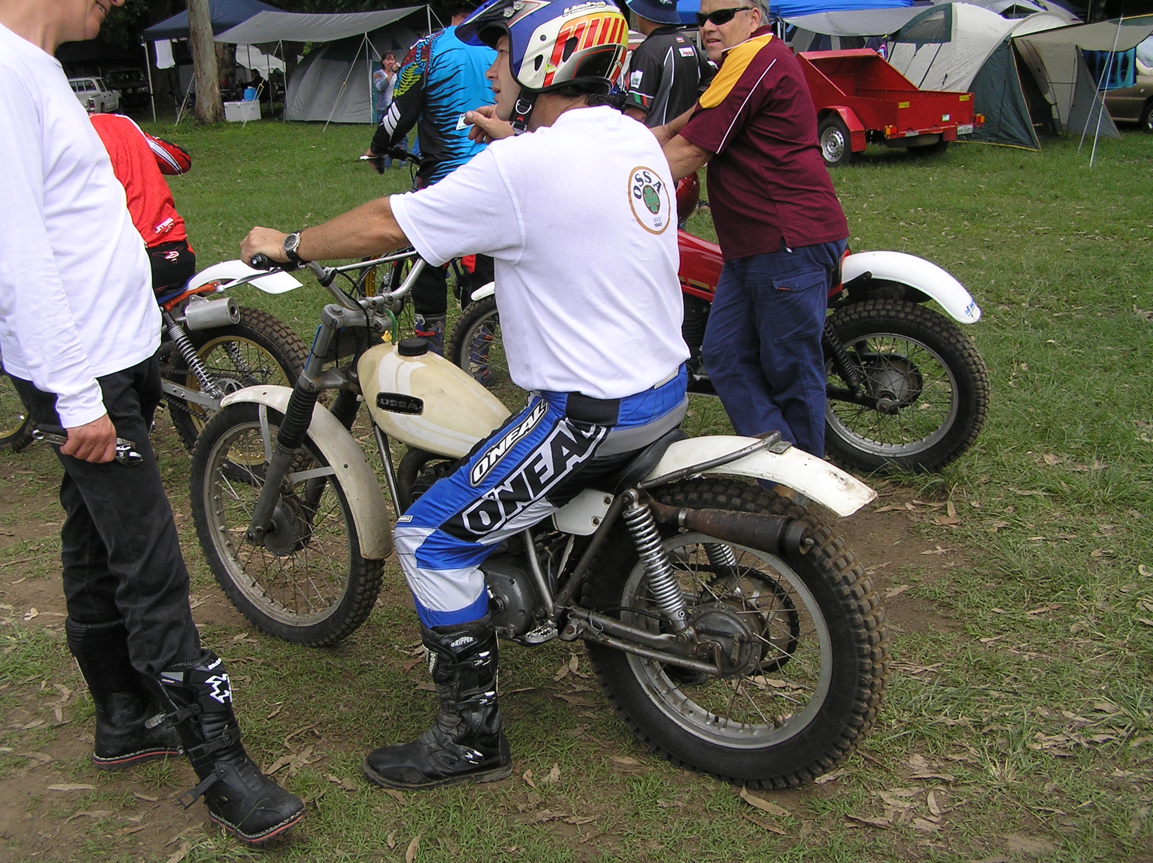

JC1 wrote:Hey Chippy,
I'd still like to see pics of yr "secret weapon" from last year (pg 8 ). Don't see many of that model.
This one?
Re: Basket Cases TY Challenge
Chippy, you certainly don`t mind a bare frame restoration, judging by the photos you have some work to do! If you are unable to source a seat, I am happy to lend you one for the TY Challenge.
JC1, Another keen TY rider and seasoned campainer has already anounced he will be riding something special (another secret weapon) at the TY Challenge.

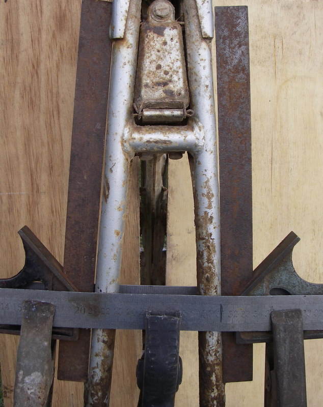

David, what a great Trial the Twinshock Masters was, really looking forward to this years event, havn`t decided what I will ride yet? The 175 that I rode last year never felt right and behaved differently on cambers, one way felt quite stable and the other way was not. Some more preparation time would have been good, but like usual work commitments interfered. Since then, I have run some stringlines around the frame and discovered the front of the frame is twisted off centre. Being a 1974 model and a lot can happen in 36 or so years, I am thinking it has landed heayily at least once!!!!!!!!!!!!!!
Below is a photo depicting the bend in the frame, this simple test has revealed some more 175 frames in my shed with the same problem.
Wow good find Greg. No wonder it felt funny on cambers.
