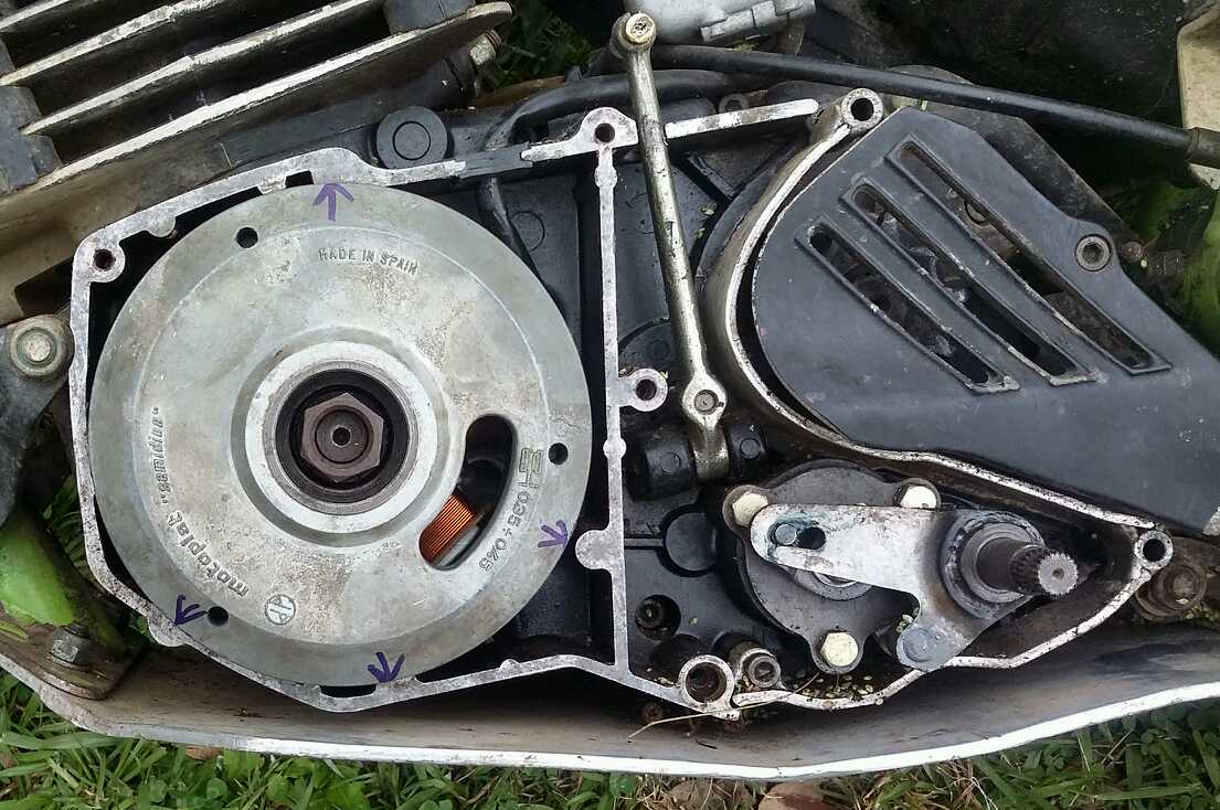

213 Alpina has a gear selector shaft that sticks out each side to allow a gear lever to be fitted to either or both sides. It is easy to see how a brake pedal could be fitted to the wrong side on an
as the brake drum is on that side but I am unsure how you could fit the gear lever on the right side? The gear selector is on a linkage and does not go through to the other side.
There is not much room for an extra shaft, so how did it Work?

sherpa wrote:I just measured my Bultaco's wheelbases and they both came out at around 1335 with the axles a little further forward than the Piuma above - 199A and 199B. I had a Piuma back in 1984, I am pretty sure that's the year they came out here in Australia, but unfortunately that also coincided with the release of the TY mono. So by the end of 1984 and certainly by mid 1985 pretty much everyone was riding Yamahas. The Piuma was a much better bike than the original green bike in nearly every respect and you could even buy a kit to swap the brake and gear change over. I lengthened the clutch lever on the engine case and ended up with a nice light clutch and the brakes were also better than Bultacos, a really nice bike but a little too late onto the market place to make any impact.

Greg, my
Piuma is 1983:Also my
as the brake drum is on that side but I am unsure how you could fit the gear lever on the right side? The gear selector is on a linkage and does not go through to the other side. There is not much room for an extra shaft, so how did it Work?

The kit included a gear lever[right side] a brake pedal [left side] and a gear selector shaft that went through the engine [after removing the existing one] the shaft came out through the primary case just in front of the kick start. There was a metal bung that had to be tapped or pushed out to allow the shaft to come through [pretty sure that its visible in your third photo]
Also you can see the arm that is extended to reduce the clutch effort , you also need to make an adapter to go on top of the engine case to lift the cable the same amount as the lever is extended I think about 20-25mm. I think I must have got mine early 84, it is after all more than thirty years ago
Cheers Greg
Cheers Greg

Greg. if I remember I can take a photo of an Italjet engine with the gear shaft on the correct side. Bernie also liked them on the correct side too. Sherpa, that is a great photo. All of the Bultacos from the M158,159 had a choice of which side you wanted stuff. Correct side or the wrong side!

Part # 32 shows the kit.
