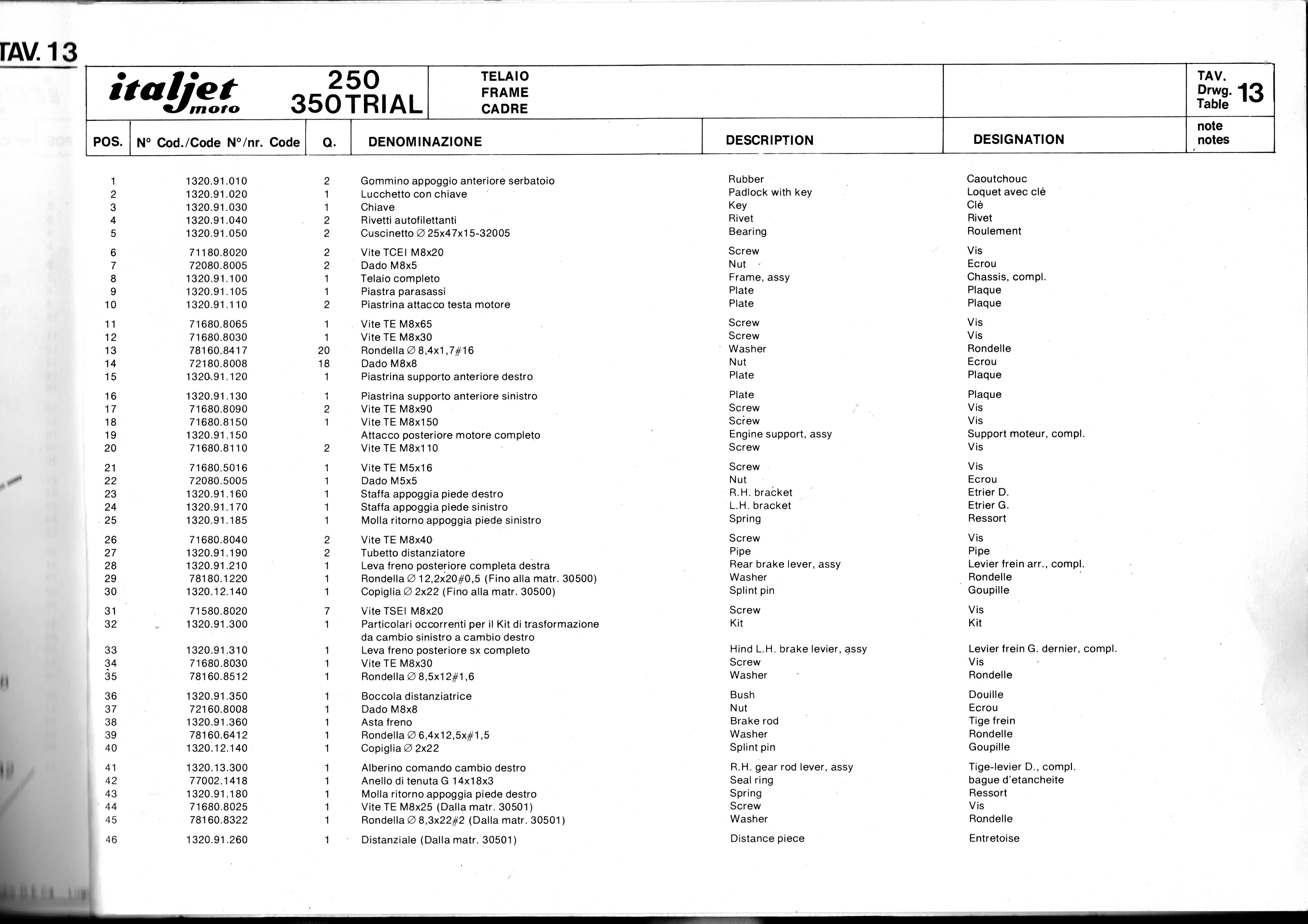

The kit included a gear lever[right side] a brake pedal [left side] and a gear selector shaft that went through the engine [after removing the existing one] the shaft came out through the primary case just in front of the kick start. There was a metal bung that had to be tapped or pushed out to allow the shaft to come through [pretty sure that its visible in your third photo]
Also you can see the arm that is extended to reduce the clutch effort , you also need to make an adapter to go on top of the engine case to lift the cable the same amount as the lever is extended I think about 20-25mm. I think I must have got mine early 84, it is after all more than thirty years ago

Part # 32 shows the kit.
Italjet Manual Pg 13 A.jpg (1.39 MiB) Viewed 5565 times
Italjet Manual Pg 13 B.jpg (1.26 MiB) Viewed 5565 times

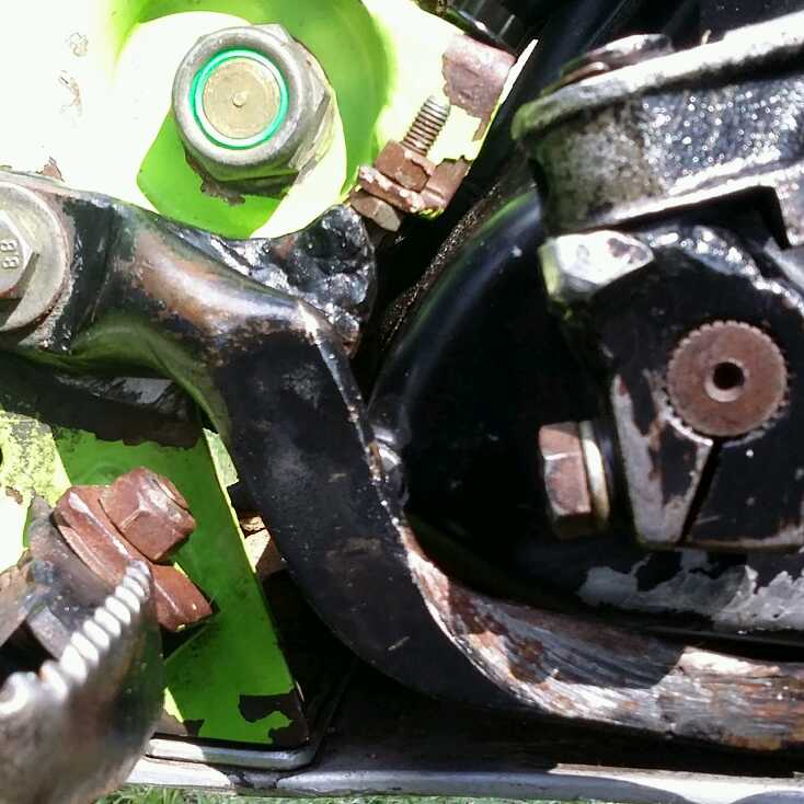

He does remember that time when he hopped on the wrong bike Chippy! He had actually paid a deposit to Frasers for the :italjet: that you ended up with. He went in there to pick it up and they had to say sorry but we will have a couple more in next week. It was only after it all happened that he found out that Frasers had sold the bike that he was supposed to get to you. Good photos of an :italjet: in action though! Greg, I`ll have to send some photos down to you to shrink for me. All of a correct side shift on an :italjet: . One of them is .1 mega byte to large. 2.1 instead of 2. Graham

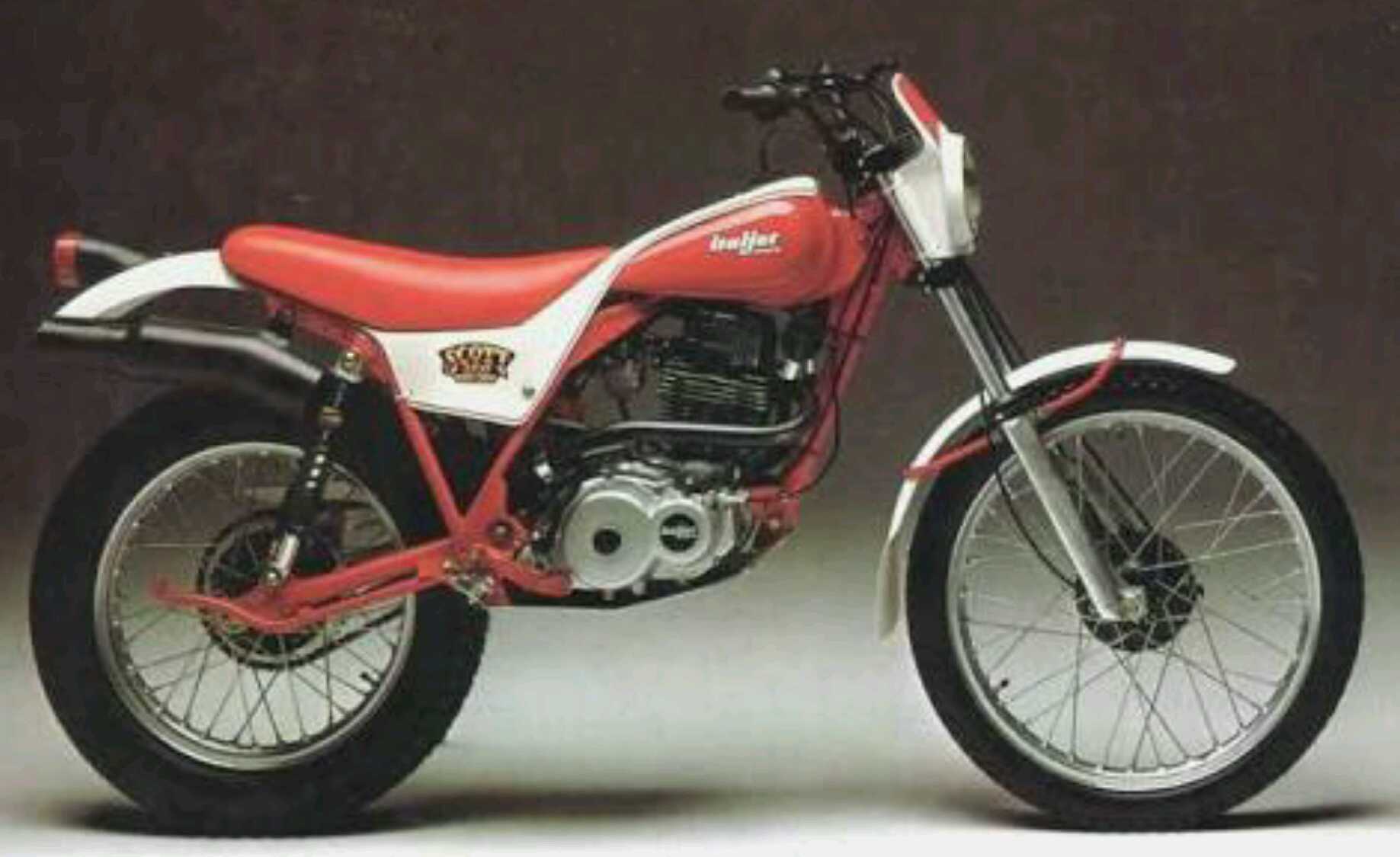

Now back to :italjet: , I find it interesting working out the thought process after all of these years on by looking at how the models progressed:
GREEN on GREEN, first model is really good for a first attempt.
PIUMA had quite a few improvements and all made sense except maybe making the plastic tank Thinner?
SCOTT, obviously :honda: had some influence here with Edy Leisurely winning 3 World Titles on a Four Stroke! Maybe you don't agree but how do you explain the back flip from removing weight to adding It?
Now I am only guessing here:
After the Huge success of the Scott, the party that I think must have included Grappa someone came up with A idea. Let's put an A in front of SCOTT and call the next model ASCOTT!
The overwhelming success speaks for itself!
Graham, I have fixed your photos of the gear lever on the correct side:
