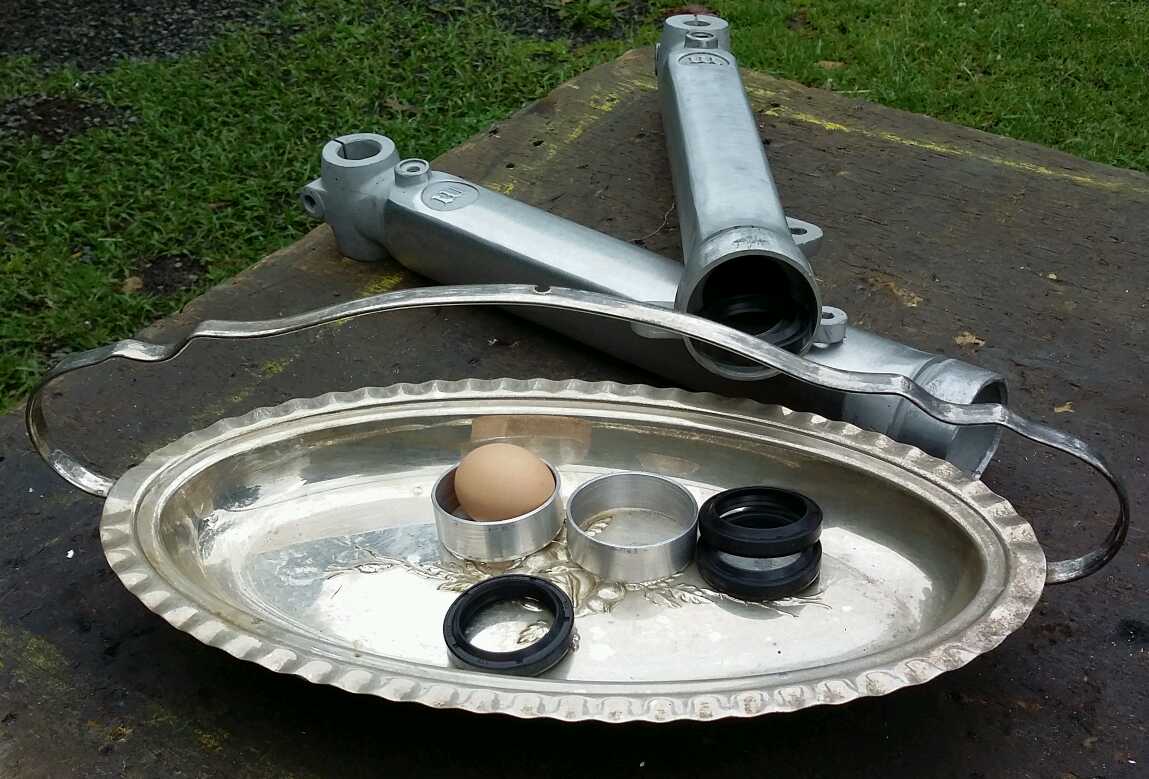

Continuing my GREEN THEME for 2008TEEN, it was KERMITs turn for some attention this afternoon. These don't seem to be common as they only come on later models and some :montesa people will even deny they exist! They were not fitted to KERMIT when I got him but they were in the spares with RUSTY Chrome legs. For some time now I have been chasing fork seals for the 31.7 mm sliders without any luck. The original seals are 31.7mm x 45mm x 11mm or 12mm and it seems are no longer available. I did however find 31.7mm x 42mm x 7 to 9 fork seals out of a Binelli scooter so I machined up these adaptors:
Yeah I know, they look like egg rings! Here they are fitted

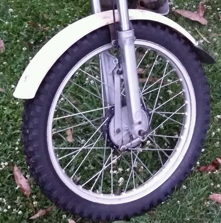

Greg I`m very sorry to inform you that you have now diseased a very good front brake arm on that Imitation Spanish Trials bike! That looks to me like a :bultaco: front brake arm on that thing which calls itself a trials bike but is in fact not a trials bike. I feel sorry for you and I hope you will recover very soon. :bultaco: :bultaco: :bultaco: :roll:
Nice job on the fork seal spacers though! =D>

Graham, aluminum can be tricky to get a good finish, I used a bit of scaffolding tube which I don't think is the best for machining. The rough texture will hold it all in place as there were no circlip grooves.
Bully fanatic wrote:Greg I`m very sorry to inform you that you have now diseased a very good front brake arm on that Imitation Spanish Trials bike! That looks to me like a :bultaco: front brake arm on that thing which calls itself a trials bike but is in fact not a trials bike. I feel sorry for you and I hope you will recover very soon. :montesa :montesa :montesa :roll:
Graham, I think you are right, here is an original brochure photo showing a round end:
This is how it came to me from Chippy:
.......and I did not realize until now. I liked the patina on the backing plate and hardware, the hub was painted and I laced the wheel with reworked secondhand spokes.
