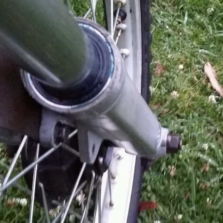

Continuing my GREEN THEME for 2008TEEN, it was KERMITs turn for some attention this afternoon. These don't seem to be common as they only come on later models and some :montesa people will even deny they exist! They were not fitted to KERMIT when I got him but they were in the spares with RUSTY Chrome legs. For some time now I have been chasing fork seals for the 31.7 mm sliders without any luck. The original seals are 31.7mm x 45mm x 11mm or 12mm and it seems are no longer available. I did however find 31.7mm x 42mm x 7 to 9 fork seals out of a Binelli scooter so I machined up these adaptors:
Yeah I know, they look like egg rings! Here they are fitted
And here are the forks back in the bike with :montesa 242 front wheel:

Nice job on the fork seal spacers though! =D>

Very nice Greg. How is the action on those forks?

David Lahey wrote:Very nice Greg. How is the action on those forks?
That is a question I can't answer as I only had enough oil for assembly so I will have to get some more. The forks were pretty good with the round sliders so I assume they will be the same with square ones. My question is how much oil, I think I guestimated last time? The seals were so bad that at one point they must have been perfect like a dead clock that tells the right time twice a day?
The right amount would be a good starting point!
Bully fanatic wrote:Nice job on the fork seal spacers though! =D>
Graham, aluminum can be tricky to get a good finish, I used a bit of scaffolding tube which I don't think is the best for machining. The rough texture will hold it all in place as there were no circlip grooves.
Are the square ones from a later model 172?
An oil quantity that is fail-safe in forks from that era is the top surface of the oil at 125mm below the top of the tubes with the sliders fully up and no air trapped in the bottom anywhere. Proof that this is enough oil is that when you then extend the sliders to the bottom, there is still oil covering the top end of the damper rod.
