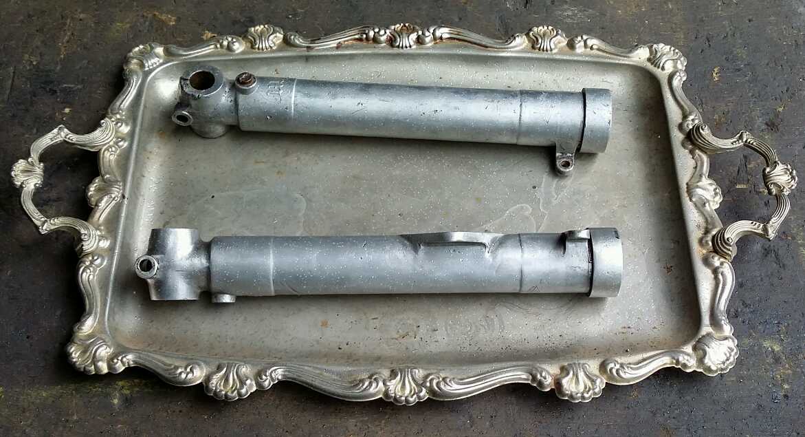

Greg
When you replaced the seals, what condition were the fork legs in regarding wear as mine are sloppy on the fork tubes and need to be sleeved (if that's possible) :(
Re: how to move a KT250 when the wheels don't turn
Posted: Wed Oct 17, 2018 9:27 pm

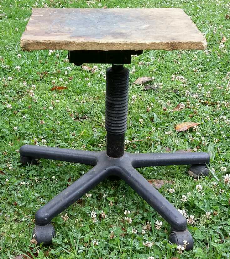

David Lahey wrote:There are witness marks on the driveway that explain how the KT was moved (sideways)
David, nice :kawasaki , love the patina! Perhaps you need some office chair bike stands? Move in any direction, swivel, up and down!
Bikestand on a hand trolley was how I moved this :bultaco: M49, the only thing that moved was the steering.

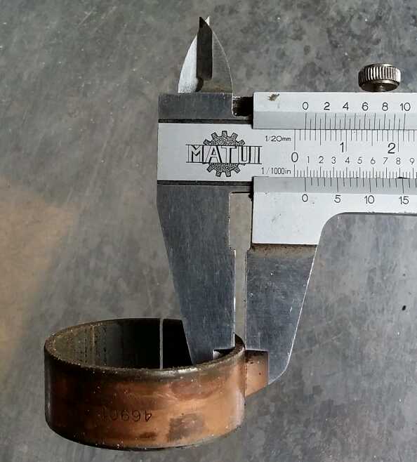

Phil 850 wrote:Greg
Phil, the chrome and legs are pretty good, just how sloppy do you mean? Maybe slide feeler gauges between chrome and slider? I did not measure the clearance with the square legs and a little hard now but the round sliders only have about 0.1 mm clearance.
Something tells me that the top will be belled out and ovalling on the brake arm side? Also how good is the chrome, if it is pitted and then ridden, it will be like round file, also the chrome flakes off and sticks inside the slider.
So I can see a couple of remedies IF the chrome is good, linish the legs, check the clearance and machine up some bronze guides to go below the seals. I doubled up the seals on Kermit but one seal would work fine.
Some later model bikes use Teflon guides like these :honda: TLM ones:
Another way would be to find out if Benelli scooters that have 31.7 mm legs use guides and if so machine a rebate below the seals if there is enough material?
Forks with guides have a guide below the seal inside the leg and a guide on the bottom of chrome leg and chrome leg is NOT in contact with aluminum leg. In your case, I don't think you would need the bottom guide but I don't know the condition of any of the parts!
IF the chrome legs are NOT serviceable and clearance is too great, some small KTM use 32 mm forks, I am not familiar with them but might be an option to get the sliders and triple clamps bored if chrome legs are suitable?
Posted: Thu Oct 18, 2018 9:26 pm
by Phil 850
I'm going out on a limb here, but I think my fork legs are less than perfect :(
They don't even look like they have ever been chromed :lol: .
Would KTM legs be long enough for my bike ?
Or, can mine be rechromed and ground.
