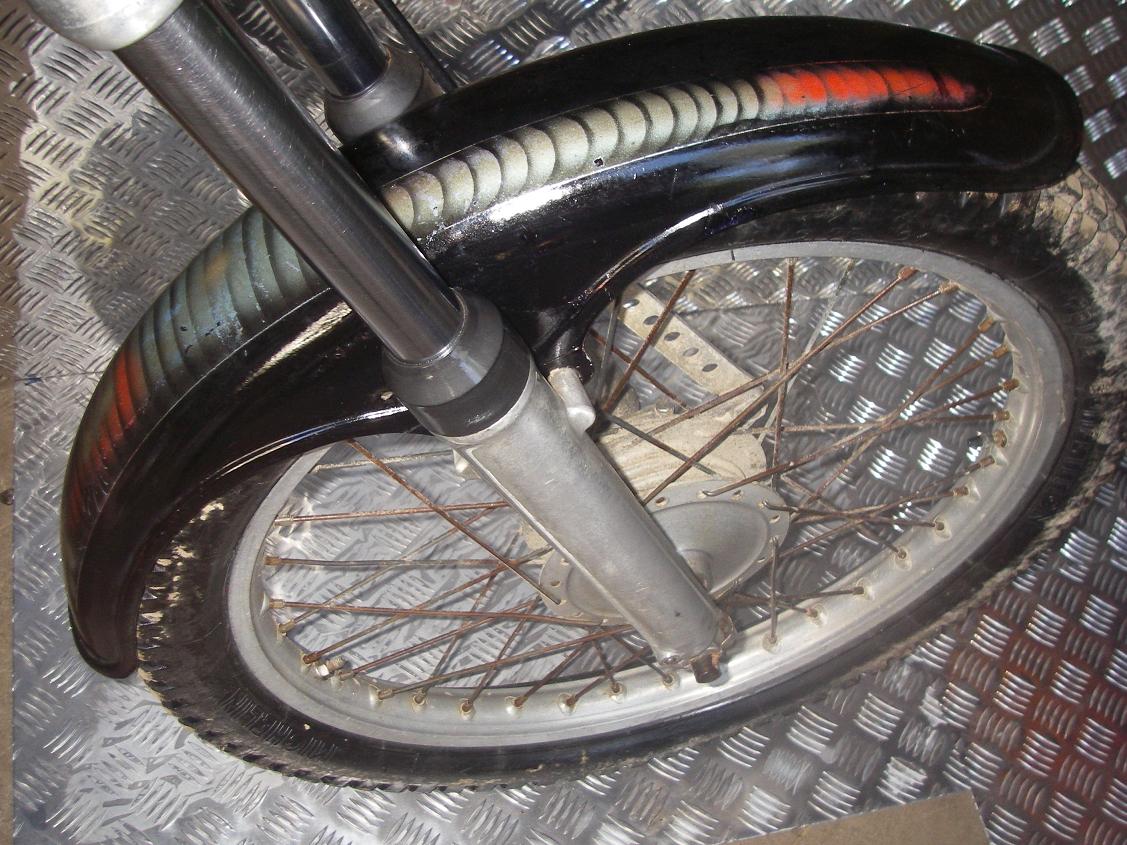

Greg I think you got the photos I sent you mixed up. That one is of my wife's bike - well the latest version anyway, but she might make me change the decor on it yet again - she's very fussy you know

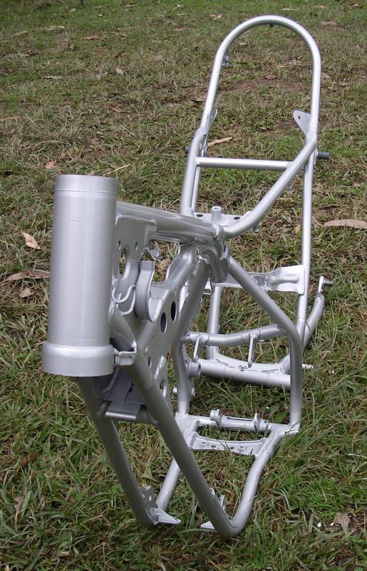

Look forward to this years event and I am in the process of prepping a bike at the moment, going to a little more effort this year. Below is a photo of frame and swingarm.
