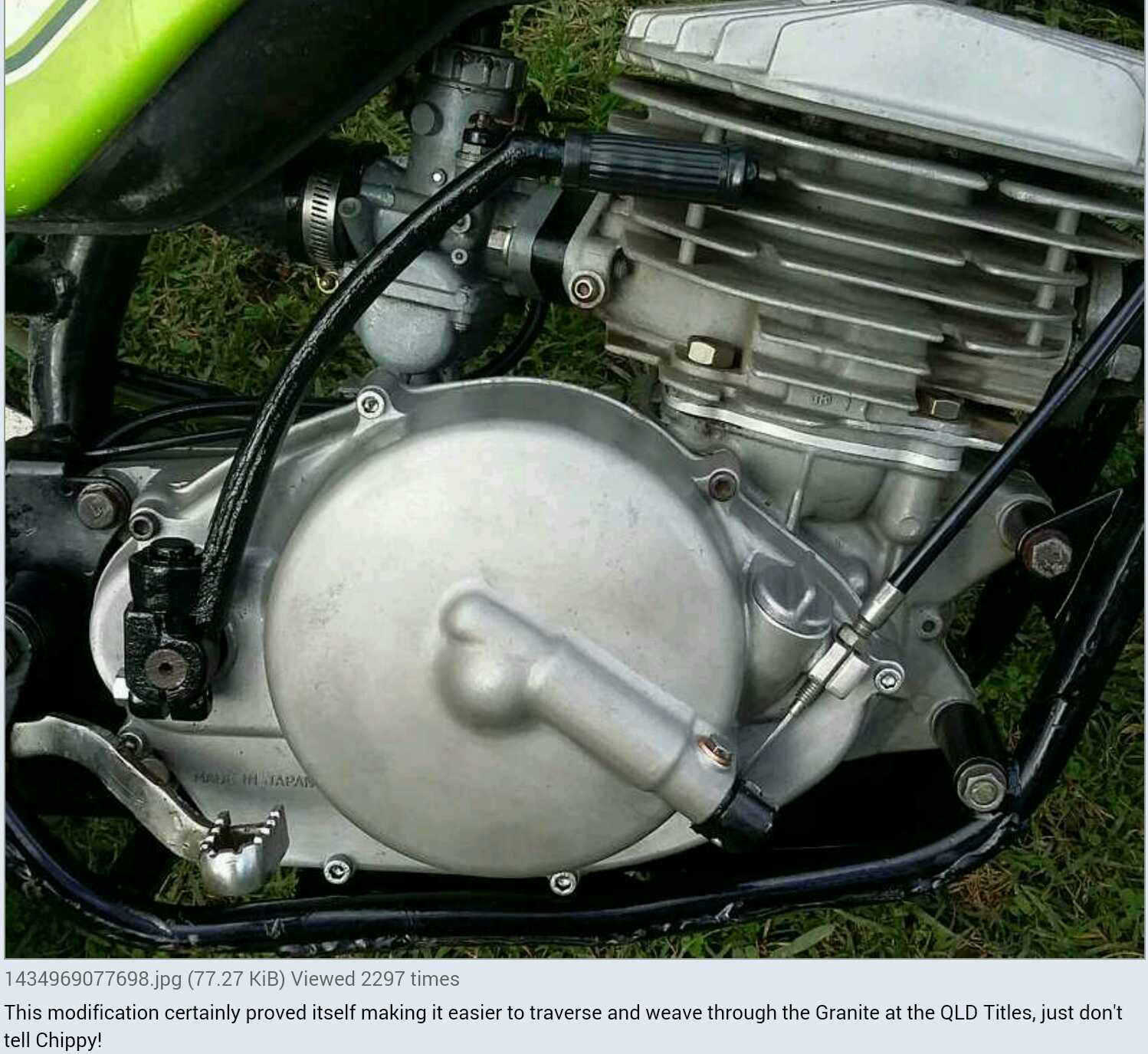

Less bends in the clutch cable =
SIMPLESNESS
Totally with you Rod, this is the only domesticated cat that I like:

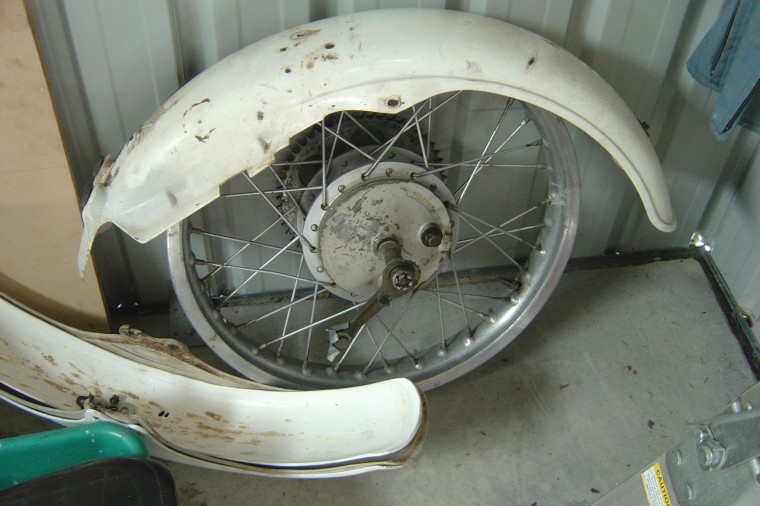

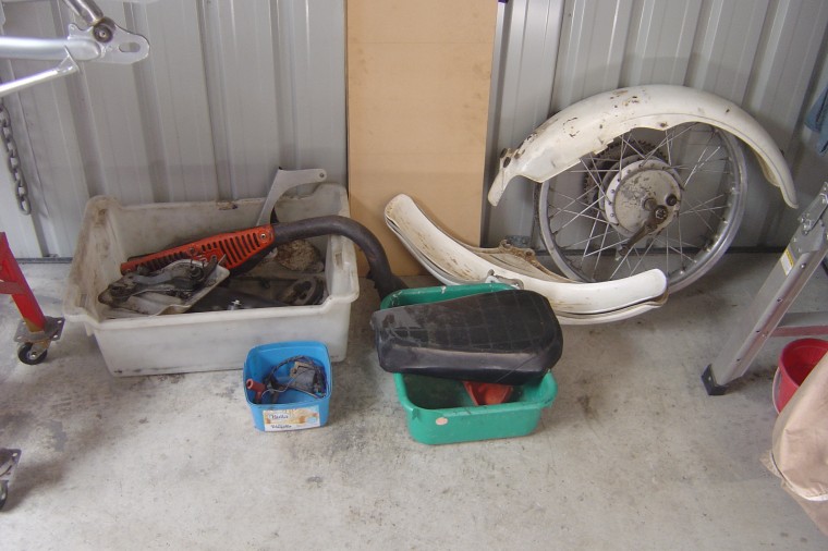

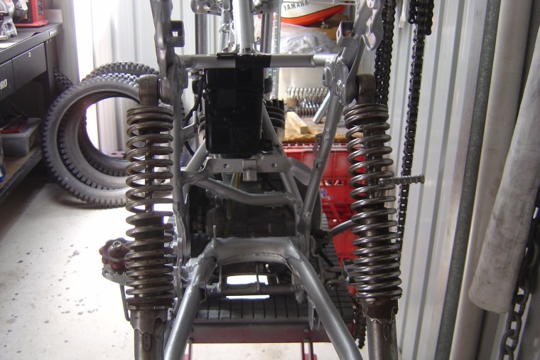

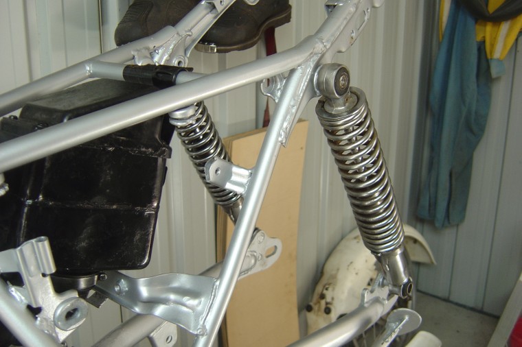

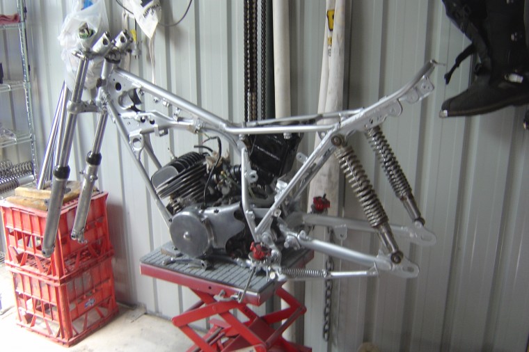

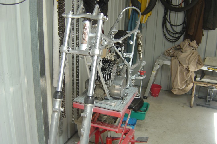

This is slightly past the "basket case" stage but its still in bits so I guess it qualifies.
Its a TY175C 1976 and its at the "put it back together stage"
The frame and motor are done and its being built as a competitive twinshock bike. I have the complete wiring harness complete with headlamp, horn and ignition key and they will become surplus to requirements.
It will end up with new tyres, stainless spokes (only way to go) and new mudguards.
Some of the bits fitted in the pics are still to be finalised.
Hoping to get it finished by Christmas so if anyone is looking to treat themselves to a fully restored TY175 for next season give me a call 0402 736045
