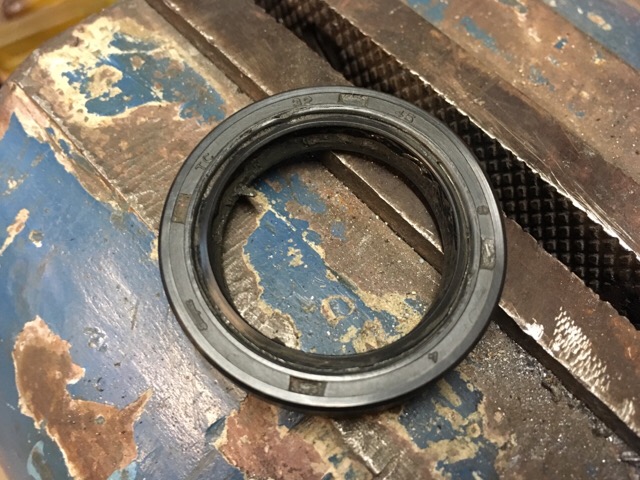

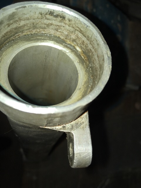

Phil 850 wrote:I'm going out on a limb here, but I think my fork legs are less than perfect :(
They don't even look like they have ever been chromed :lol: .
Would KTM legs be long enough for my bike ?
Or, can mine be rechromed and ground.
Measured inside the fork bottom housing and it is 32mm across and 32.1mm in the for/aft direction at the top, but a bit further down it is 32mm compared to the fork tube of 31.8.
It's bored the same diameter all the way down with no bearings, just the aluminium.
This is the seal
Apparently off a Subaru cam shaft so easily obtainable.
The fork tube is the same dull colour for its entire length and no sign of chrome anywhere.
I don't know why this comes up with the wrong photo in the quotation.
