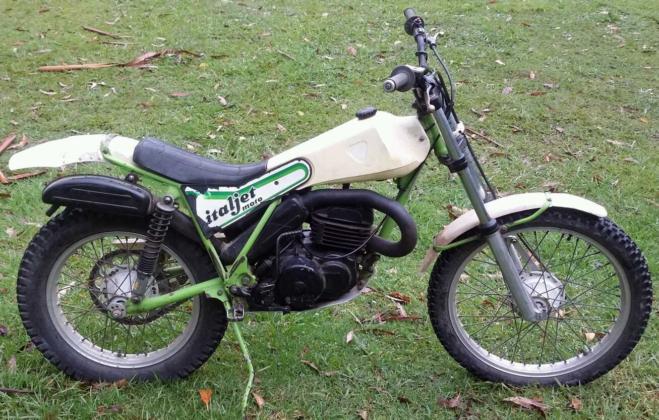

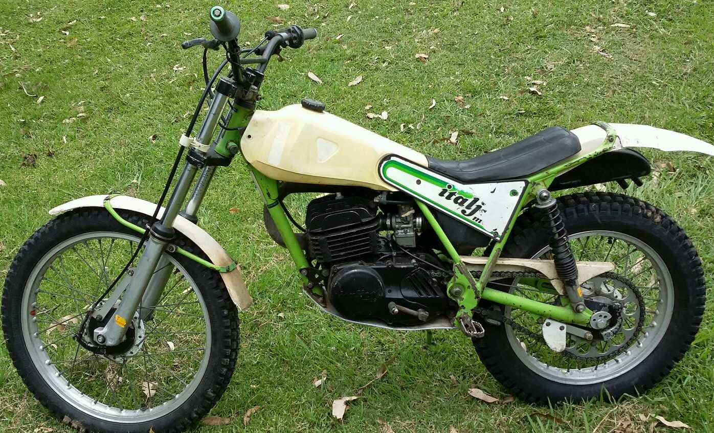

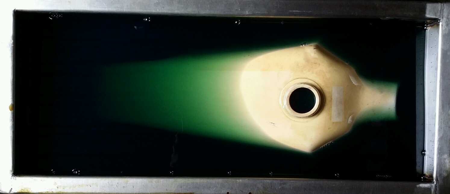

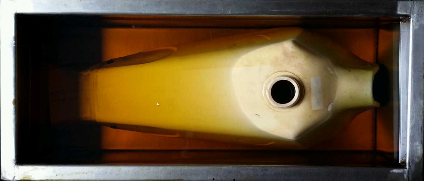

Continuing my GREEN THEME for 2008TEEN, this time I was not satisfied with my plastic tank rehydration idea so I tried again. The beige tint from the fuel makes me feel a bit, well beige. This time I sealed the fuel tap hole and filled the tank with premix Castrol TTS, a very strong batch as there was enough oil in the :italjet: tank for the 22 litres in the soak tank.
After 2 weeks, there was no migration of the blue fuel into the soak tank and when I lifted the :italjet: tank, Still beige so I mixed all of the fuel:
After another week, still beige :( :( :(

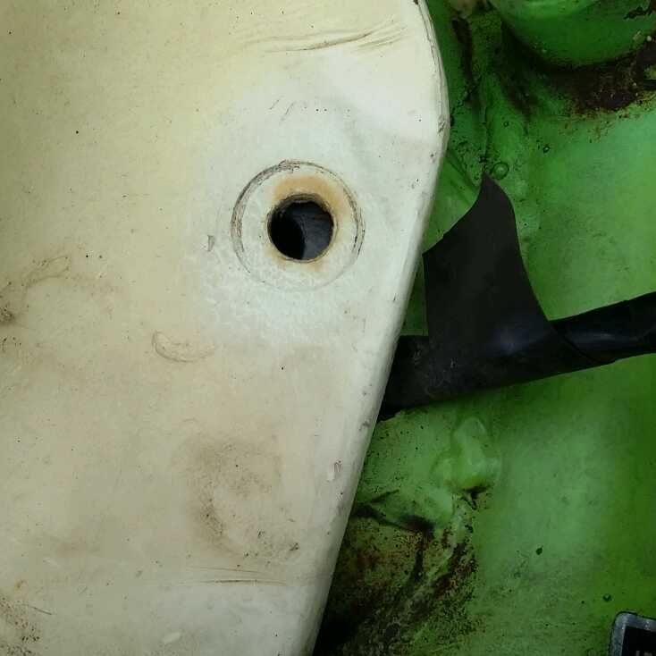

And another problem has come to light, it has gone a bit BLOWFISH, a beige one and the mounting holes don't line up.
Still enjoy riding it, 3 weekends now and it has picked up a :kawasaki trait in so much as at a certain Rev, it hums a hollow growl until drowned out by exhaust noise, I think the tank is rubbing on the frame just above the motor?

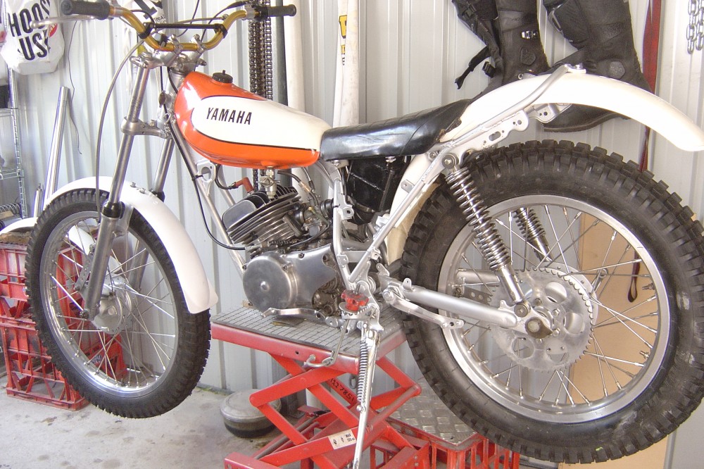

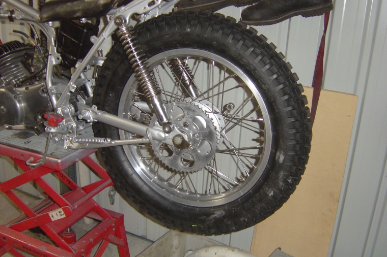

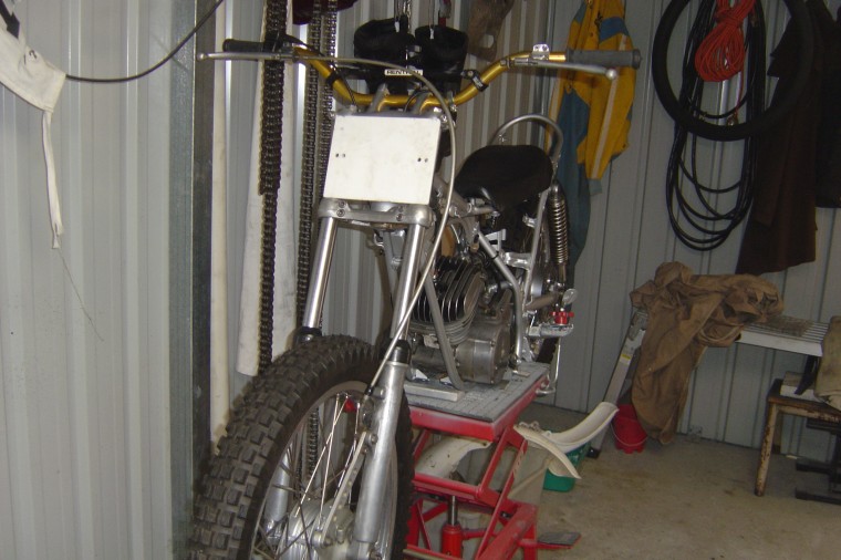

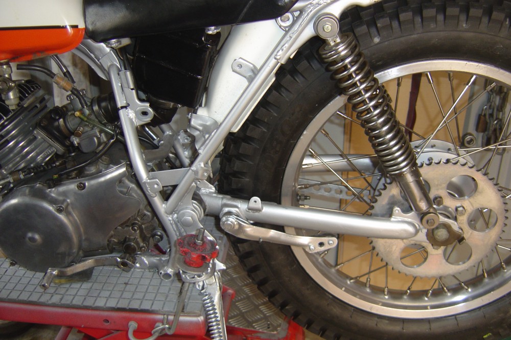

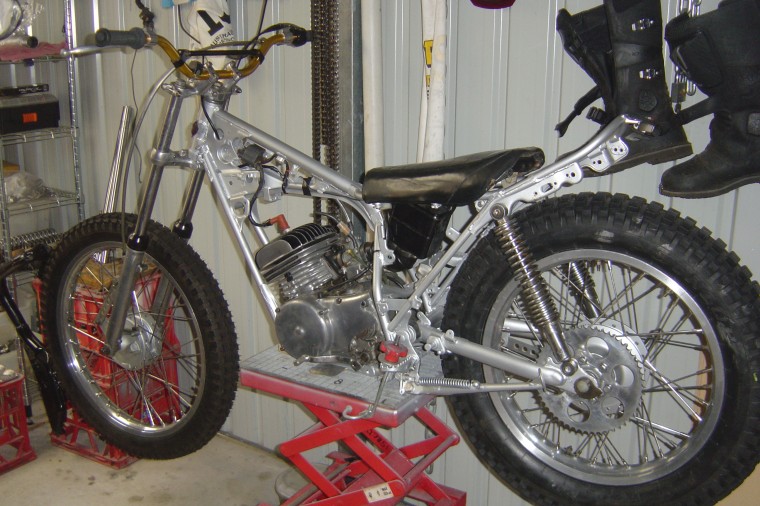

The latest on the TY175 rebuild, its coming on now, wheels rebuilt with stainless spokes , new front, 95% rear.
Big spark, new air filter element new cables, working on exhaust now.
Still lots of small stuff to do.

Twinshock200 wrote:The latest on the TY175 rebuild, its coming on now, wheels rebuilt with stainless spokes , new front, 95% rear.
Galps
Looks very pretty Roger. I'm about to rebuild some more TY wheels and am interested in where you got your stainless spokes from

Looking great Roger. Keep us posted on your progress. Just because our projects start off as basket cases,shouldn't mean they stay hidden when we bring them back to their former glorious condition.
I've also got a couple of TY 175 wheels to respoke and am interested in where to find good quality stainless steel spokes without having to mortgage the house.
These bikes are little, but bits can be elusive and expensive..

Slowly making some progress on the TY175 project with some more parts replaced or restored and fitted and others placed in position to keep me motivated.
Not sure where my wheel builder gets the stainless spokes from David but they look great when fitted and seem to stay clean and shiny for years.
I had taken advantage of my trip to the UK and the Isle of Man last Aug/Sept to pick up some urgently needed TY parts but they came at the expense of having to leave my trials boots and helmet in the IoM to make enough room in my luggage for the new parts.
A few more hours and it will be ready to fire up, can't wait.

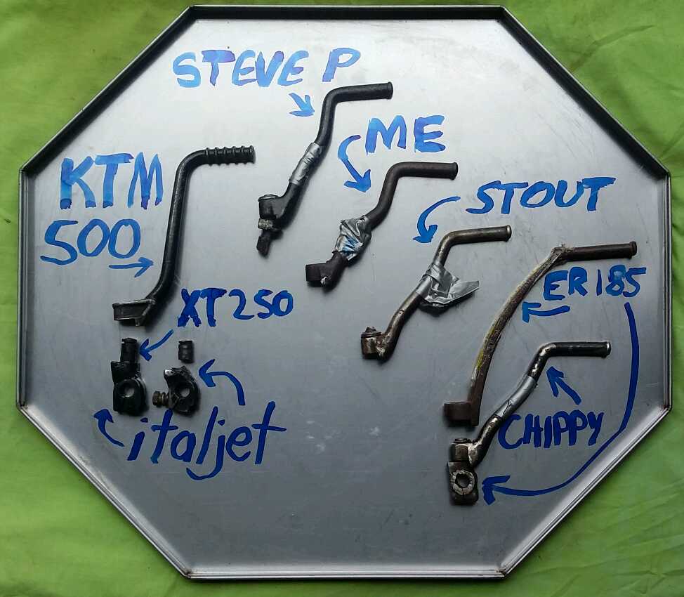

Disaster struck last ride and I broke my custom :italjet: Kickstart! Somehow I managed to get myself in a awkward position and didn't give it a good kick and I think it was coming to a stop on compression as I was having a hurried 2nd kick and snapped the pin off! It has always amazed me how many people in Trials that are friendly and helpful and I now have a selection of :italjet: kickstarts! Another trip to the parts shed and I found a bottom piece off a :yamaha XT 250, a little Tigwelding, filing, swearing and good to go again.
The end result is a little unorthodox, so I will try and explain with photos :
An
Kickstart arm swings on a
Pivot pin welded to a
Knuckle in
Gets it all working again, all good on today's ride!

Roger, nice work on the TY and did you get it finished?
Greg, how is the :italjet: tank problem going and nice work on the kickstarter as they are renowed for breaking as I recall I had a green :italjet: from brand new and had problems with the kickstarter early on and I think thats the one I gave you.

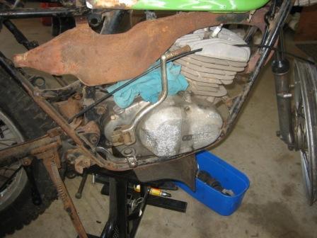

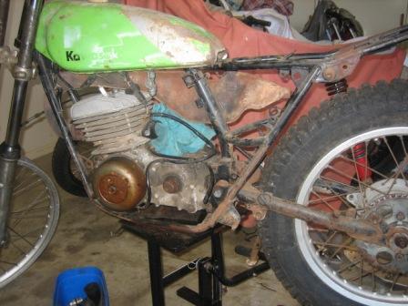

So in my absence, I see Greg and David have been attempting to have a :kawasaki KT clutch lightening "shoot off". So David, with using the TY clutch springs, does that give you any problems with it slipping on say a big hill climb and I would be interested to know, or if any other clutch springs will work. Greg, so using the KX250 clutch cover creates a straighter pull for the cable, but did you have to do any other modifications to get it to fit and how hard is getting an early :kawasaki KX250 clutch cover to get?
Why I am asking these questions, is that during the Christmas break, I decided to have a close look at all my :kawasaki KT parts with the thought of doing a modified bike, to some degree. So over a couple of nights I assembled what I had and so see if I could get spark out of the motor and check for any play in the main bearing and if there is any wear in the cylinder bore etc.... Well so far so good..... Happy Days!!!!
I am missing a few parts, so does anyone have any spare :kawasaki KT parts lying around to help me out please?
