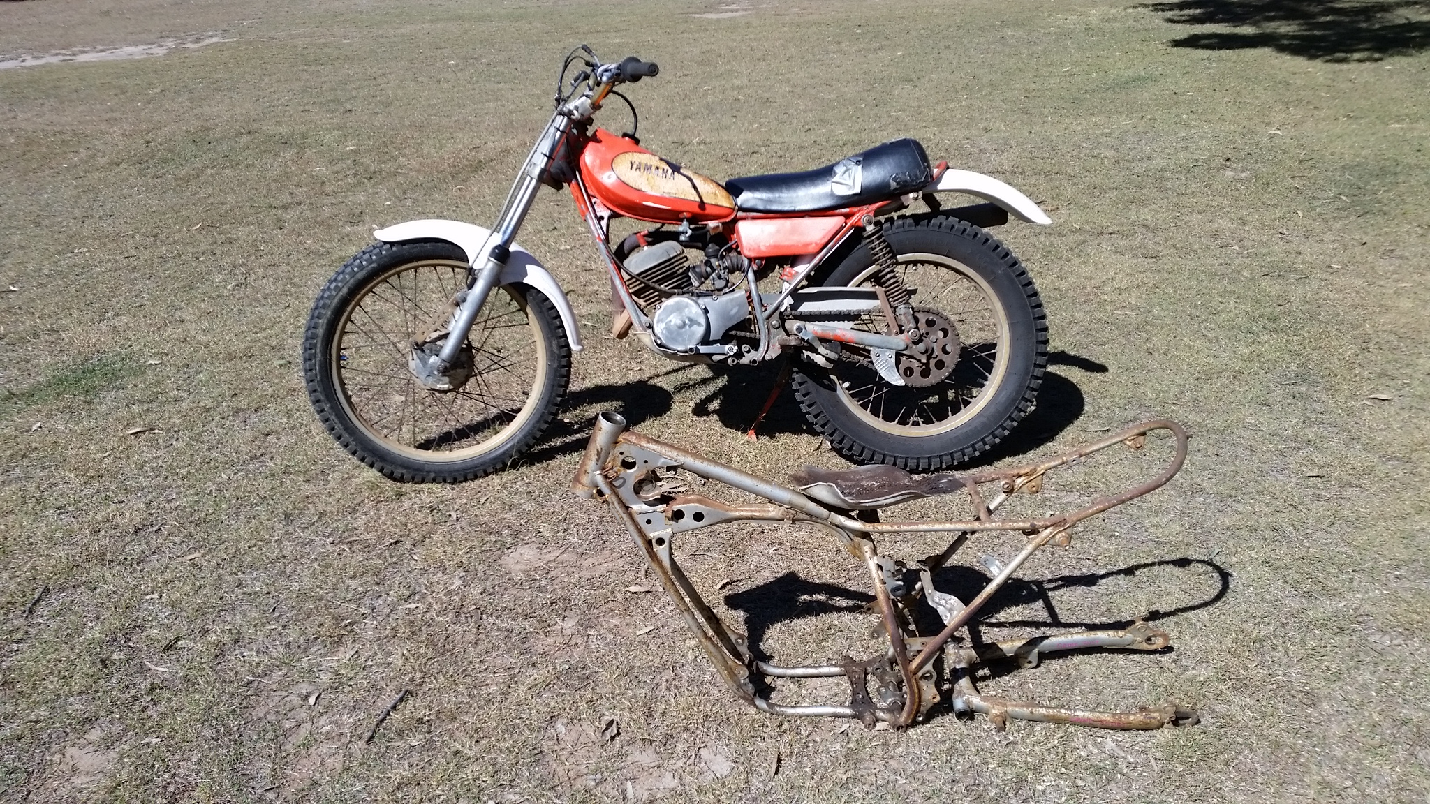

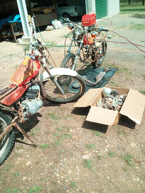

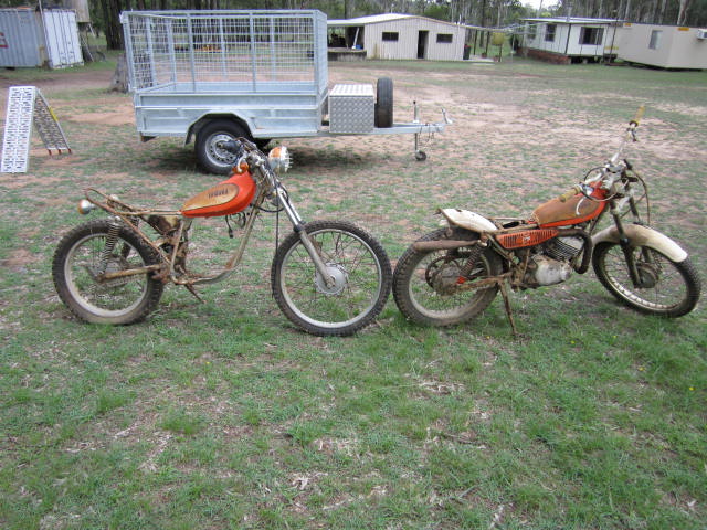

Chippy asked and a couple of other guys may be interested in how I'm going with my s l o w TY rebuild.
It actually started off as 2 bikes bought as spare parts for my perfect patina twinshocker.
I've had the frame blasted and painted locally. Most of the alloy parts are being blasted at the moment. If I like the finish and the company is happy, I'll post their name with the photos when I get them home again.
I've put both heads on my lapping plate, had both barrels rebored and I painted with VHT and baked. Now, I may have used someone else's oven... Karma is a bitch though. As I forgot that the windows were closed. Cooking paint smells awesome haha.
The left side engine cases have both been damaged from the drive chain coming off and all the lovely remodeling that it does. I have had 1 welded and that's where the engine stalled.
I figured if I build a rolling frame, I'll have a reason to build the engine and so on.

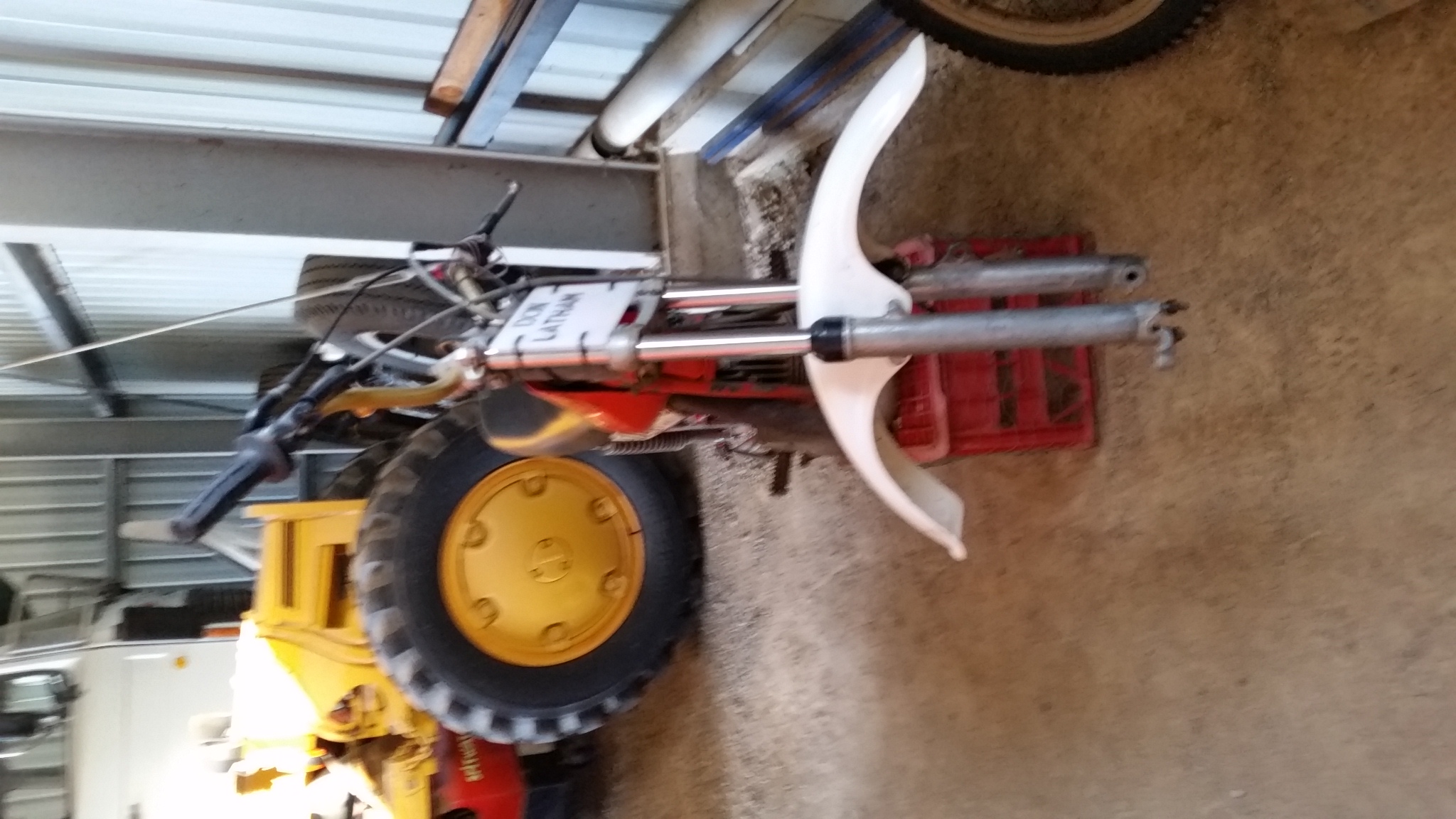

I forgot to put this photo in my last post. The rechromed forks tubes look awesome. I miss the patina of the original as found condition, but these won't eat fork seals anymore. Work done by Rad hard chrome in Brisbane
- 20190111_173842.jpg (655.64 KiB) Viewed 5230 times
- Posts: 4118
Looking good. It's great that you are retaining as much patina as practical.
