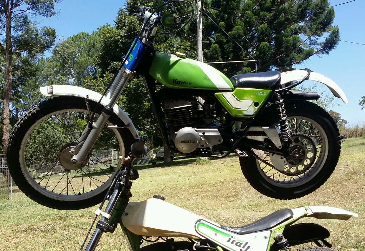

For some time now, I have been riding the :italjet: Piuma and there has been some ups and downs but overall it is good to iron out some problems and adjust it to suit me.
With all this talk about :kawasaki , I have decided to bring Franken KT out into the daylight for a couple of rides.

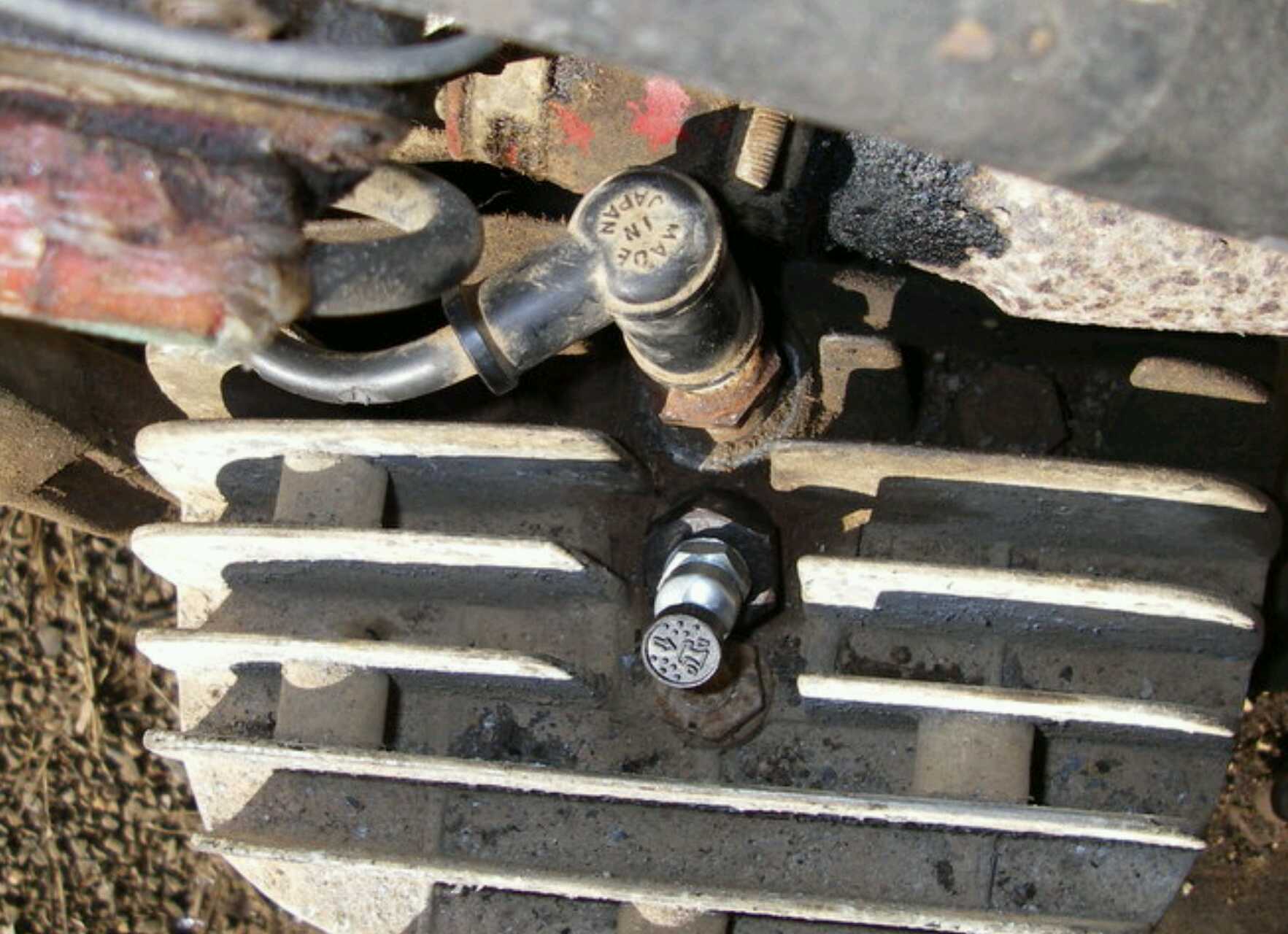

Phil, I think Kurt is on the money with his 3rd attempt, Kermit has been started a lot with a Kickstart shaft that looks like yours using the decompressor:

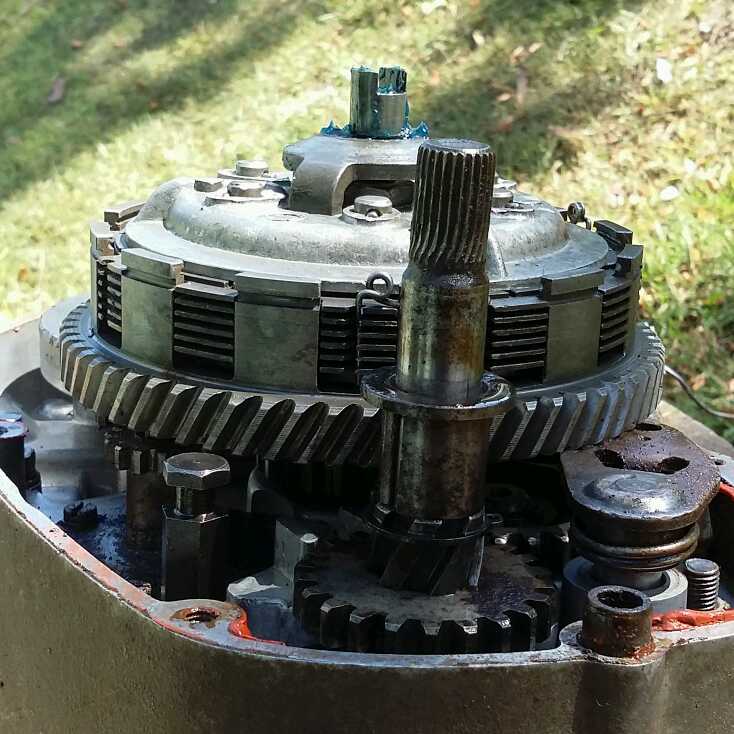

Here is my spare parts motor and it looks pretty much the same:
You can read more about it on page 100:

Thanks for the info. What type of chainsaw was the decompressor off.
It should certainly improve the life of the kickstart shaft (and my right leg)

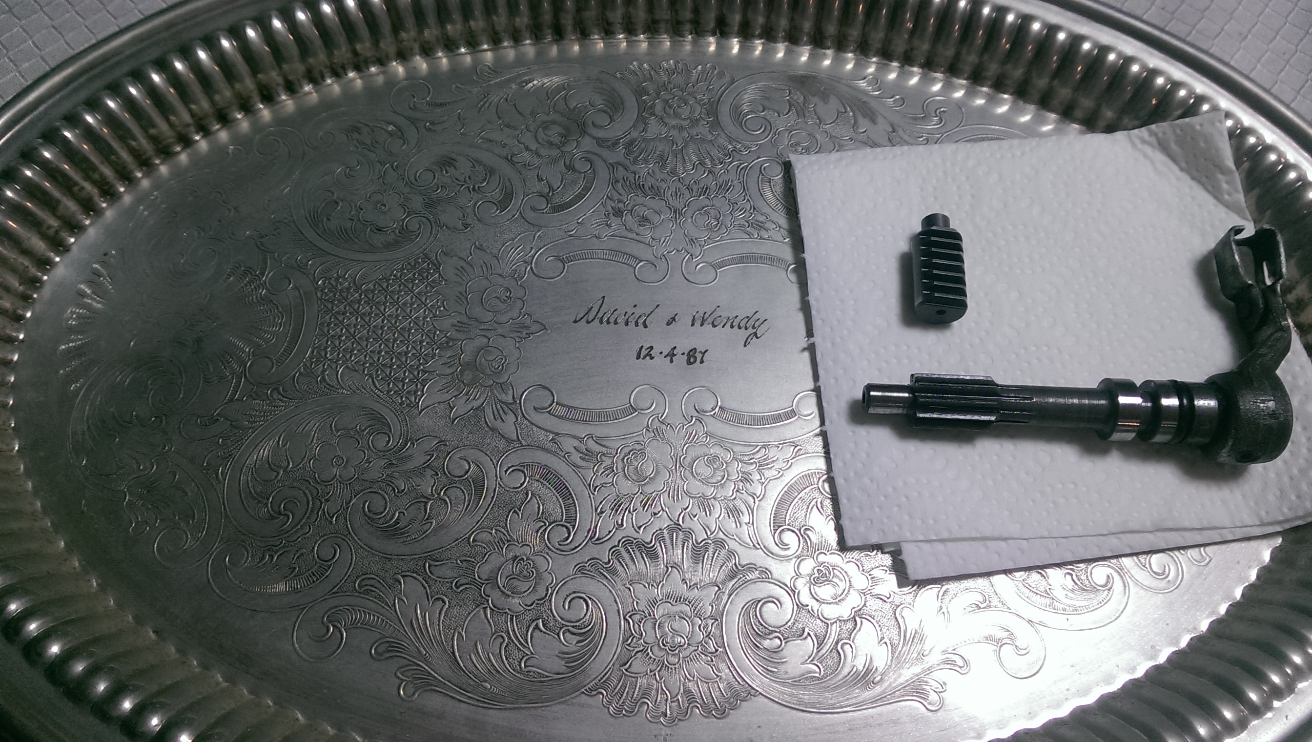

Today Chippy had me thinking that a silver tray would be something that might be better than newspaper (pffft!) for taking photos of parts upon. No idea where Chippy got that concept from, but tonight I noticed a silver tray in the dining room display cupboard and decided to try it out. When up close I noticed some old writing on it that reminded me of something that happened when I was young and thought I had better check with Wendy before I take the tray up to the workshop for good 8)
Especially for Greg and Chippy and any other :kawasaki people, the bits on display are the rack and pinion for the clutch from my KT :kawasaki . I'm fairly happy with the design and manufacture of the bits that make up the clutch on a KT so I'm still keen to have a clutch pull challenge, especially the Greg Harding KX :kawasaki clutch cover vs KT :kawasaki clutch cover.

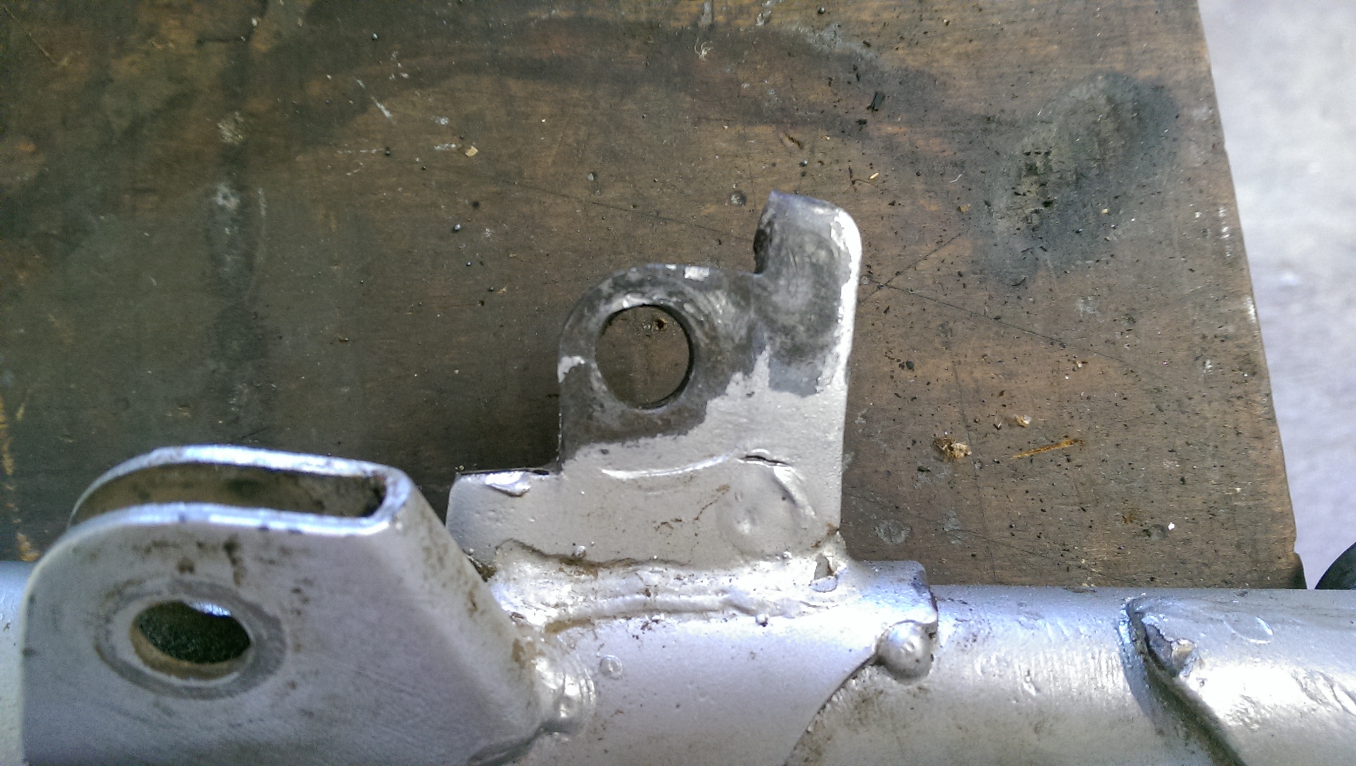

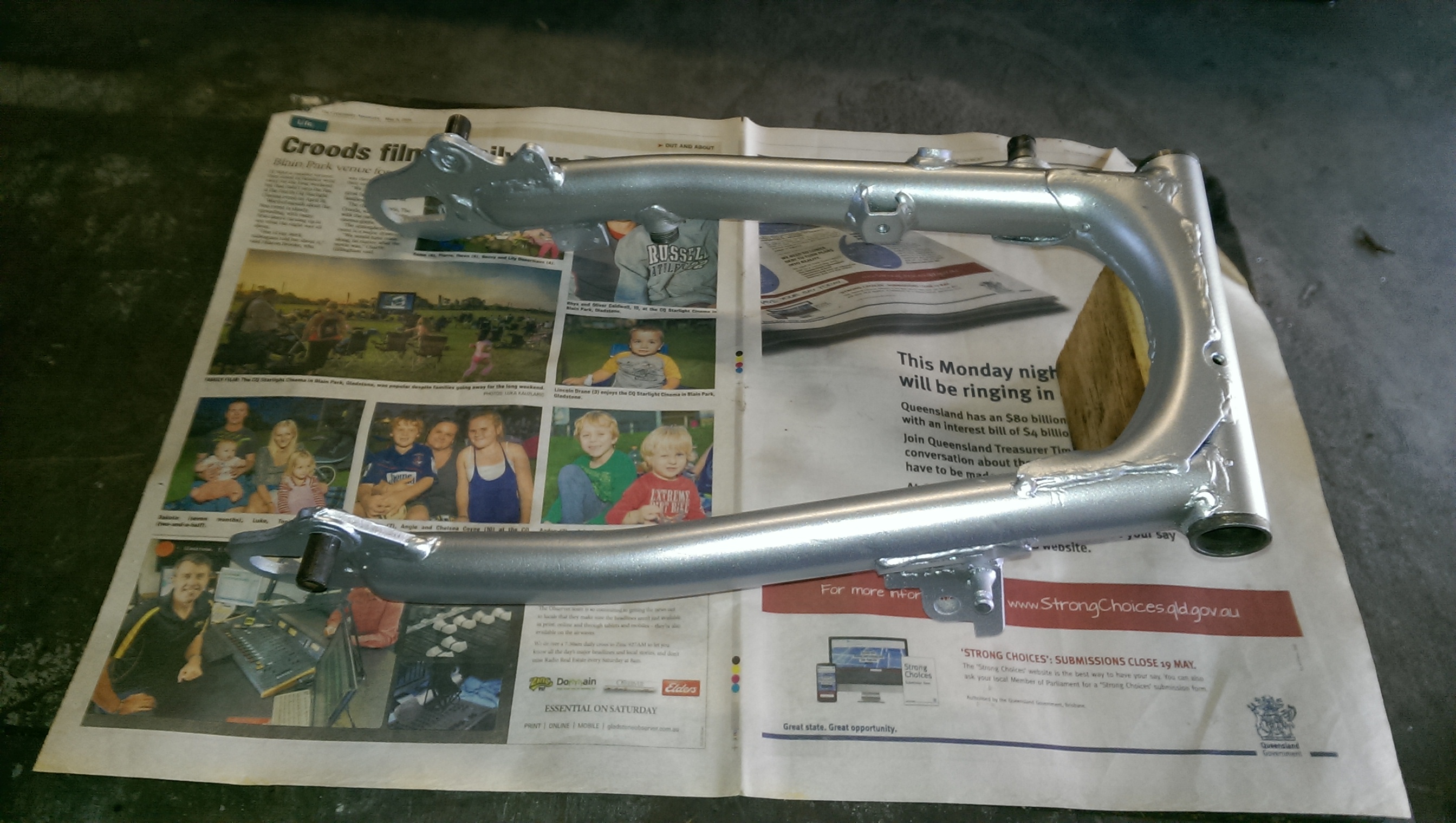

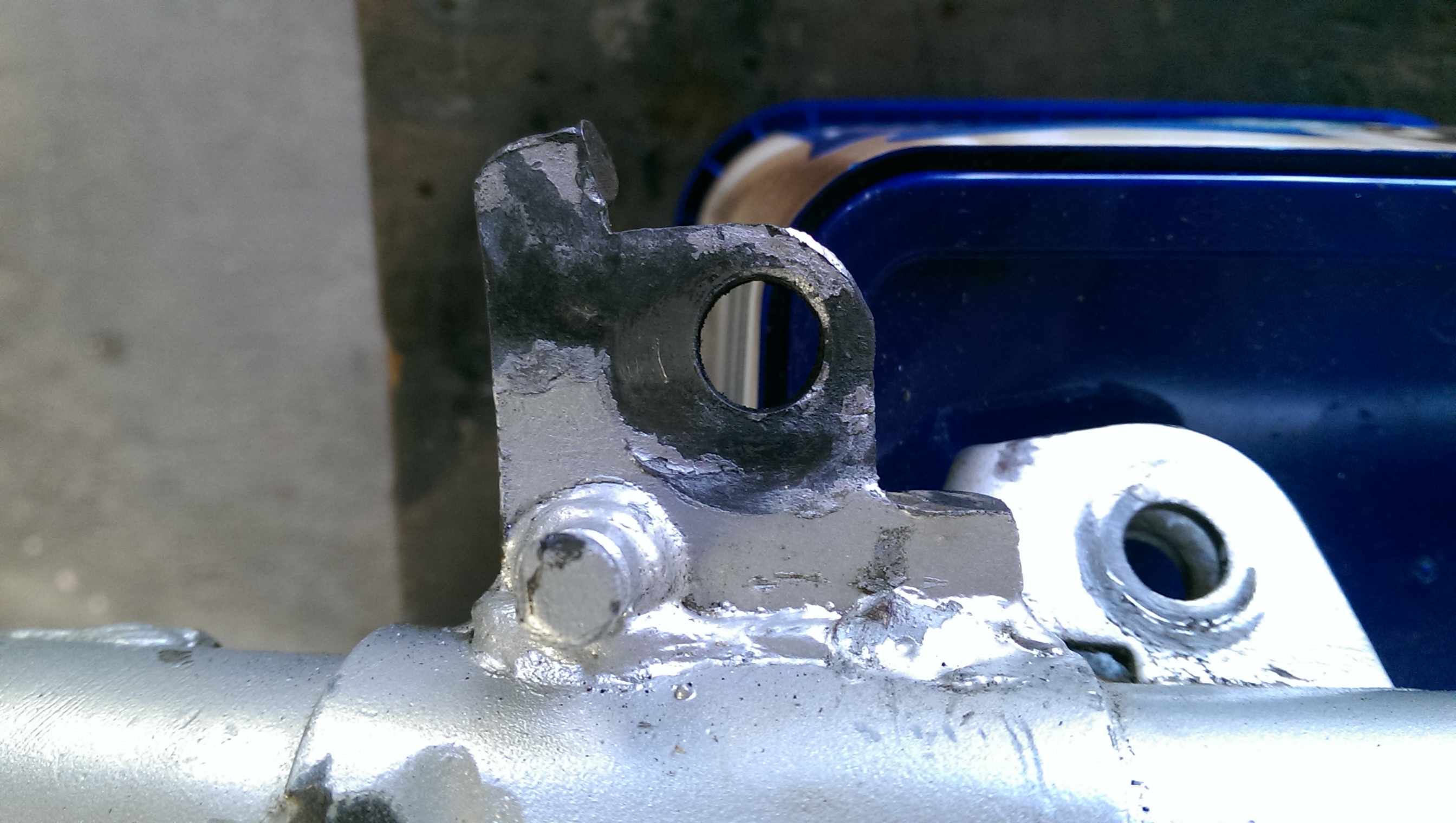

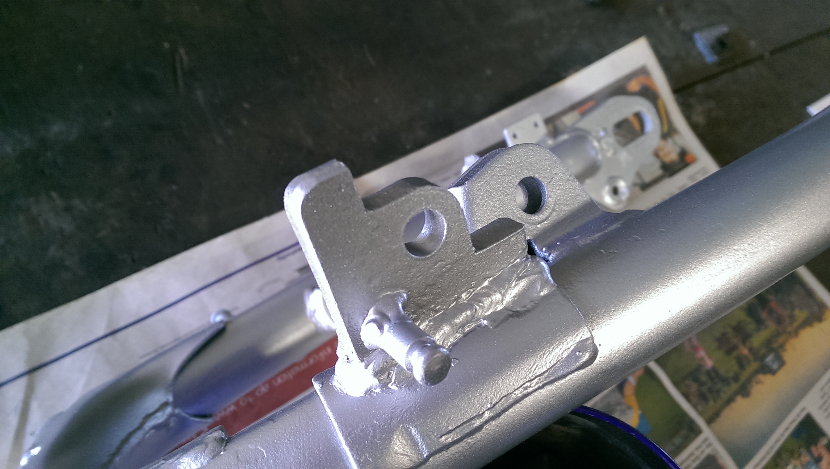

TY250 swingarm refurb
While waiting for the parts to arrive from the UK to replace the failed needle roller swingarm pivot setup with the normal plastic bushes in a :yamaha TY250D swingarm, I thought I'd give the swingarm a birthday.
The stand mount looked original but close to breaking:

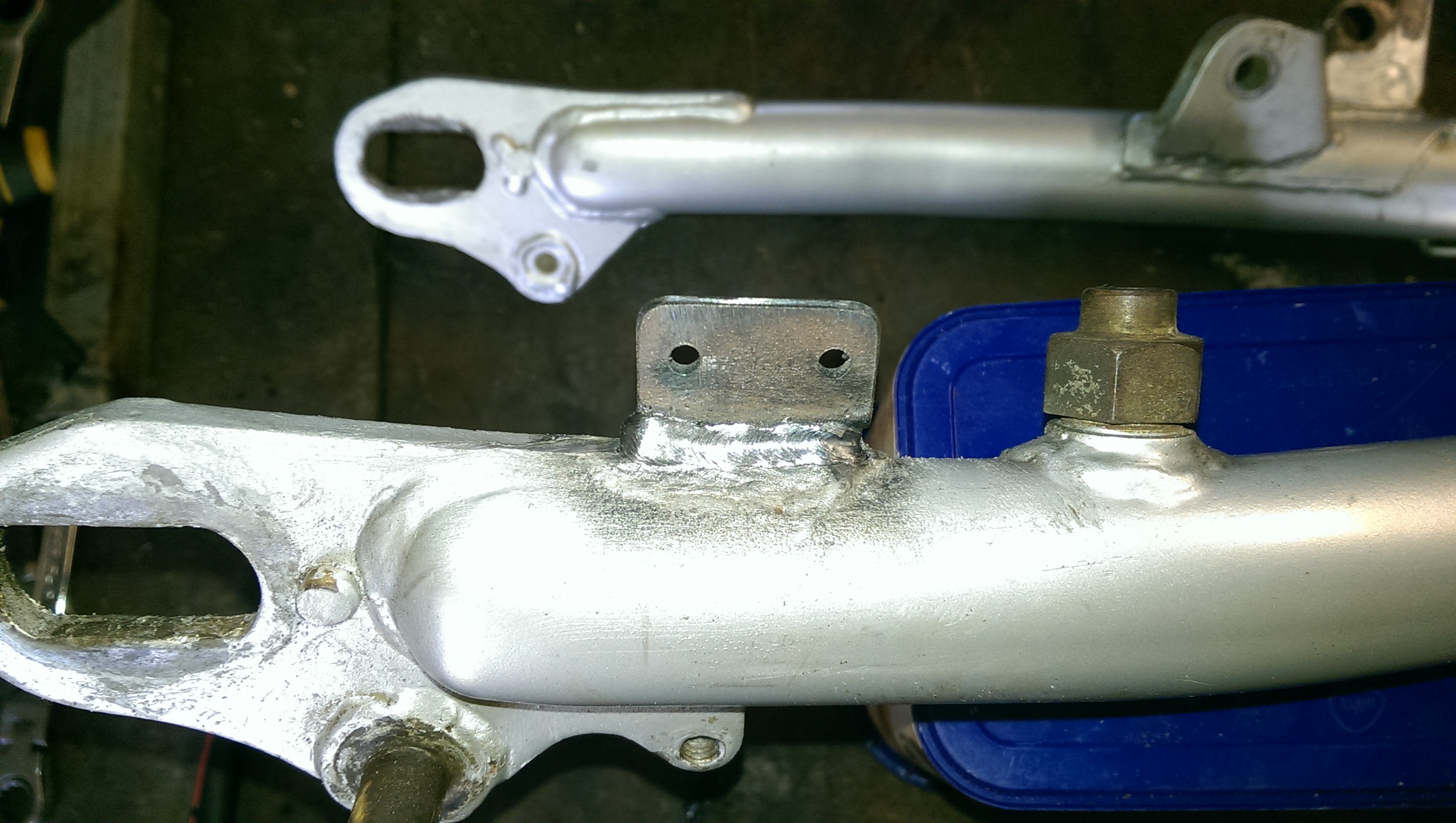

I also added a tab for mounting a sprocket guard:
All ready for the new bushes to go in.
I wonder if the new stand mount will last as long as the :yamaha mount did (42 years).
They do fairly commonly fail though and usually it is much earlier in the life of a TY250. I remember a teenage friend of small stature had a TY250A in about 1976 and the only way he could start it was to stand up on the pegs with the stand down, which must have given the stand mount a hammering. The other notable thing about that friend is that he rode it wearing thongs and I'm pretty sure it would have been in bare feet if the TY250 had been less wicked for a small, light person to kickstart. On the A model, the stand mount is on the frame and tends to stick out a bit, catching on things during crashes and even in sections so they used to break off even sooner than the stands on the later models.

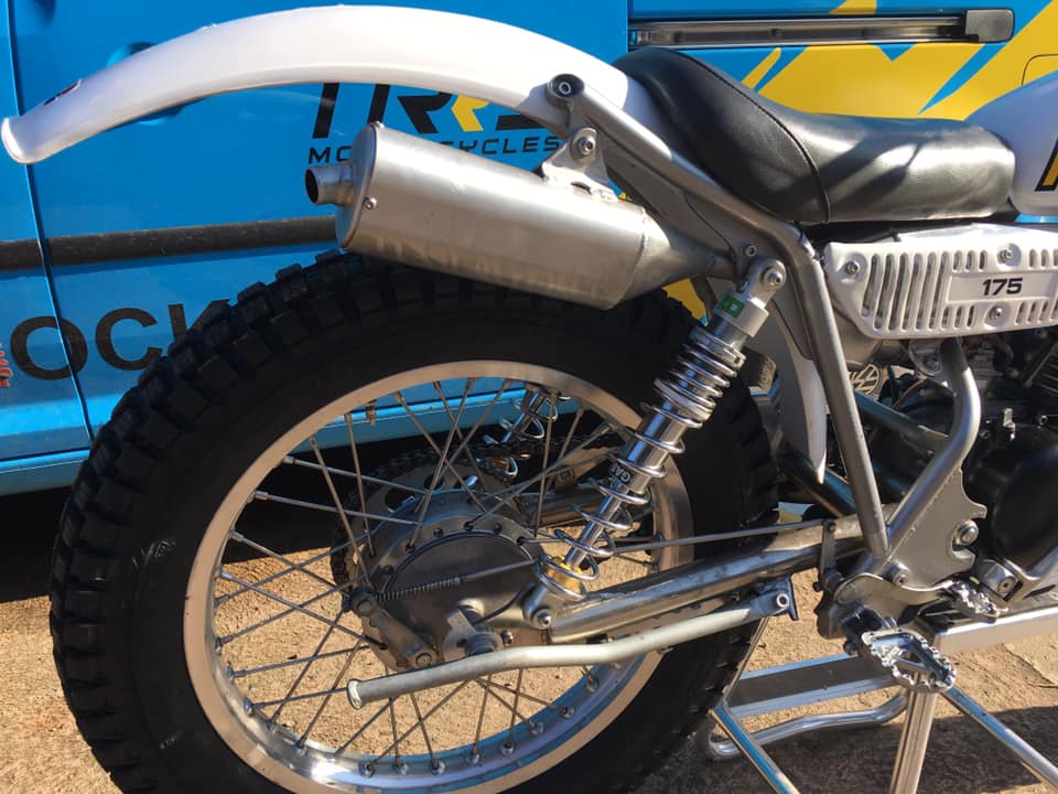

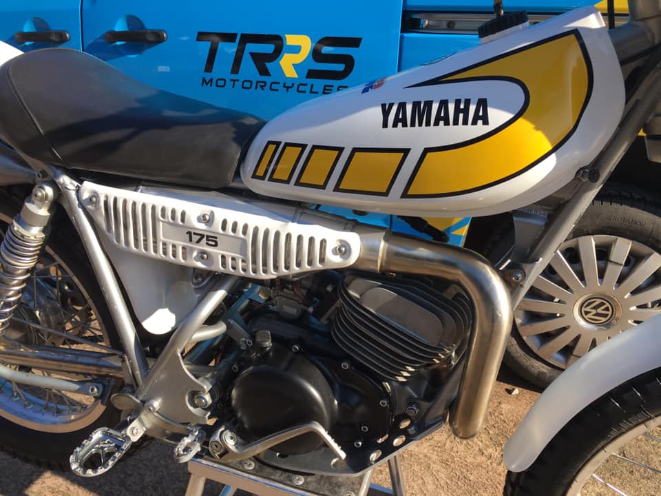

TY175 kickstart option
There is a very interesting looking TY175-based bike advertised for sale on facebook. Amongst other things it has an interesting custom made frame, but the thing that really caught my eye was the kickstart. I hadn't thought of doing it this way

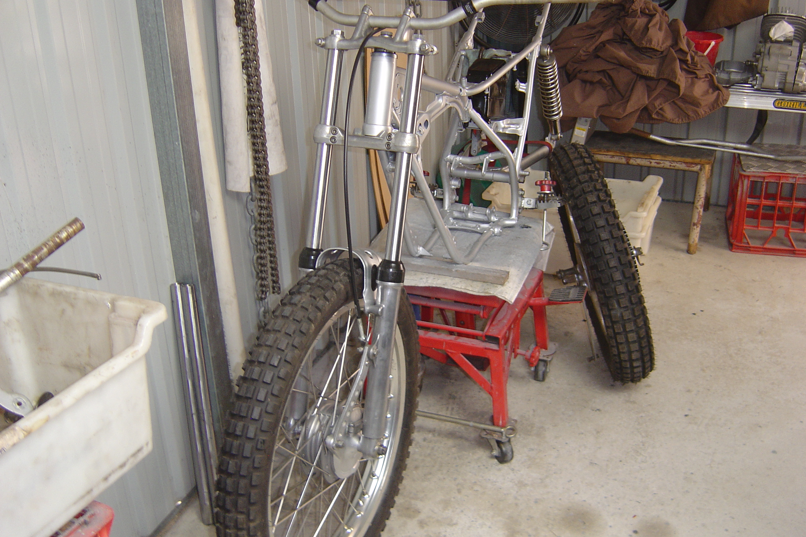

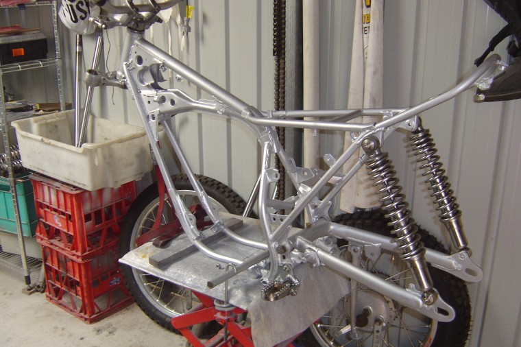

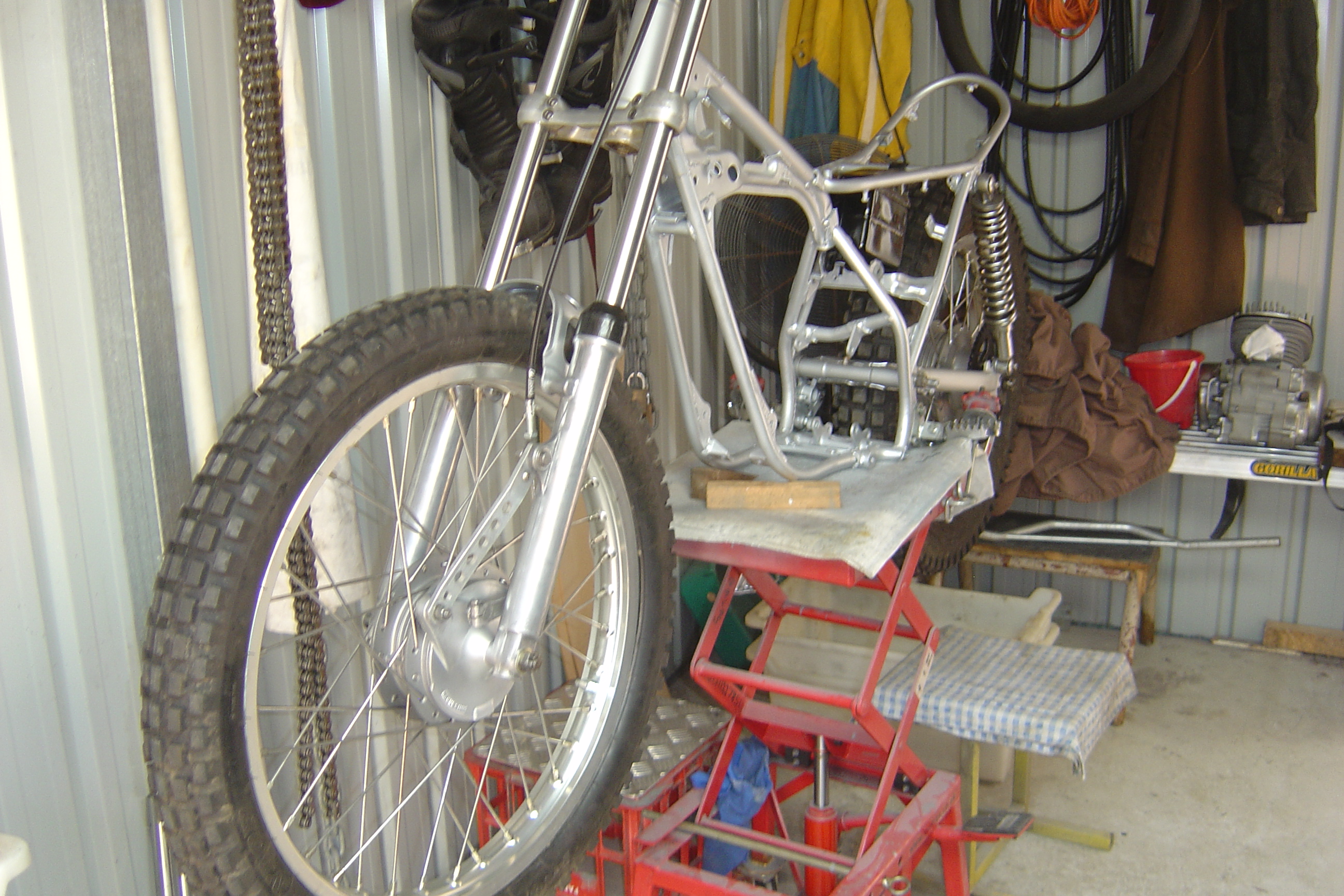

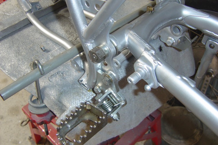

I have added a couple more pics, slow progress is being made if anyone is interested, forks and wheels in place
Here's the start of my new bike, from a total basket case to what I hope will be a nice finished product in a few weeks time, the only original items on it will be the engine (with mods) and the frame ,,,,, which are matching numbers.
I'm not able to ride at the moment due to Carpal Tunnel surgery a couple of weeks ago so its back into the shed and get on with the new project.
I was lucky with my side stand its still good, 45 years later.
