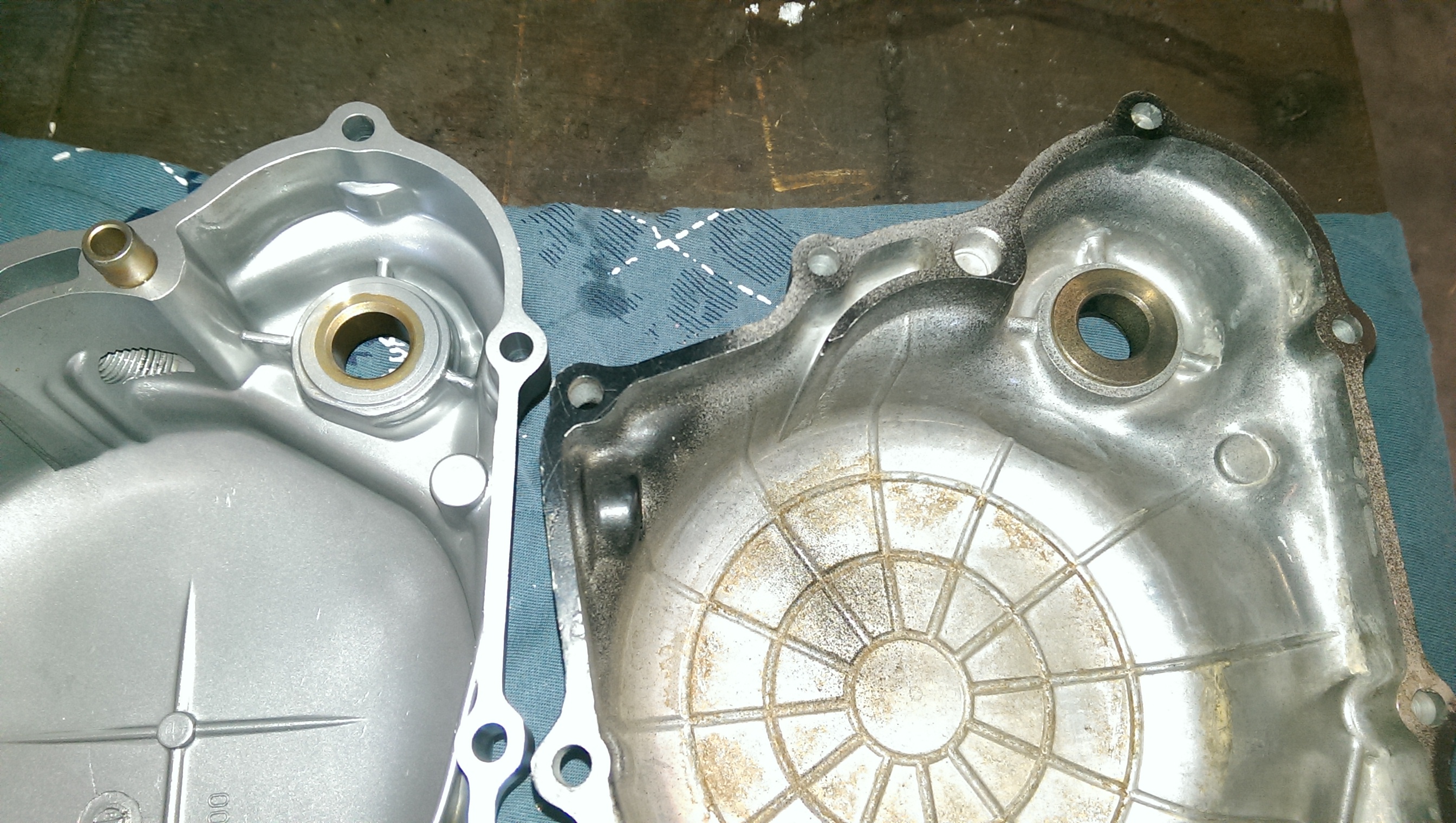

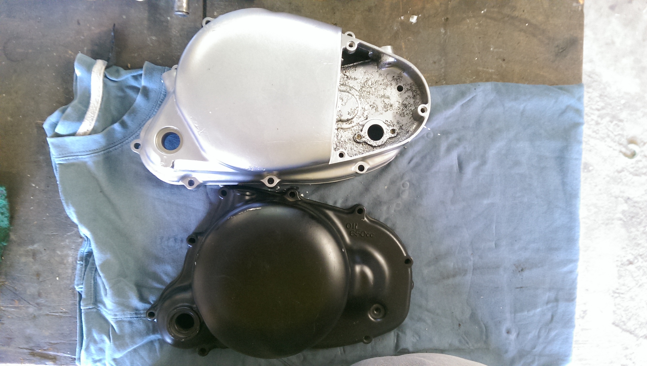

David, I'm not familiar with the 175, but do you think the casing be strong enough not to crack with the strain put on the kickstart so far away ?
Guy
Guy53 wrote:David, I'm not familiar with the 175, but do you think the casing be strong enough not to crack with the strain put on the kickstart so far away ?
Guy
Yes I think it would be fine. The casing has a wide steel bush for the kick shaft and the kick shaft is relatively large diameter and well made. The return stop on the kick shaft sometimes slips but this modification would not increase the load on the stop. The photos don't show enough to be certain, but this modification may even prevent the casing being damaged if the return stop does slip.
Re: TY175 kickstart option
David Lahey wrote:There is a very interesting looking TY175-based bike advertised for sale on facebook. Amongst other things it has an interesting custom made frame, but the thing that really caught my eye was the kickstart. I hadn't thought of doing it this way
Guy here are photos of a standard
TY175 clutch cover and the YZ125C clutch cover that is fitted to the TY175 with the extended kickstart shaft in my previous photos. The cover on the bike with the extended shaft also has a steel bush but it has a shoulder on the inside, which I figure probably makes it even stronger.Sorry Greg Harding the silver platter from Chippy hasn't turned up yet so the background is an old shirt and my bike bench. surely that's a bit better than PFFFT! newspaper?

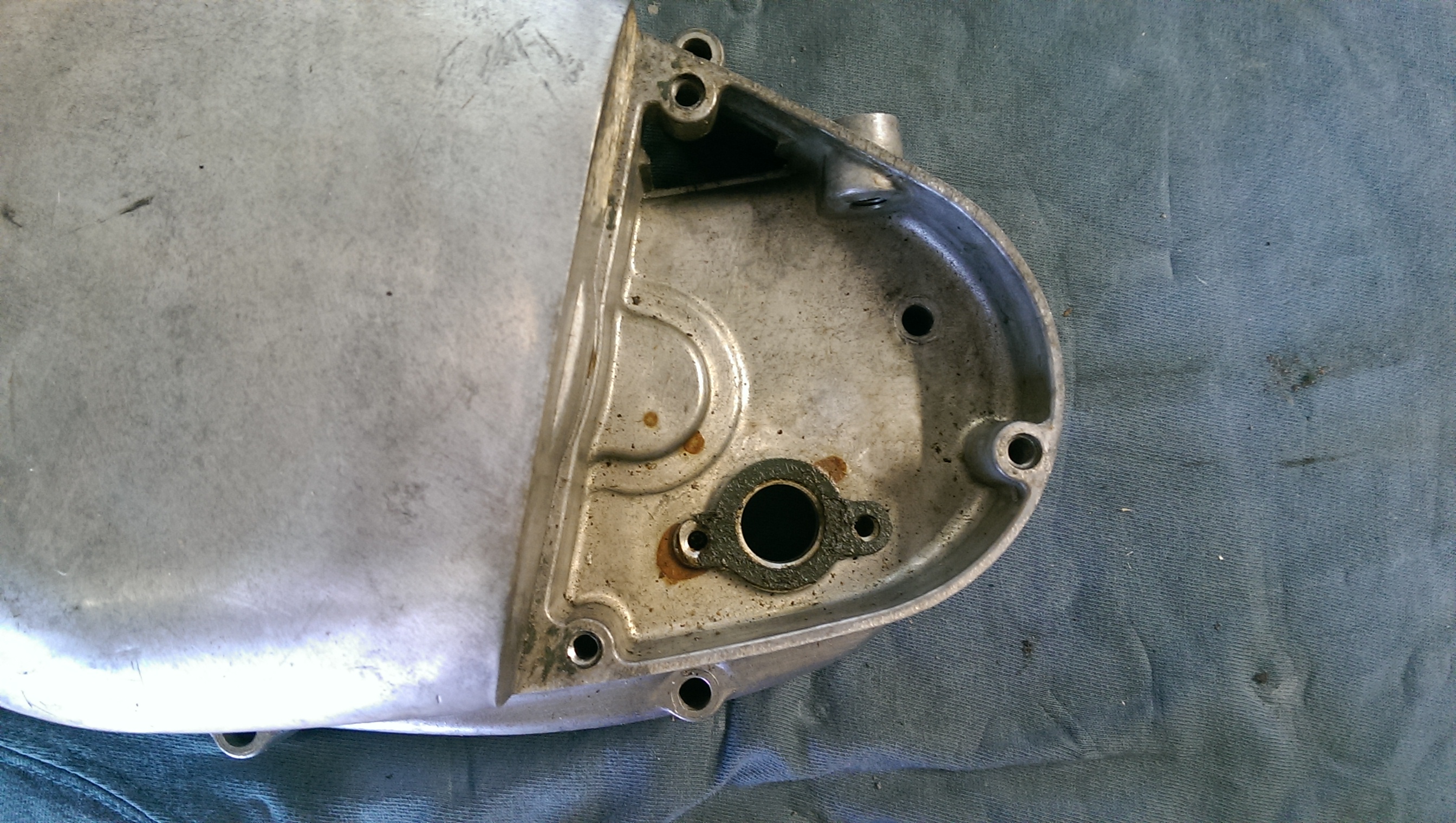

TY Yamaha clutch cover oil pump hole
When you remove the oil pump from a TY250 or 175, you need to seal off the hole somehow. On many bikes now, I've made a small flat aluminium plate and a gasket and held it on using the screw holes that normally hold the pump on. The photo shows a TY175 cover that has had the oil pump removed and part of the gasket is still there.
A few weeks ago I bought a TY175 clutch cover and whoever had removed the oil pump from it had blanked the hole much more simply than the flat piece of aluminium method. They had simply fitted a 14mm welsh plug into the hole. Welsh plugs are readily available and pretty cheap.

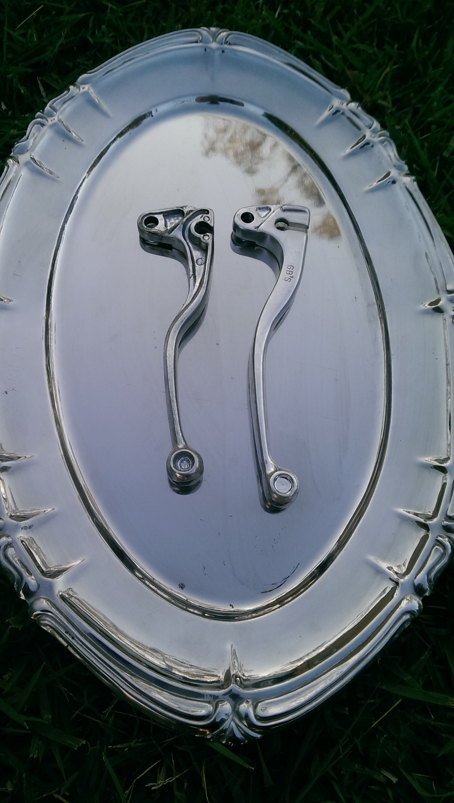

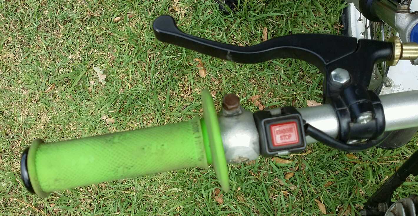

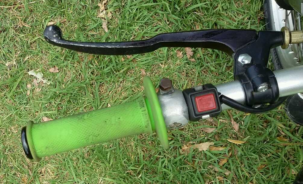

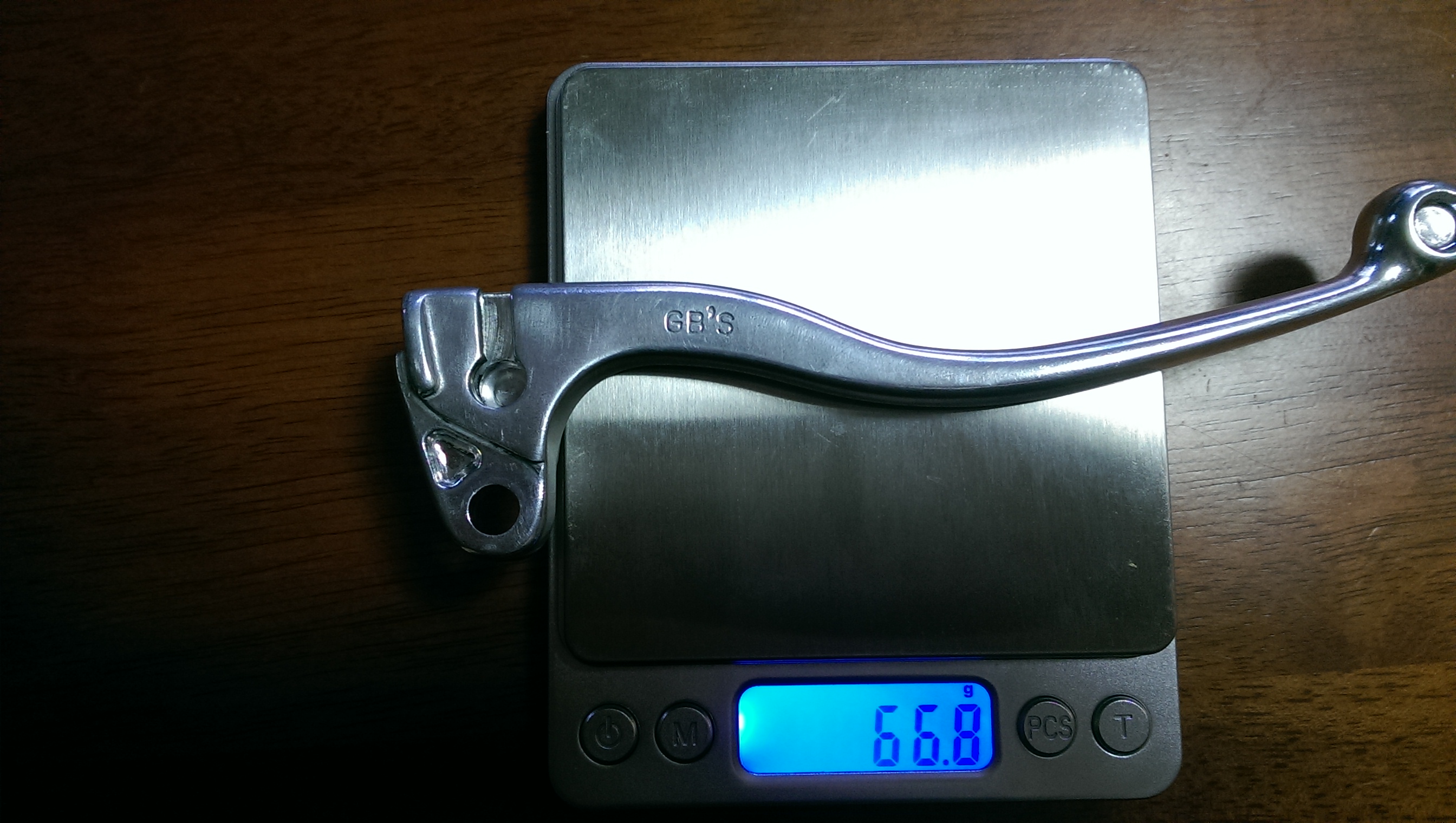

KT250 clutch pull
This photo illustrates one the top secret things I'm doing in preparation for the
KT250 clutch pull competition with Greg Harding and Chippy and anyone else silly enough to join us.The clutch lever with GB's on it has the holes 20mm apart and the other one from a
RM80X has the holes 30mm apart.How wonderful it is also to be able to see a reflection of the wonderful western evening sky at Wurdong Heights, by courtesy of a suitable receptacle that appeared in our mail delivery today. Thankyou Chippy.

So David, can I enter my Sherpa in this clutch pull competition? There is a big difference between those two levers. I know which one I`d prefer. That`s why I still stick with the Amals on all of my
s. Much better leverage.
s. Much better leverage.- Greg Harding

Clutch lever selection

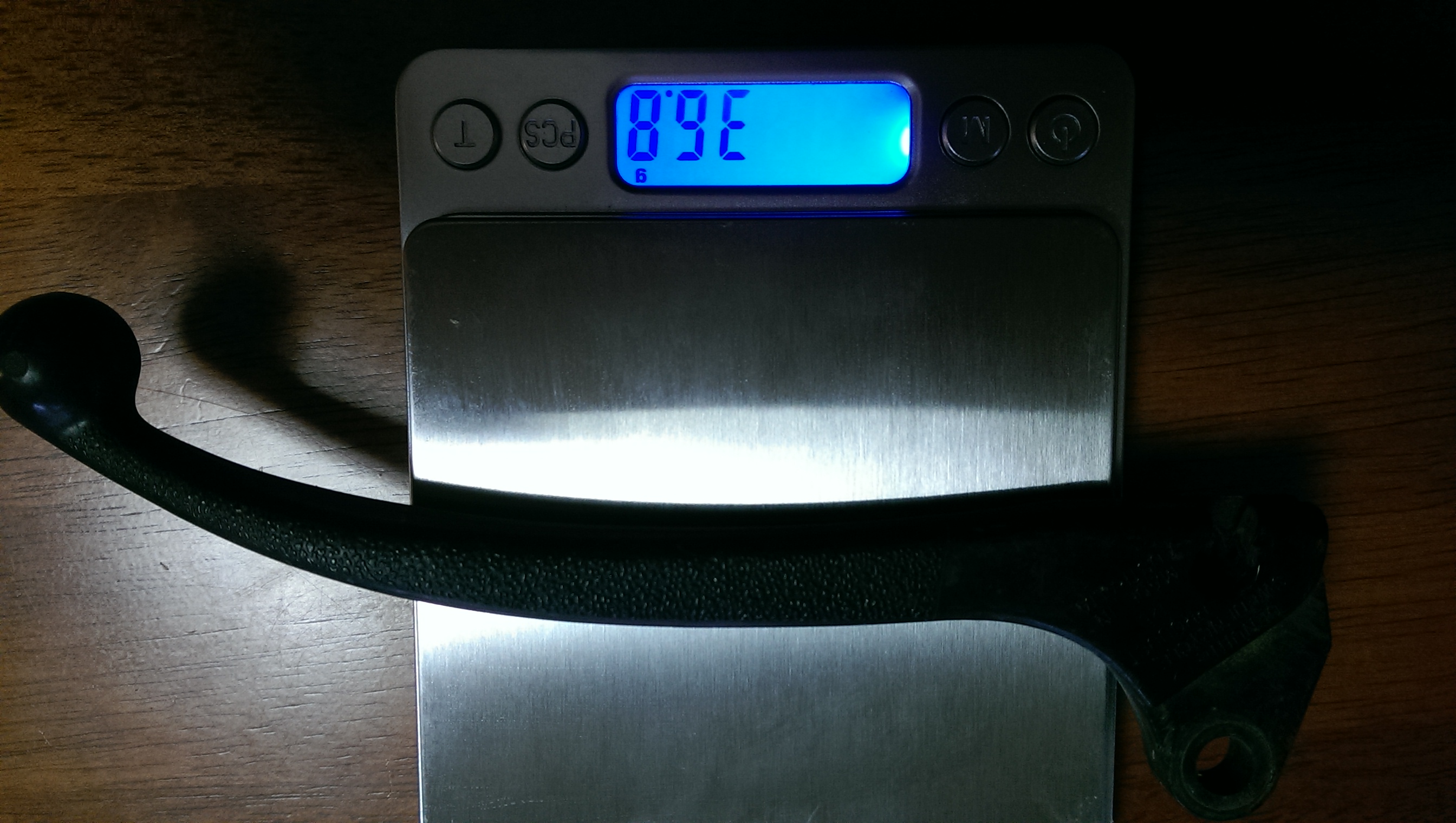

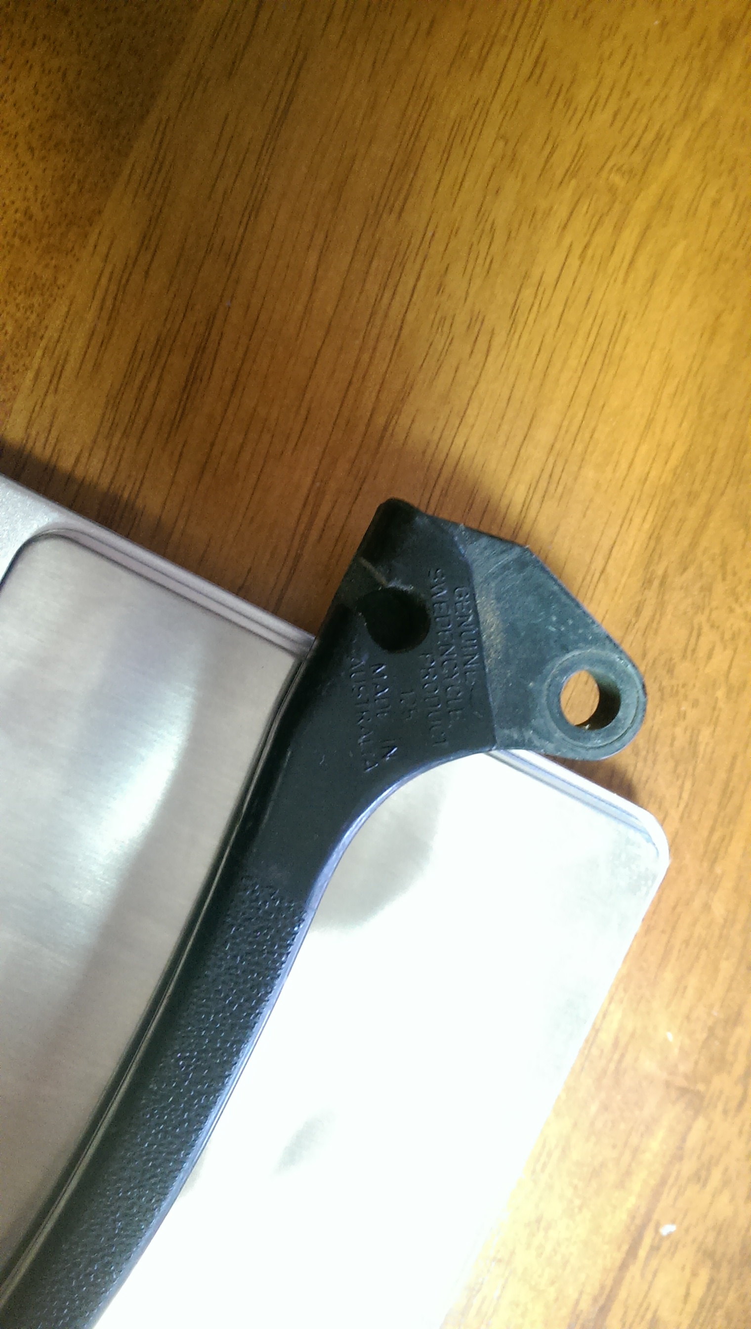

While we are considering the design of clutch levers, surely a lighter clutch lever would improve the steering of a trials bike by reducing the moment of inertia of the front end.
This wonderful Australian product from the 1970s sold in huge numbers for a while and lived up to the promise of being unbreakable, which was important from what I remember of riding in the 1970s I seemed to think it was a good day if I only crashed a few dozen times attempting some monster hillclimb.
So if it only weighs about half of what a beautiful Ballard's lever weighs, why did we go back to using aluminium alloy levers?

Plastic levers, didn't they suck. No feel, too flexible.
I put up with them for over a year on my Cota 123 in the '70s because my Dad couldn't afford amal levers and perches as fitted to Bully's. I'm left mentally scarred for life by the experience, the original welded on jobs of the Cota 123 were better.

I can remember when the hot setup on any dirt bike was a set of plastic levers and some new hex grips! Both would have to be the worst things ever made I reckon. The hex grips were very big and not round and the plastic levers felt horrible and they broke very easily. I tried them both once for a very short time and then took them both off and threw them away!
