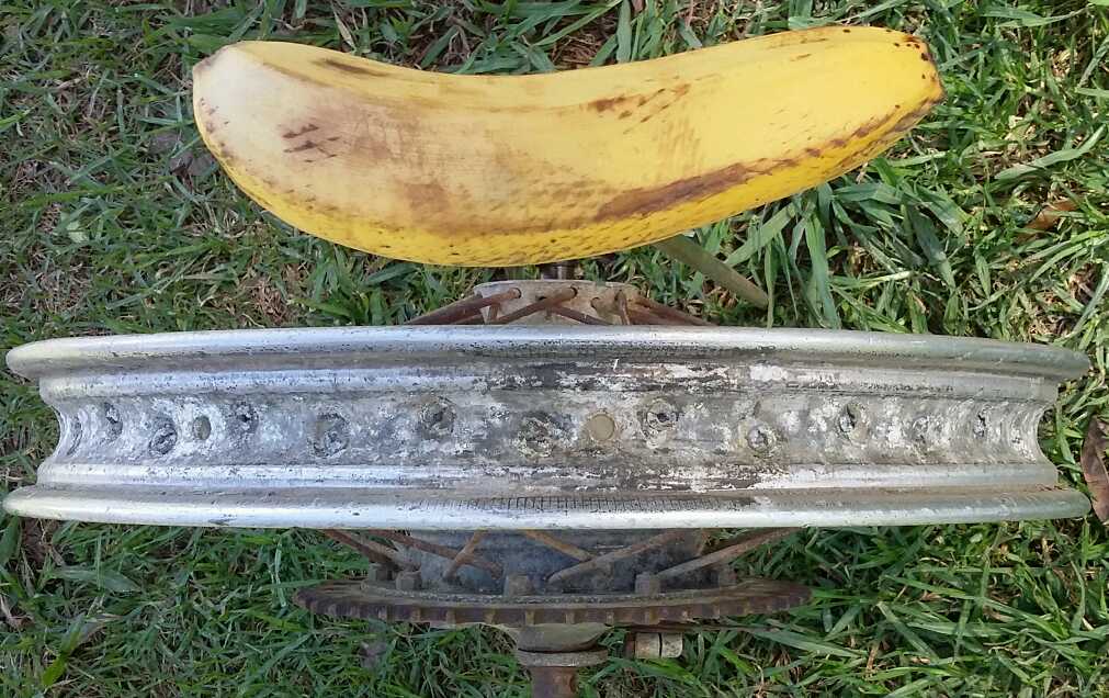

BIG Bultaco BANANA Wheels
Posted: Wed May 01, 2019 8:39 pm
David Lahey wrote:One thing I'm fairly confident of is that there would be at least 1 kg difference in weight between a post-1973 :Bultaco: Sherpa T complete rear wheel and a :kawasaki KT250 complete rear wheel. A fun comparison for a later date when I can reach my M198 back wheel
David, here is a :bultaco: M49 rear wheel assembly, I think the same as M80 :
And here is a :bultaco: M198 rear wheel assembly at about 2/3rd the weight:
Today is the Inaugural National Banana Day so Peel Good, Feel Good!
Is it just me or do the offset hub/unbalanced :bultaco: wheels look like they are Banana shape?
Or have I just looked at TOO many Bananas :?:
