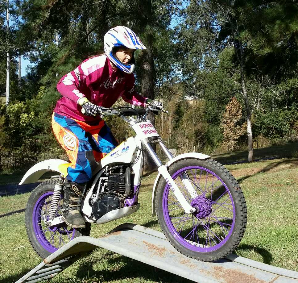

Just sharing another Aquision that I picked up a while ago, thank you Robert for the bike and thank you Barry for looking after it for a week and bringing to the next Trial for us.
For some reason I am attracted to one off specials that a little good old Aussie ingenuity has come into play, especially when it is like I have this so it is going on! The main reason I like this bike is the sum of parts rather than the complete bike and I did tell Robert we intended on raiding the ignition for Donna's :honda: TLM 200:
Now that I have had time to fix the aforementioned TLM, running beautifully by the way, there has been some other parts that have been mighty handy. My :honda: XL 185 had a very rusty/buckled front wheel and I am pretty sure that is where the front wheel came from so that solved another problem. The front brake cable and brake shoes were better as well so the XL is nice to ride again. There has been some swapping going on as well with a mate as he wanted the blue seat and the seat that came with the :honda: TL 125S:
And he also wanted the rear wheel of the TLM (Not sure what it was off?) and in exchange I got a TL 125 seat:
Not perfect but not rusty either:
Also and the best bit another TL 125S motor:
Seized but it has a nice unmolested Kickstart and spline, so we are both happy!
