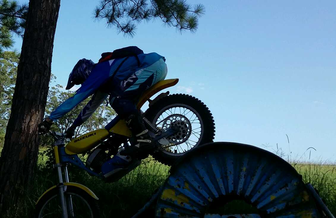

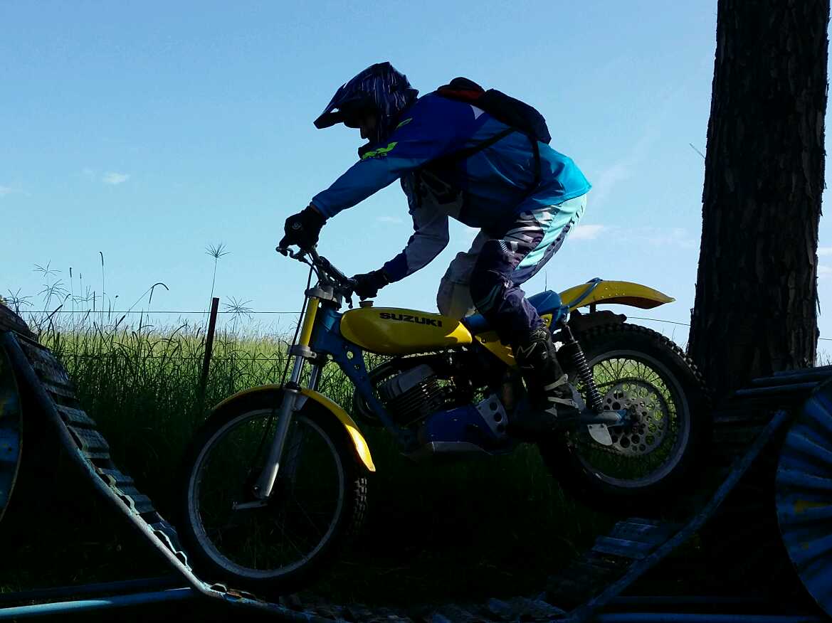

Very interesting Brent, back in 2015 I was using increments of 15 mm and in 2020 you are using increments of 20 mm! Excellent explanation photos with great depiction, you certainly have an eye for detail! There is a fair bit of effort that goes into these modifications, a lot more than I think most people realize. All this time I thought I had the patent on adding random flatbar/ plate to the bottom of saw horses to take out the rock? You have reminded me about the Ups and Downs of modifying bikes......
You have stimulated me to ride the SQUEAMISH for the last 3 weekends and I am loving it. The creeks where we have been riding are all flowing beautifully, crystal clear with a rocky bottom. There has been enough water to flush all of the gullies and rearrange all of the logs opening up new lines to ride.
Just for you Brent, hopefully some motivation :
