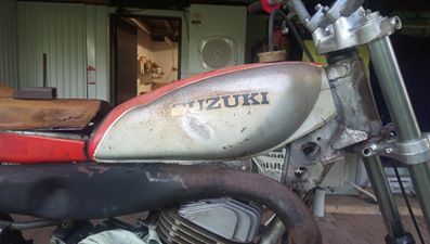

The front of the tank has been trimmed and needs to be radiused and welded. The tank was too long since the frame has been shortened by 35mm between the front and rear tank mounts. I haven't changed the mounts on the tank but have moved the mount on the frame forward. While I can weld the tank easily I'm not prepared to take the chance as I don't know when it had fuel in it last or what residue may be left in it. It also weighs about twice as much as it should. Off to the tanker repair place this week.

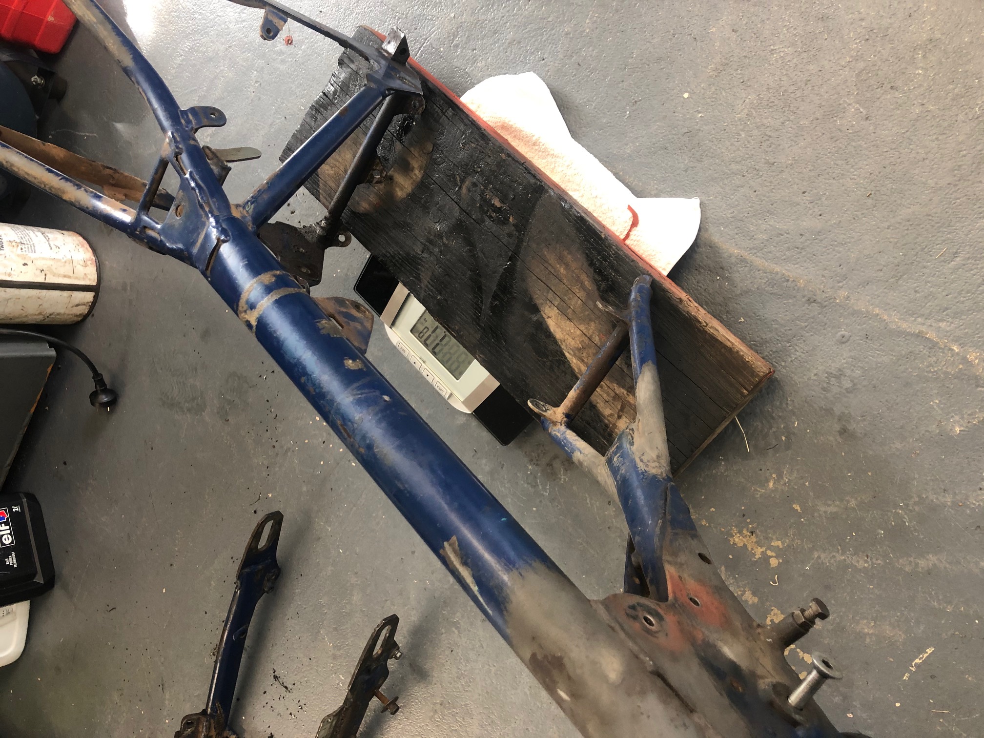

To Indulge Greg, Here is the SWM TL320 bare frame weight. 7.7Kg on the scales.
I'm in the process of giving the blonde cougar a well deserved facelift.
