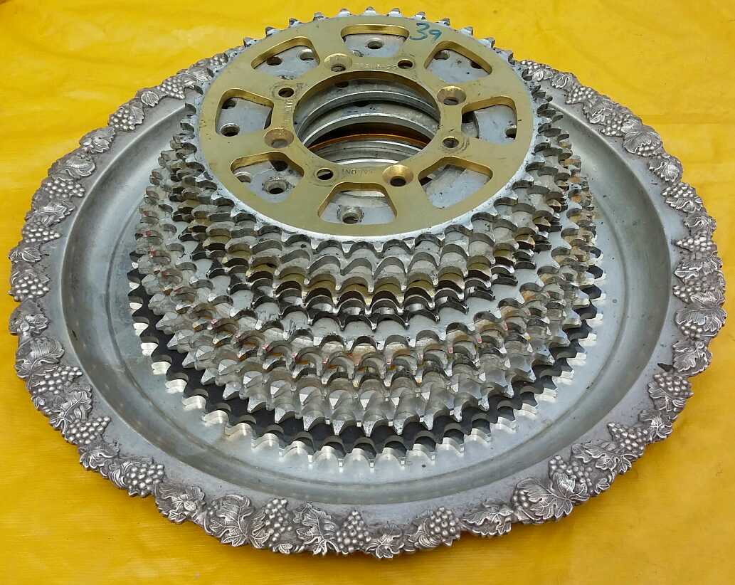

Brent, can I add to your list as I am not sure where you are up to with regards to gearing and shock length? Are you going to choose 428 or 520 chain and sprockets? Just my opinion but 520 is my first choice on any 200 or bigger as there are less pivots to wear out. Working out final drive ratios and shock lengths will give you an idea where the chain will be in relation to swingarm pivot at all points through travel and that is fairly critical. The SQUEAMISH has 54T and 11T 520 chain which is about the right ratio for me as it gives me a hard to stall 1st gear for picking my way through tight/rough stuff. When it is a bit short like when punching up something, I simply use 2nd. As you know, the lower the final drive ratio, the closer the gears become and gearing is a personal choice thing like pretty much all of the variables! The shocks are 358 mm between centre's NJB Trik shocks and I am Very happy with them!
Another thing that I have learnt is IF you buy a good quality chain and look after it, you rarely need to adjust the chain tension which is helpful to know when you are setting up a bike. CZ chains used to be my first choice (Hello Geoff) as they have/had holes punched in the inside plates and flat on top and bottom that ran really smoothly over the chain tensioner. However the importer stopped bringing them in and my supply dried up unless someone else knows where I could but them now? So what I am saying is if you work out ratios, chain type and shock length, you can fairly accurately predict where the axle will be, remembering that half link chains are available.
As for the brake stay/anchor arm, it is something that I have played with as well and some of my bikes have 2 as I found the second attempt can work better. Not so critical on a :suzuki as it uses an inner/outer cable so there is no variation of pedal height through travel.
Here is a photo of my spare 520 sprockets, 39T to 55 T:
Yeah I know, Government cutbacks so only 1 photo!
