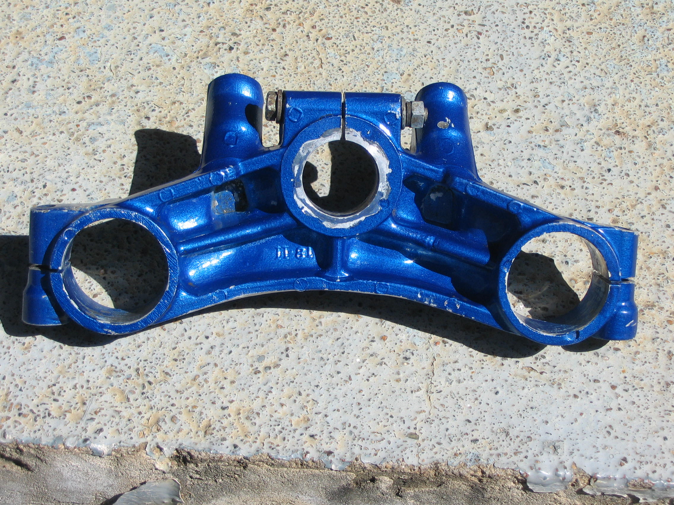

I wonder if you emailed Pernod Ricard if they would tell you what their blue colour code is?
I think others on Trials Central had gone down that 'Pernod Ricard' path but to no avail.

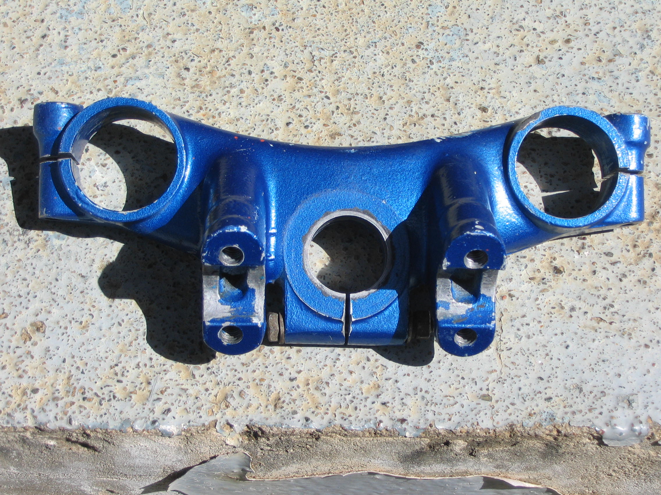

My Jumbo has been painted in a much paler blue than what I knew it should be, but I had none of the original darker blue anywhere on the bike to use as a guide.
So I searched eBay for ages looking for any part in the original blue when a set of 38mm forks complete with the blue triple clamps and mudguard stays came up, didn't need forks but bought them anyway cause they're so rare. Here's pics of the clamp showing that it does have a slight "metallic" to it.
It's got a hammertone look too or maybe its just the surface finish of the casting showing through

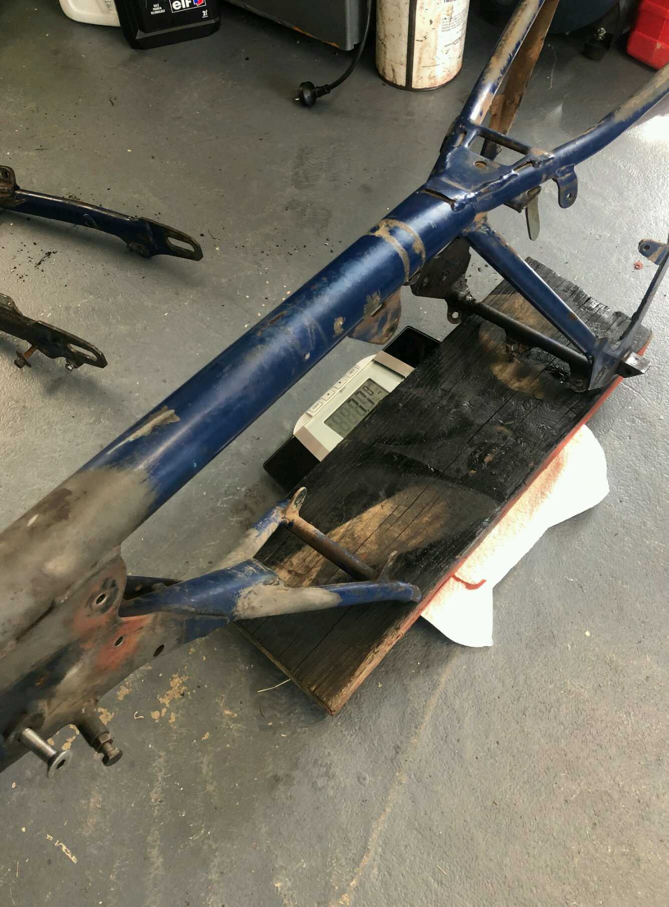

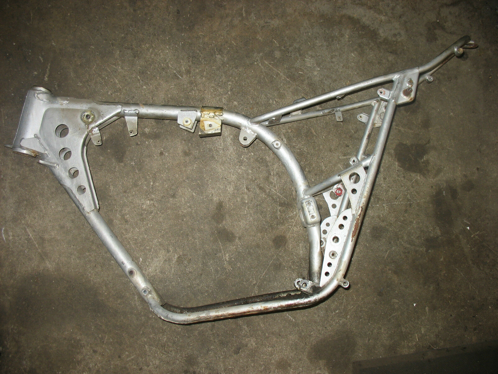

Kurt wrote:To Indulge Greg, Here is the SWM TL320 bare frame weight. 7.7Kg on the scales.

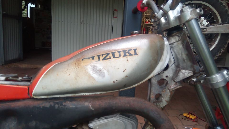

This is the final shape for the front of the tank. It's had about 30mm taken of the front. To the fuel tanker repair place this week to get it welded

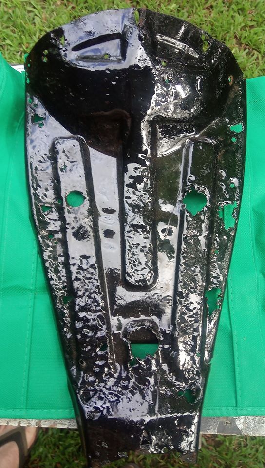

The seat base was very heavily rusted. I used rust converter and bead blasted it several times. This is the base with one coat of POR-15 paint applied. I repaired the seat base of my TS90MX the same way as I'll show for this one. Unfortunately I don't have "before" photos of either.

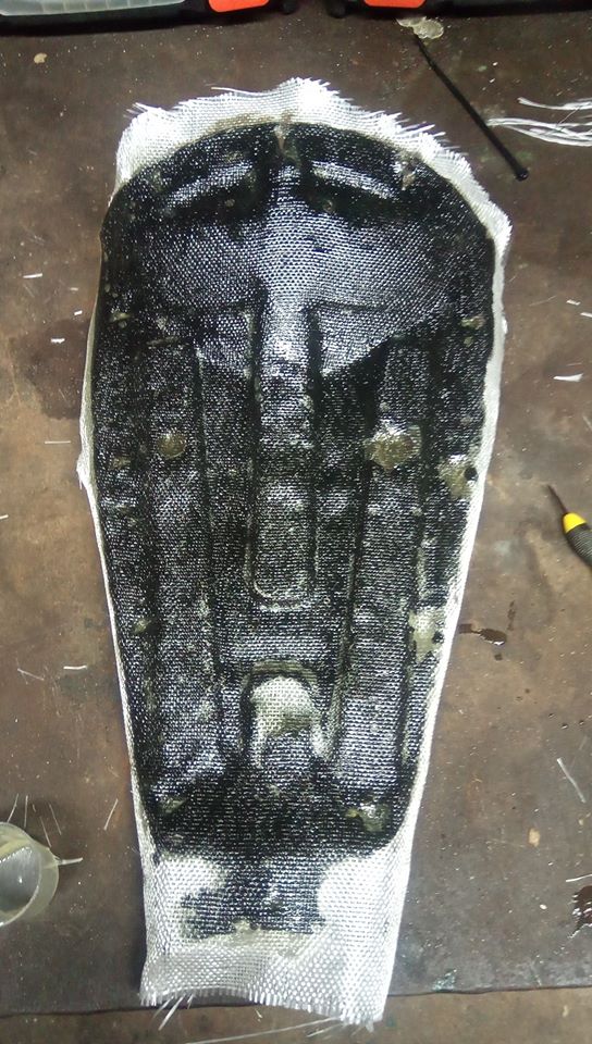

My repair starts with sanding the paint and a layer of fibre glass placed in top of the seat base. This is the first coat of resin, The next will be the front (lower part of the picture) and sticking down the edges

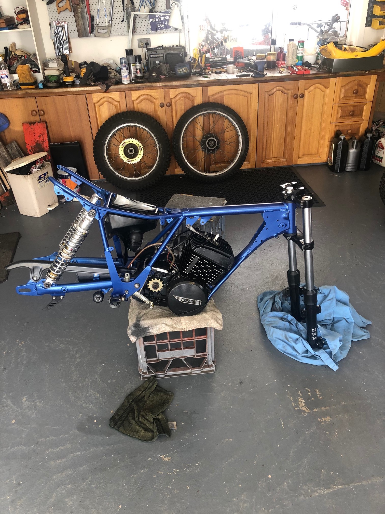

Blue Frame, Baby's got a Blue frame.
Like a clean Blue Suby, colour code O2C.
Rod - I'm happy with the colour, slightly darker than the original Blue but to steal a Bruce McAvaney expression it looks 'Special'.
Greg - If we add 3Kg of Swingarm to the 7.7Kg of Frame we get 10.7Kg total bare frame weight.
