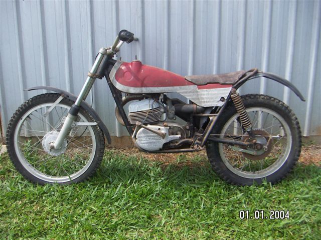

JC1 wrote:Then came an M80 Sherpa
This bike looks eerily familiar JC1
David, did you mean to post a pic of what the M80 looks like now?
JC1 wrote:David, did you mean to post a pic of what the M80 looks like now?
No it was meant to show your original posting from page 31 but didn't. I'll try again.
There's more than one way to skin a cat
I've only done measuring, comparing and looking inside the :Bultaco: M80 so far JC1 so no point doing photos yet. It was just that today Greg got me to look at the byzantine design rear brake mechanism on his :Bultaco: M49, also on page 31, and as soon as I saw your :Bultaco: M80 photos I recognised the bike.
The :Bultaco: M80 is not on the front burner. I was going to use the :Bultaco: M80 frame with the running gear from my M49 but I worked out that I would also have to replace the :Bultaco: M49 engine covers with later ones to fit it in that frame so decided to persevere with the series 1 :Bultaco: M49 frame. I've been doing a few things on it over the past weekend to make it easier to ride and am close to showing what I've been up to.

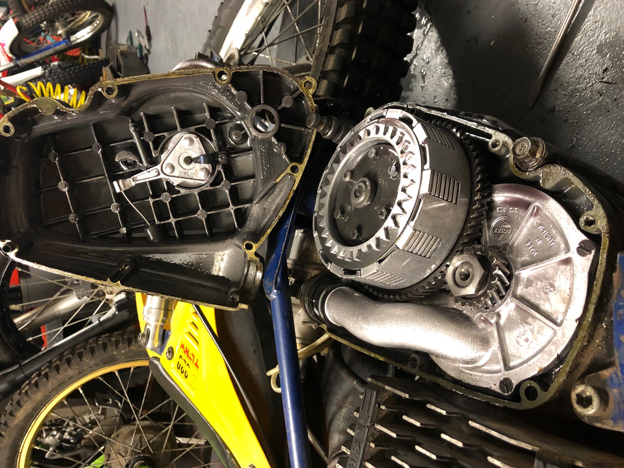

It would certainly be interesting how Earles forks would effect the handling of a motorcycle as it relates to trials.
A bit of a test for you, In the below photo there are four modifications to the mechanical function of the SWM from the standard trim.
IMG_0450 (1).jpg (962.28 KiB) Viewed 3834 times
I'm not an SWM person but I'm going to have a go Kurt
The arm on the clutch release mechanism has been lengthened.
Two of the clutch spring screws are different to the other four.
I'm still looking for two more things
TrialsRoss
Posts: 27
Joined: Mon Feb 29, 2016 3:22 pm
Club: CQTC
Bike: EM5.7 TY250
Post by TrialsRoss »
It looks to me like the return spring on the clutch actuation arm is an add-on. The metal filings on the clutch pack point to some rubbing perhaps.
