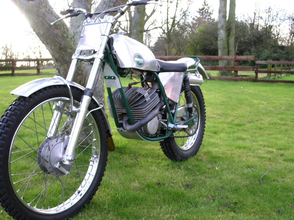

Here's a few of their Pathfinder. They tried to make one bike for Trials and Enduro with different seats, different footpeg and brake location, and a 1" longer swingarm for the Enduro.

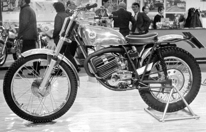

Show pic from the model's release

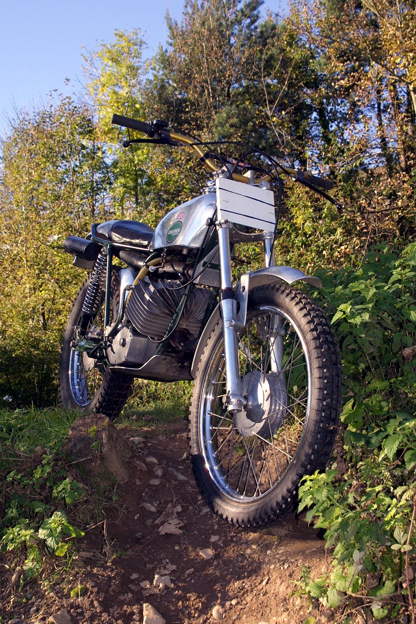

This last bike has non-standard exhaust and alloy sidecovers which improves the look somewhat

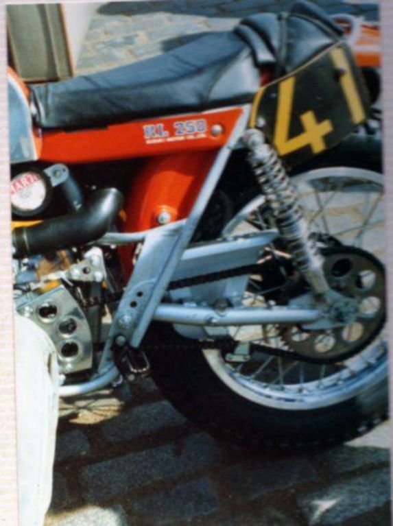

Back to RLs
Now that's a gusset!
Seems to be the bike Beamish entered in the SSDT in '76
(Taken from Beamish's personal collection on the Beamish site)

Looks remarkably like what comes standard on a Bultaco. They really should have made a closer copy of the Sherpa T

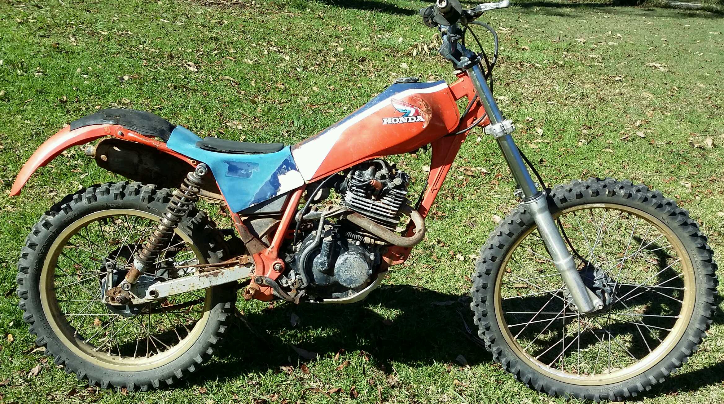

eagle
- Posts: 126
- Club: oakleigh
- Bike: honda tlr 250
- Location: Nyora

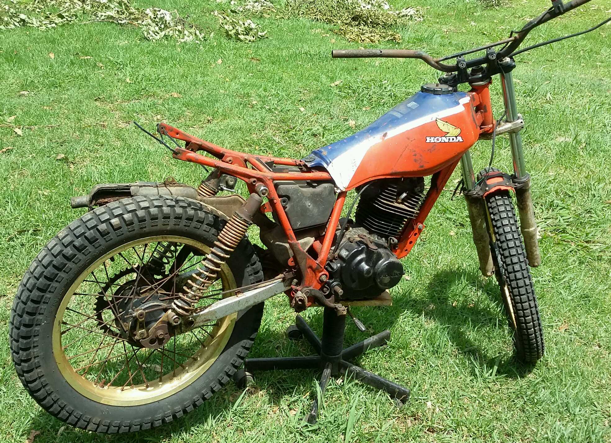

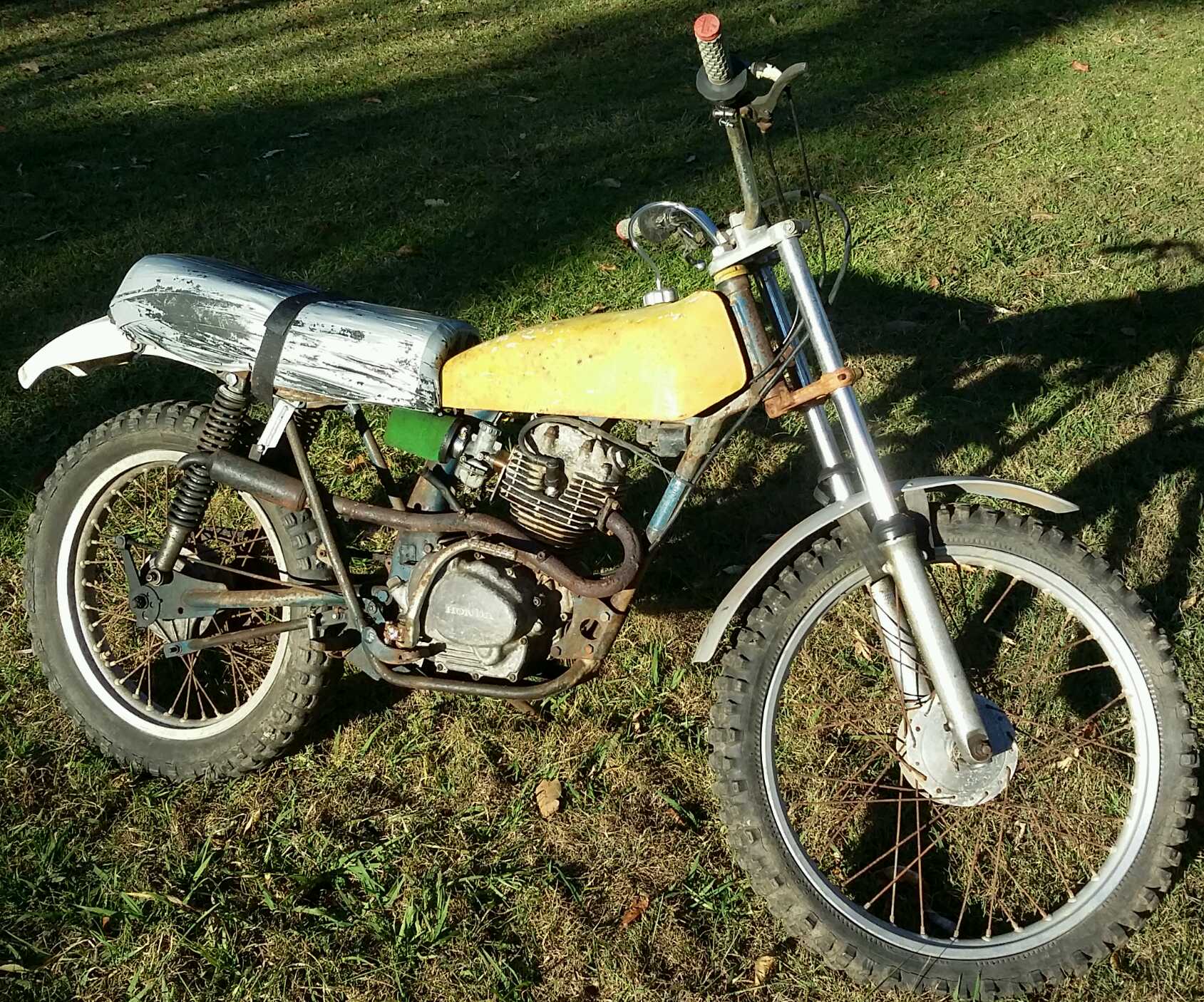

Do we have after shots of theses Honda ?
