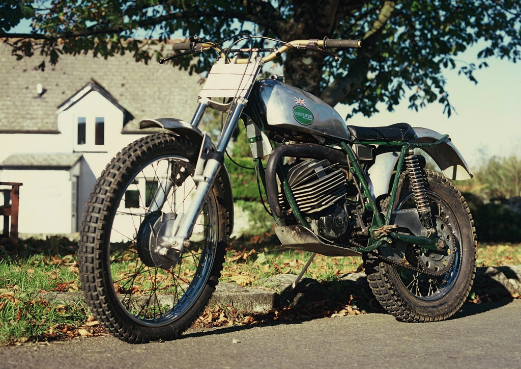

They look somewhat better with telescopics: the TJS
Greeves Anglian 24TJS, '68.jpg (277.54 KiB) Viewed 3309 times
