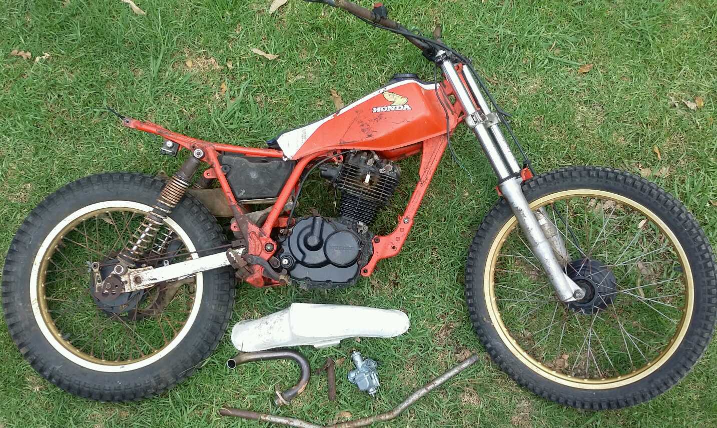

Eagle, do you mean you want photos from after I fix them? What I was asking is what do you get when you add them together? Here is some more photos of the 200 because I know you are a :honda: TLR man:
