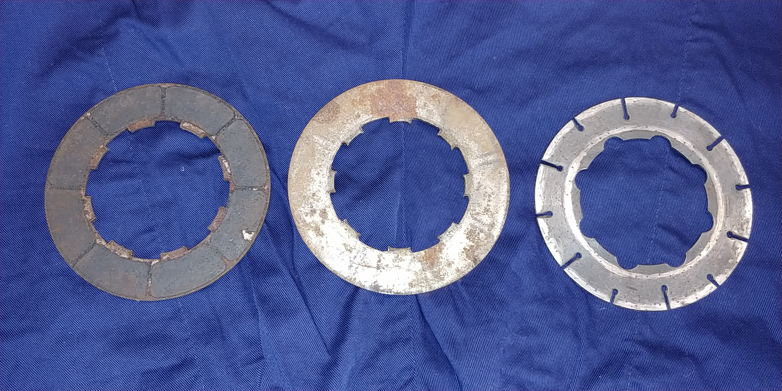

I haven't got that M49 motor out yet for a photo of the clutch but I did get out some old style friction bonded Bultaco clutch plates to illustrate what you were talking about.
Here are examples of different Bultaco drive plates. The late style (post 1970) are the plates with the JTJTJT slots in them

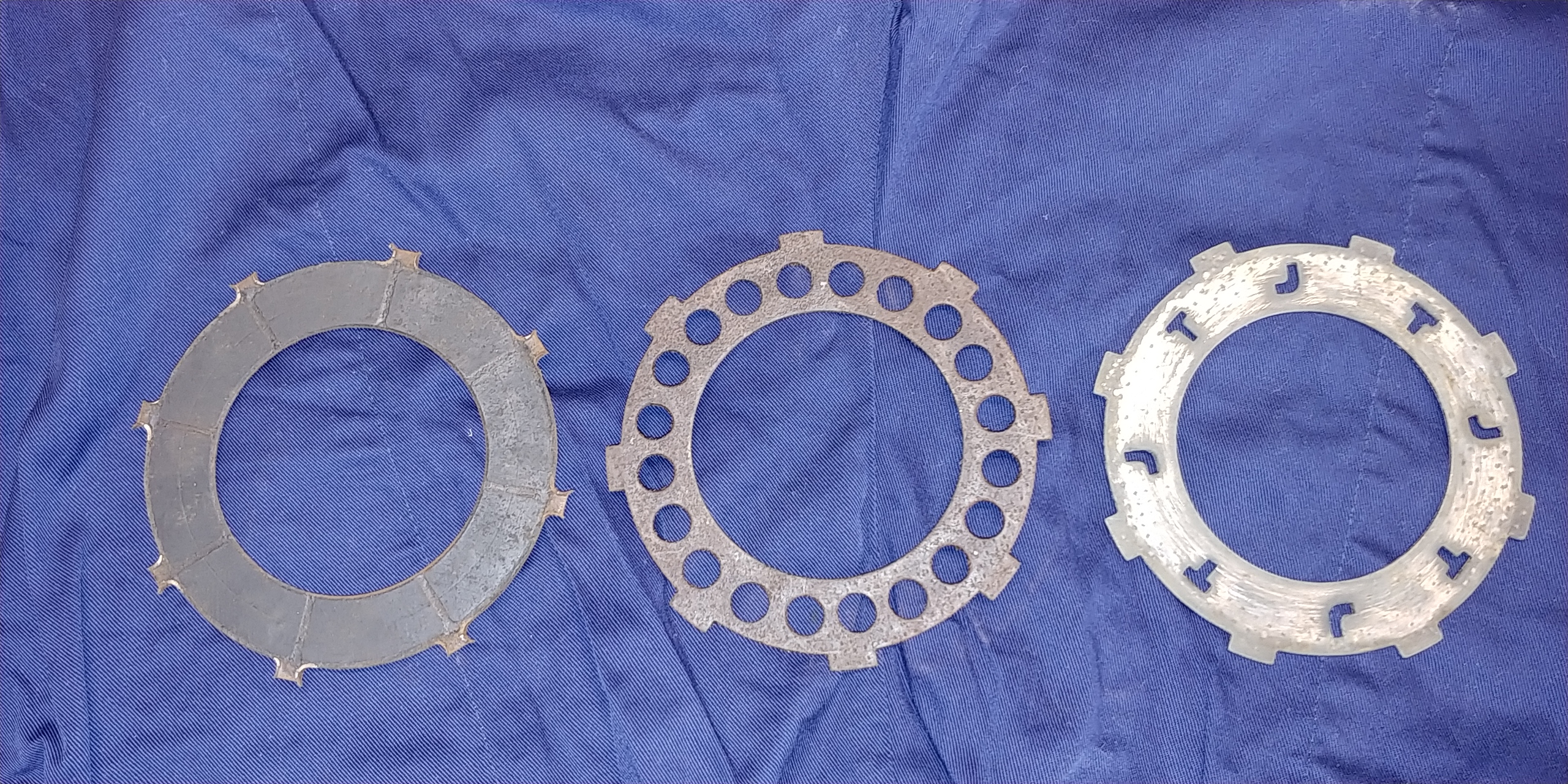

And here are the various types of Bultaco driven plates
