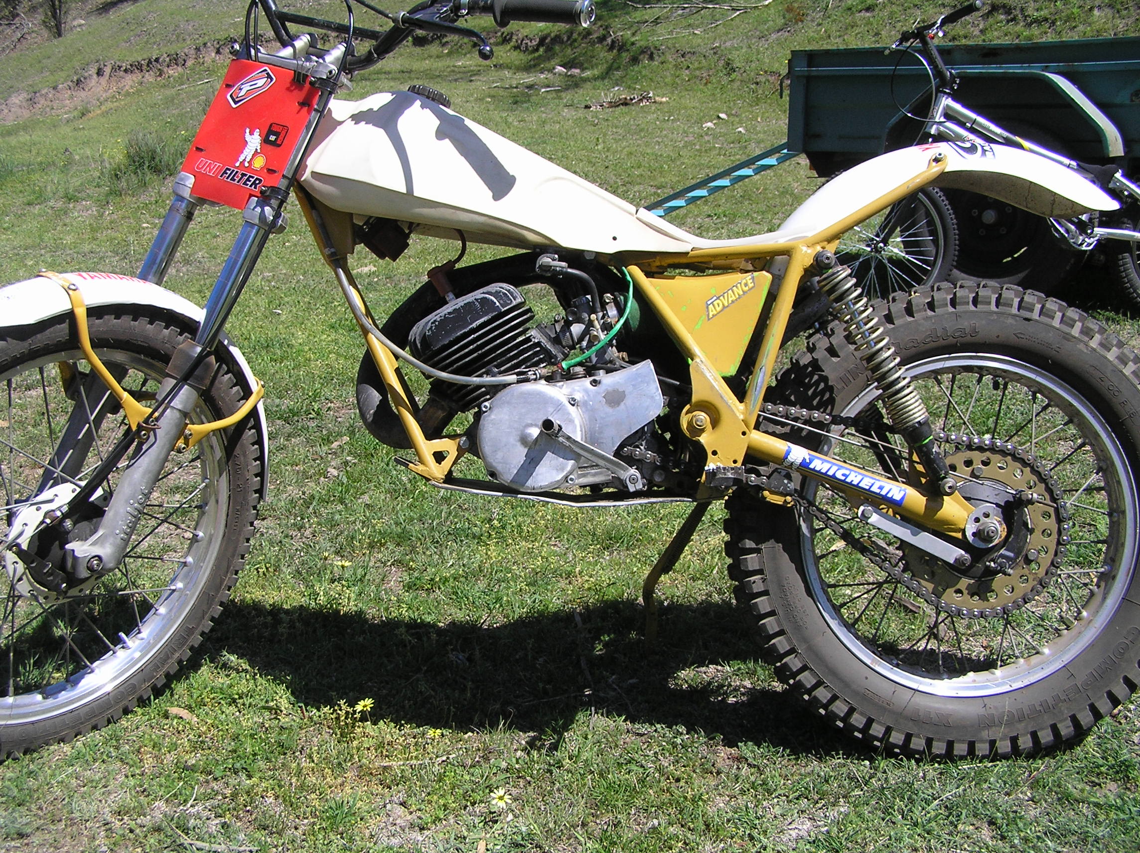

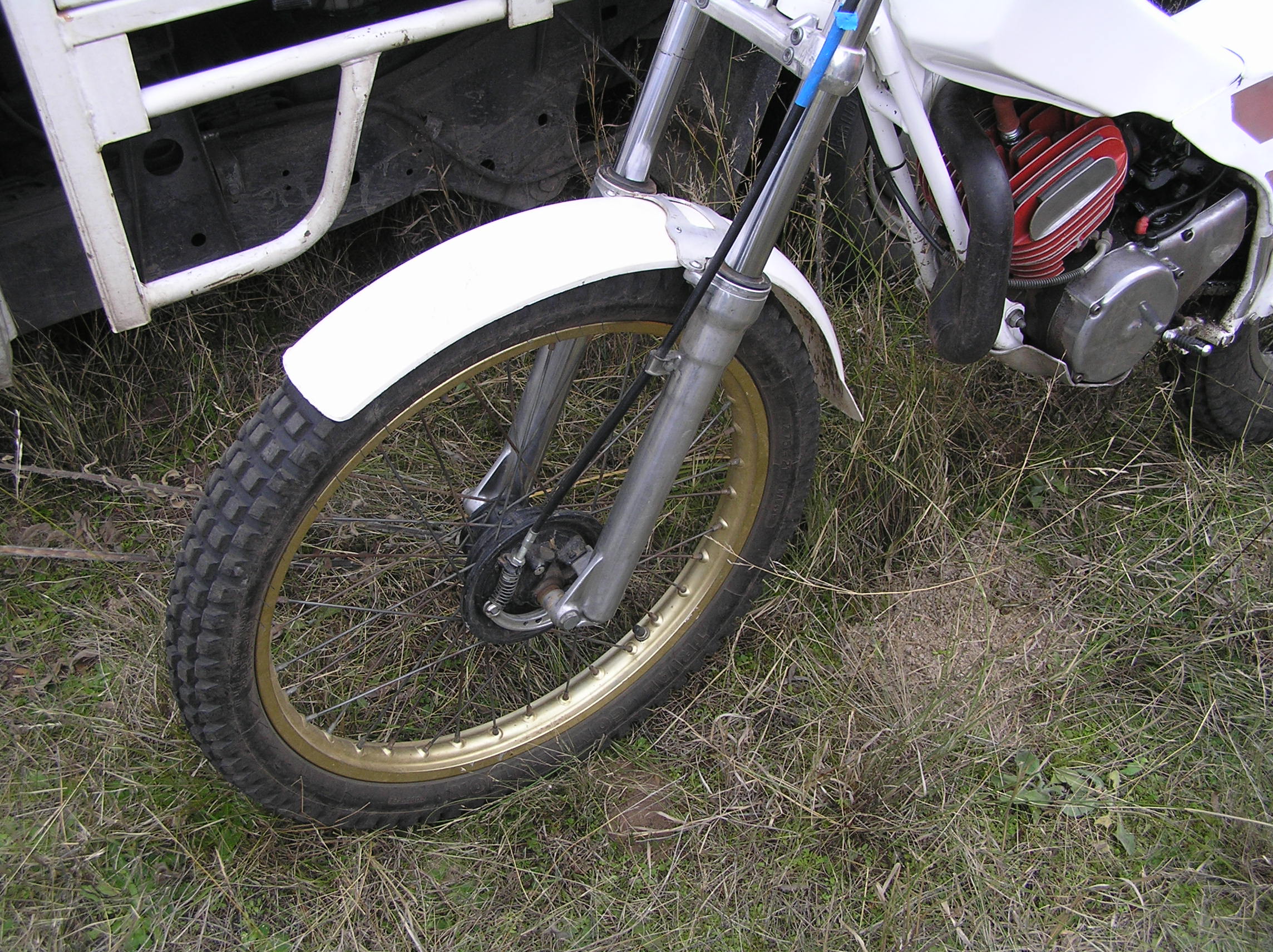

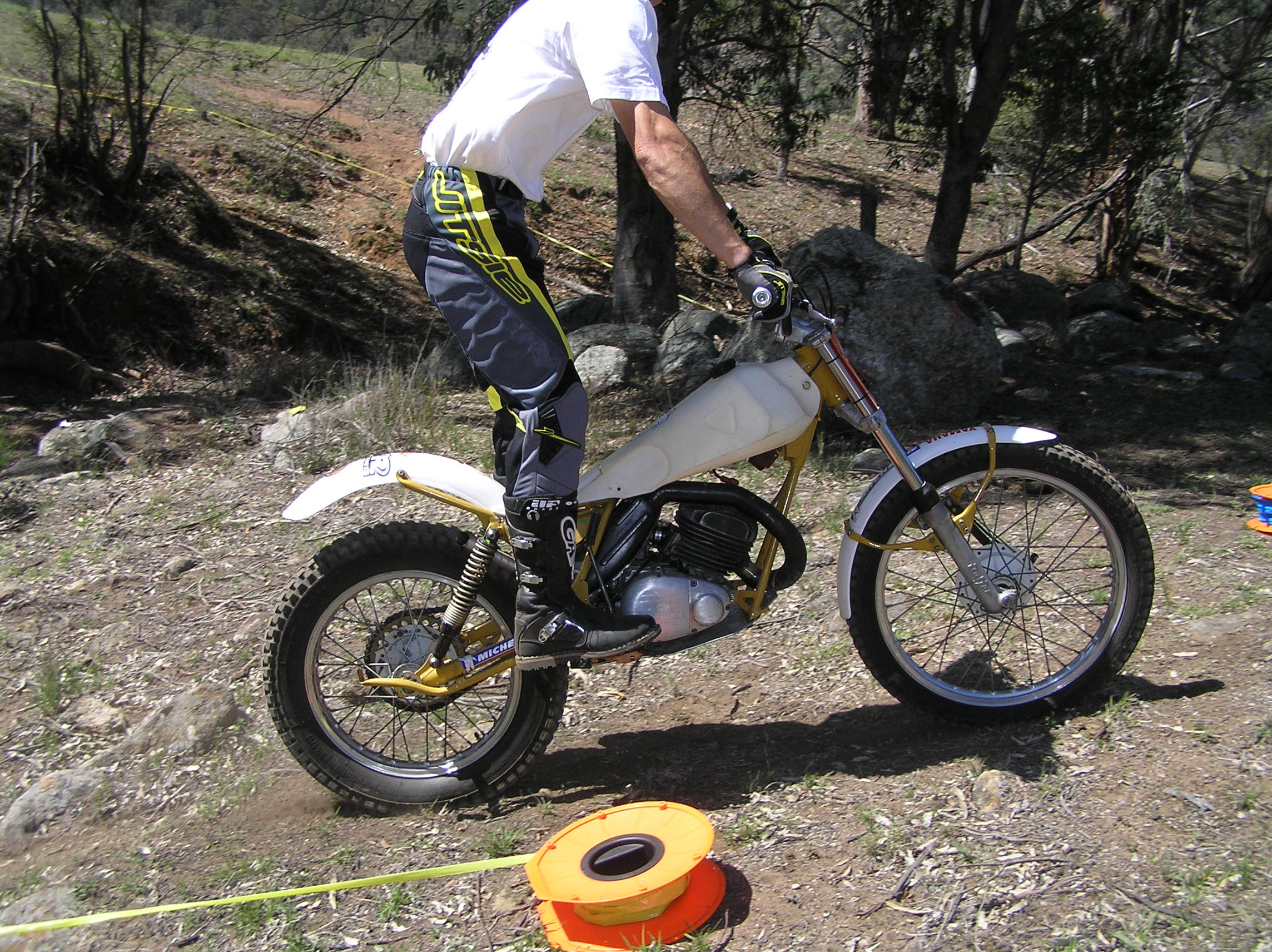

I'm always interested in modified twinshock trials bikes and while looking through old photos, came across these photos I took in 2006 of an interesting bike. Photo taken at a Denman MCC trial at Martindale, NSW.
- holiday sept 2006 148.jpg (880.88 KiB) Viewed 2491 times
- holiday sept 2006 059.jpg (833.49 KiB) Viewed 2491 times

Yeh, they intrigue me too Dave.
Looks to have massive ground clearance.

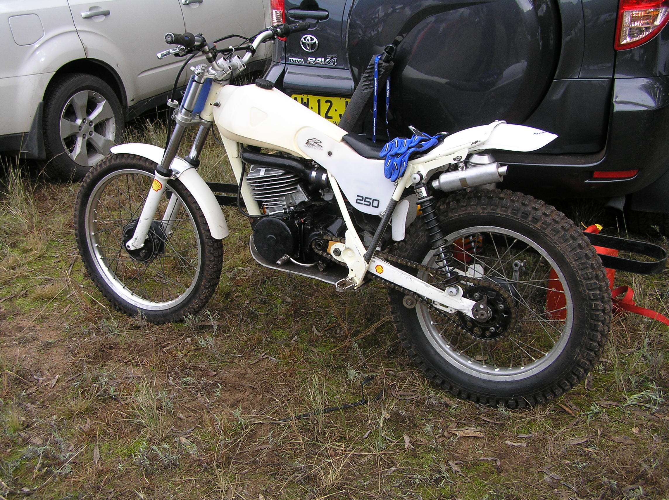

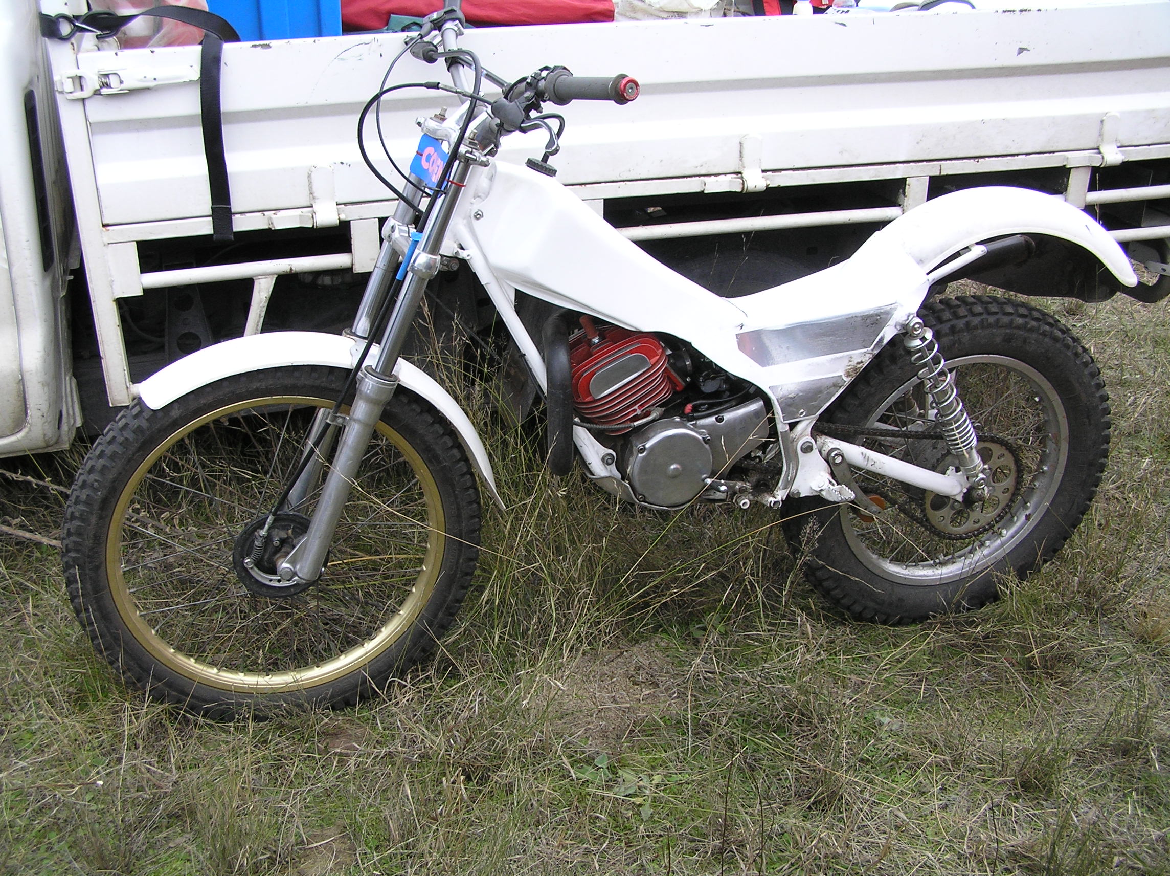

Here's another interesting Australian twinshock creation
- P1010120.JPG (840.97 KiB) Viewed 2432 times

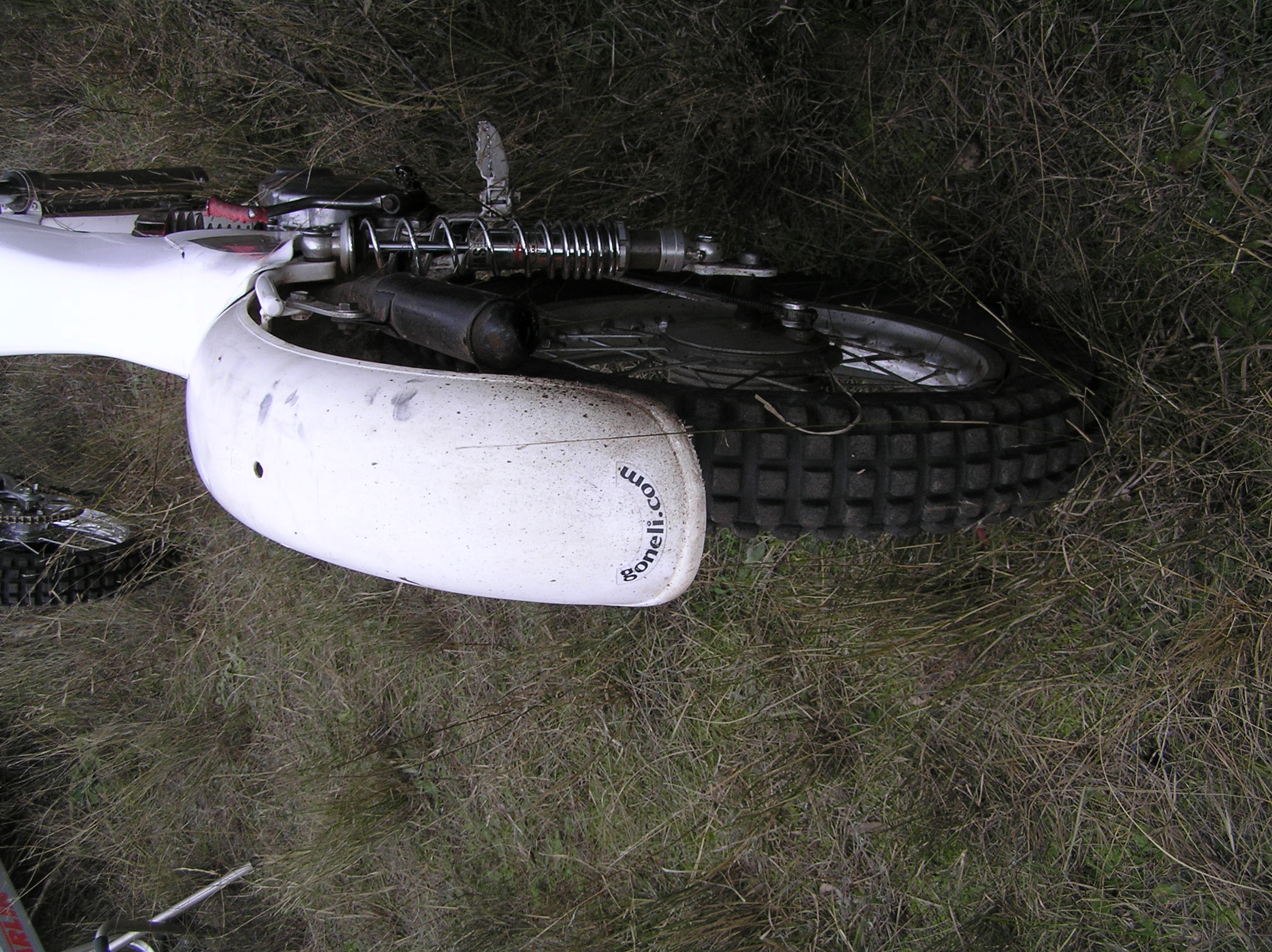

Seeing we're on a roll with these modified Twinshocks, how about this one that seems to have a bit of a
influence about it. That should hopefully please Greg Harding who often bangs on that I have something about bloody
s.
Notice this one has a
motor though, like the other two I posted up earlier also do
s. Notice this one has a
motor though, like the other two I posted up earlier also do- Attachments
- P1010133.JPG (810.19 KiB) Viewed 2422 times
- P1010132.JPG (854.49 KiB) Viewed 2422 times
- P1010131.JPG (833.79 KiB) Viewed 2422 times

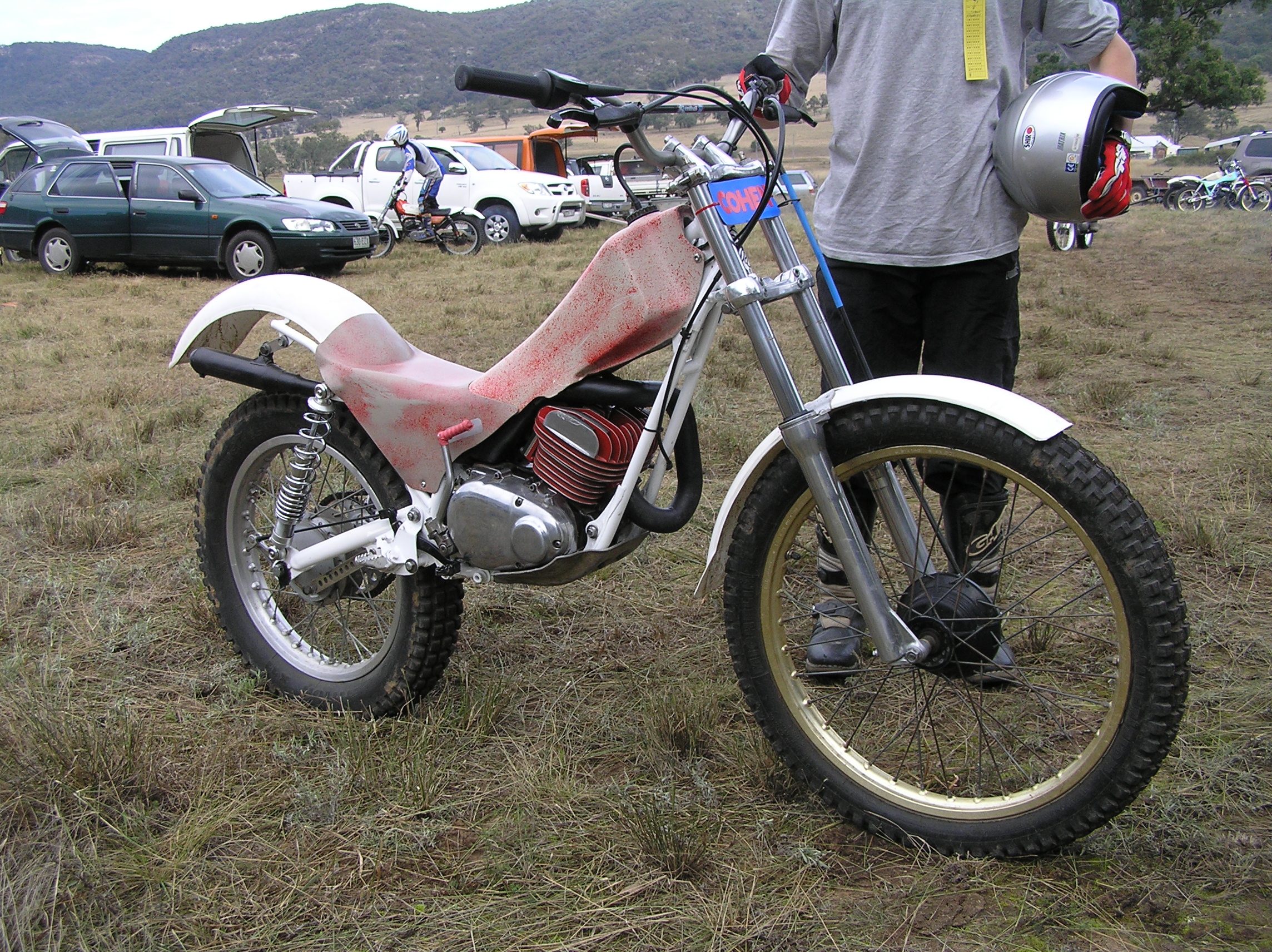

Nice ones Dave, keep them coming. The TY175 is rather radically modified but it looks good. Nice job, tho I wonder if they gave much attention to trail since it looks to be still using the TY triples, but with offset axle forks

I found another photo of that modified
TY175/
TLR200 that shows the amazing workmanship
TY175/
TLR200 that shows the amazing workmanship- Attachments
- P6130017.JPG (2.07 MiB) Viewed 2284 times

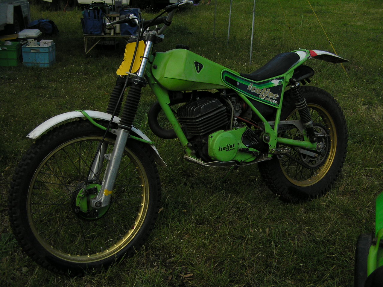

and yet another modified
TY175
TY175- Attachments
- IMG_4356.JPG (214.51 KiB) Viewed 2284 times
