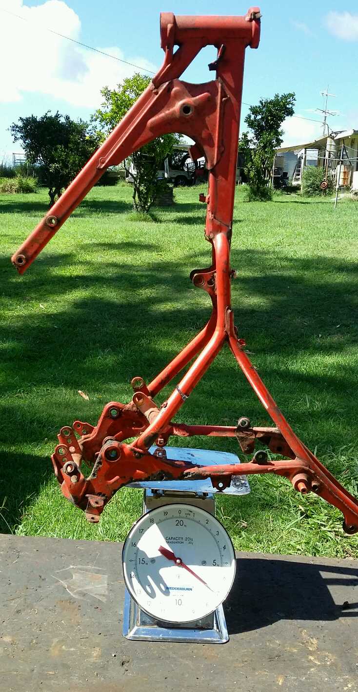

JC1 wrote:Greg, in answer to your request, here's the comparative specs listed for TLR200/250 in that order:
W'base 1315/1315mm
Ground clear 300/310mm
Seat ht 780/750mm
Footpeg ht 380/395mm
Rake 26.5/24.5deg
Trail 86/78mm
Wt 88/90kg
Thank you John, whereabouts did you get those specs as all I could find as a google search was an old post on here of yours from 2014 stating the same thing for :Honda: TLR 250 but not a comparison with :Honda: TLR 200.
Obviously the wheelbase is variable, what do they use, maybe Centre of axle slots?
Ground clearance variation of 10 mm makes sense with my personal data because TLR 200 damper rods are 10 mm shorter than TLR 250. Coupling that with TLR 200 shocks being 10 mm shorter between centres than TLR 250 even though they are not true lengths because of forks and shocks are mounted on an angle, so I think close enough? Not knowing the ride height that they are working with is a bit like the wheelbase that is adjustable!
Seat height makes sense because TLR 200 has a padded seat.
Footpeg height makes sense as TLR 250 has very high footrests in standard trim and footrests do not interchange between models!
Rake Simply Does NOT make sense because my frame jig for reworking the steering angle on the BLOODY :Honda: fits my TLR 200 frame which proves the steering head angle is exactly the same!
Maybe :Honda: hype comes into the equation as I cannot see how the slightly shorter forks and shocks can change the steering angle, (same ammount both ends)!
Trail Does Not Make Sense as well, yes I realize Rake is different to Trail but it can't be different on both models for the same reasons I have just stated about Rake! Pretty sure the Triple clamps measure the same ammount of offset!
Both of my TLRs now have the same frame geometry modifications along with a couple of others that I have done, both of the others were TLR 250s, my TLR 200 is the first one that I have done. When you look at both bare frames side by side. The TLR 200 has extra brackets for repositioning the gear lever, a cup shape bracket in front of the top steering head bearing may be for steering lock and another bracket behind righthand side cover rear mount maybe for battery box? As yet I have not had a good look at a Reflex but I think the frame is very similar to the 1983/4 TLR 200s?
TLR 200 frame is slightly heavier than TLR 250, I assume because of the extra brackets.
