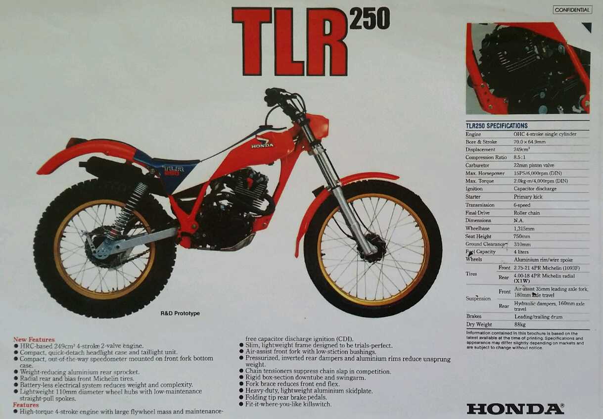

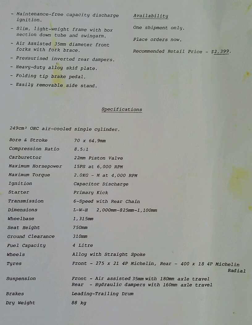

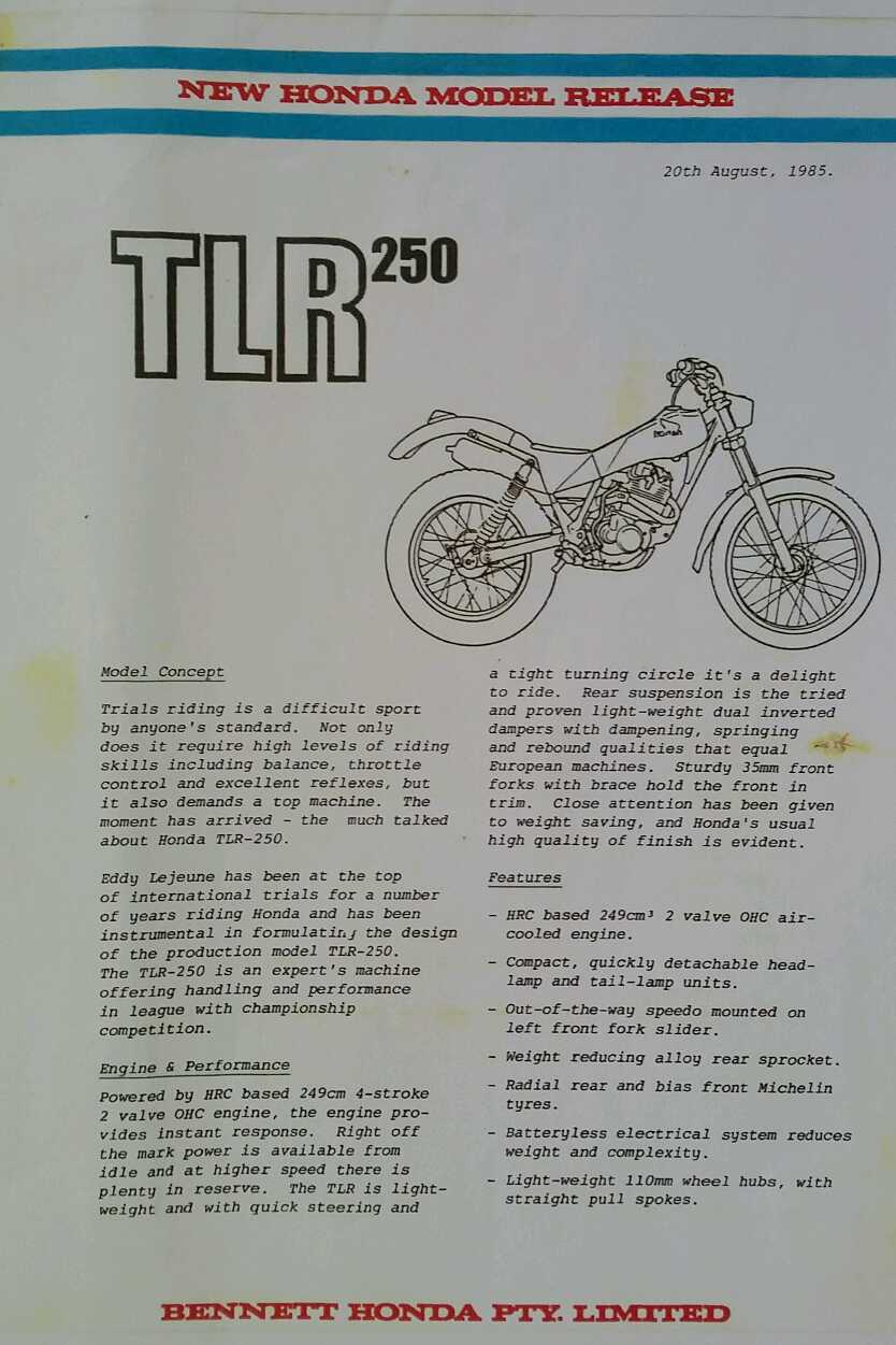

Has anyone got similar brochures for TLR 200? There is an old story that :Honda: Australia bought 1 bike in but never pursued it until the 250 came out, I have always been curious about how many :Honda: TLR 250s were sold in Australia?
Might it be 80?

:Honda: TLR250 = 88 kg (measured at the brochure) :roll:

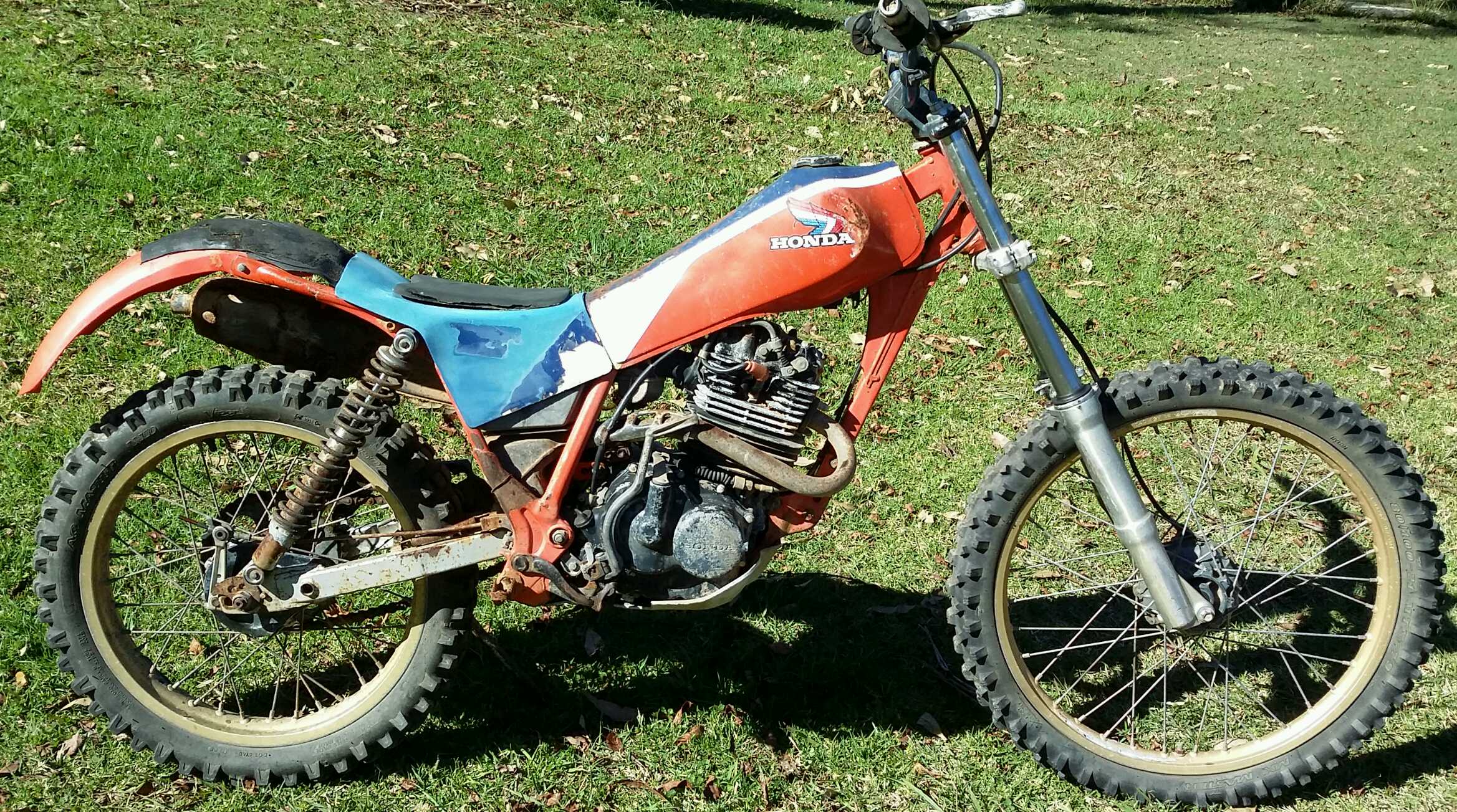

Just thought I would give an update on my :Honda:, I am really enjoying the riding and it certainly makes the effort worthwhile. Having ridden it for the last 3 weekends and getting feedback from the bike along with fine tuning some of the little things makes me really happy! A couple of things that I wasn't happy with have now all been resolved with the main bug bear being the clutch that was not very progressive. The feel and drive were good and the motor in general has not done much work, it is a warm and fuzzy feeling removing the clutch cover and finding Genuine :Honda: gasket and unmolested JIS screws (similar to Philips) holding the filter cover. Even better when there is almost nothing caught in the filter. Makes me think very low Kilometres so the clutch wasn't slipping even with a fair bit of abuse punching up steps. However the snappiness plays havoc with my timing and I find that I can be further ahead than I want to be rather quickly.
The BLOODY :Honda: (TLR 250) had worn clutch plates and more torque so I went with Barnett plates and the Anti Judder Kit to make it more progressive. The results are no slip and progressive feel but the 200 is a bit different and I think more snappy in the clutch than the 250 ever was. So the fix was simply fit the Anti Judder Kit:
The thing that I find interesting is it was a fix from back in the day, if you complained about the clutch being snappy while under warranty, the fix was free and if you left it until out of warranty you had to pay! It certainly works as I can now stand and balance on full lock and take off in any of the bottom 3 gears without reducing lock. Whereas before it was simply awkward, in the same situation it would push the front straight ahead ploughing on loose surfaces or lift and skip the front until it bit in on anything a bit grippy.
