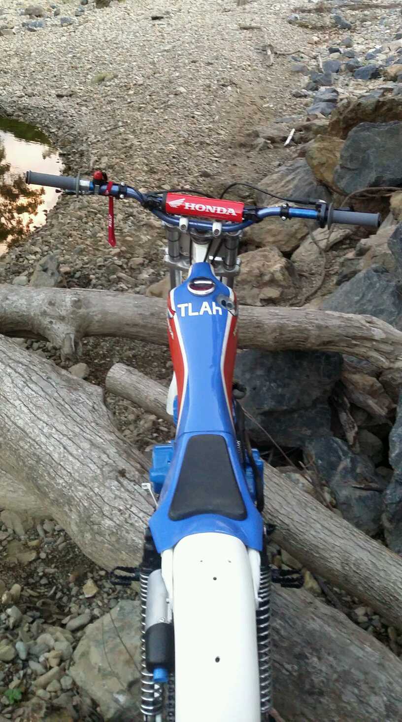

Graham, going smaller on the front of a :Bultaco: doesn't make much sense because of how far back the swing arm pivot is. Going bigger on the rear helps to alleviate the clearance problem even if it creates a new problem with the low side of the chain rubbing on crossmember between frame rails, just my thoughts.
Oh and just for the record and trying to avoid the EYE-TAL-JET / IT- AL-JET confusion!![]()
It is TLAhhhhhhhhhhhh
Now say it out loud
TLAhhhhhhhhhhhh
And again louder so I can hear
TLAhhhhhhhhhhhh
Well a virtual ride on the Hardwood T L ahhhhhhh is probably a good thing because if I had a real ride down there in the lush mountain terrain, I'd be worried about getting more bullet holes in the tank. Have you been riding too close to some hemp production facilities again?

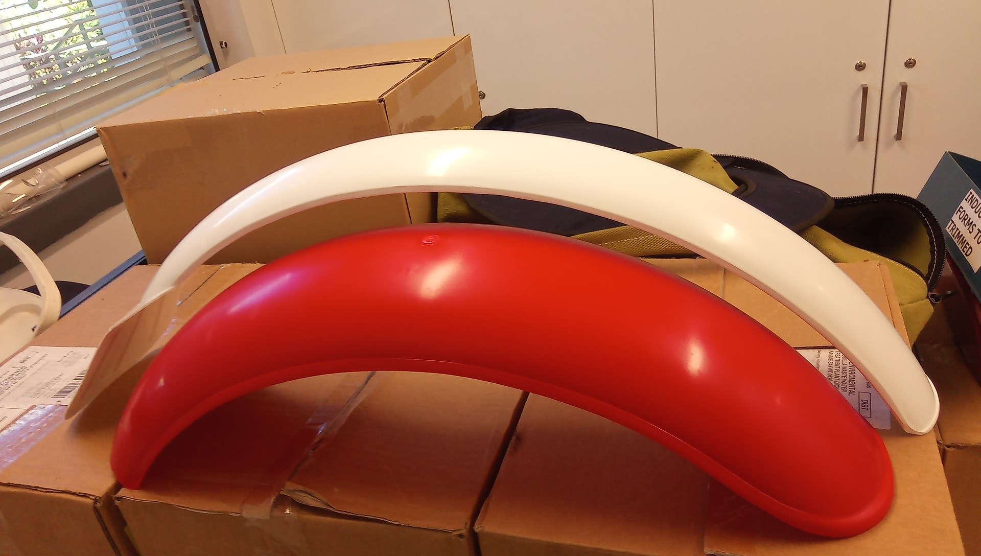

Today is a good day!
Who's a happy boy then?????????
- guards.jpg (233.54 KiB) Viewed 2432 times
