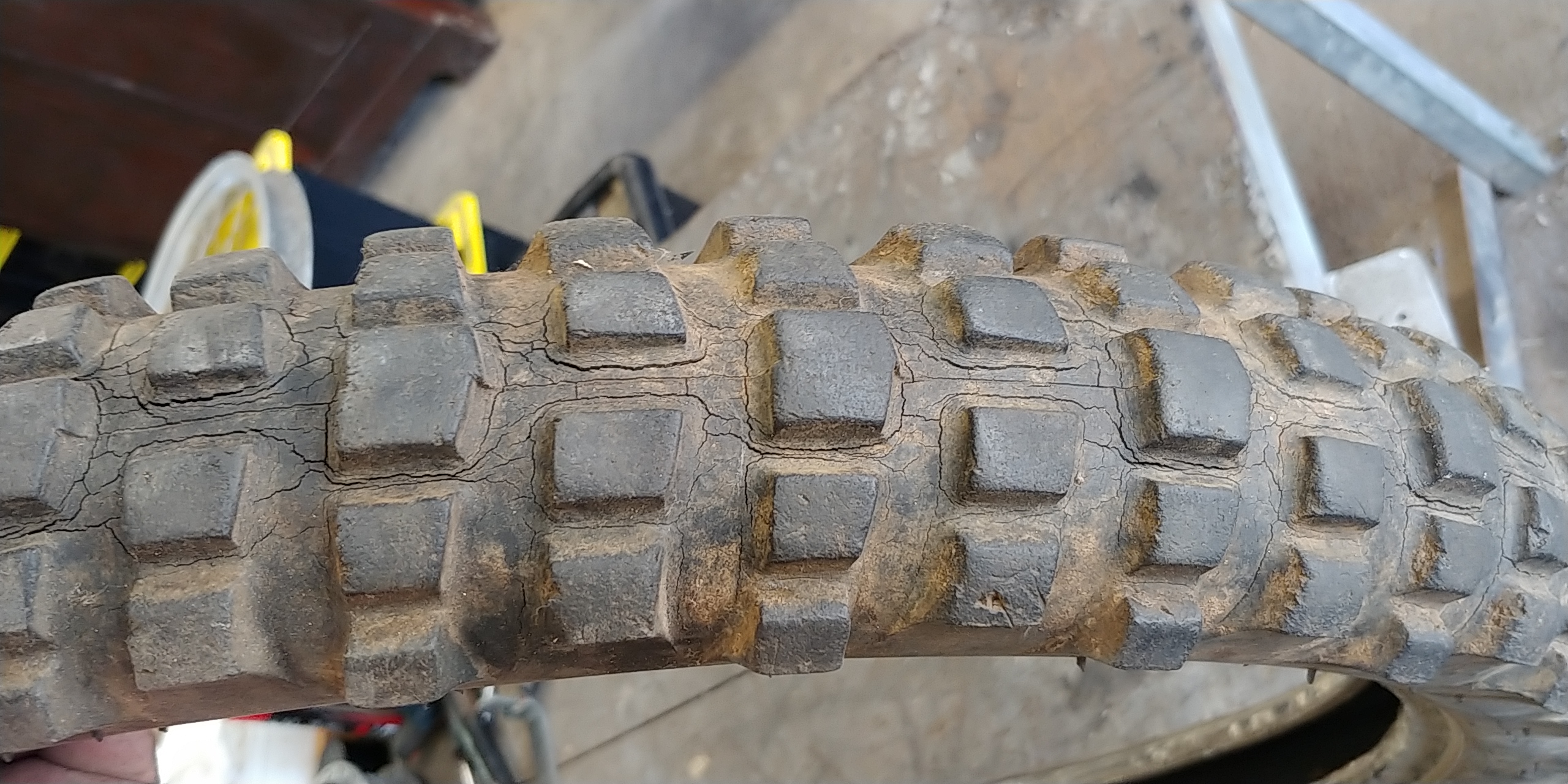

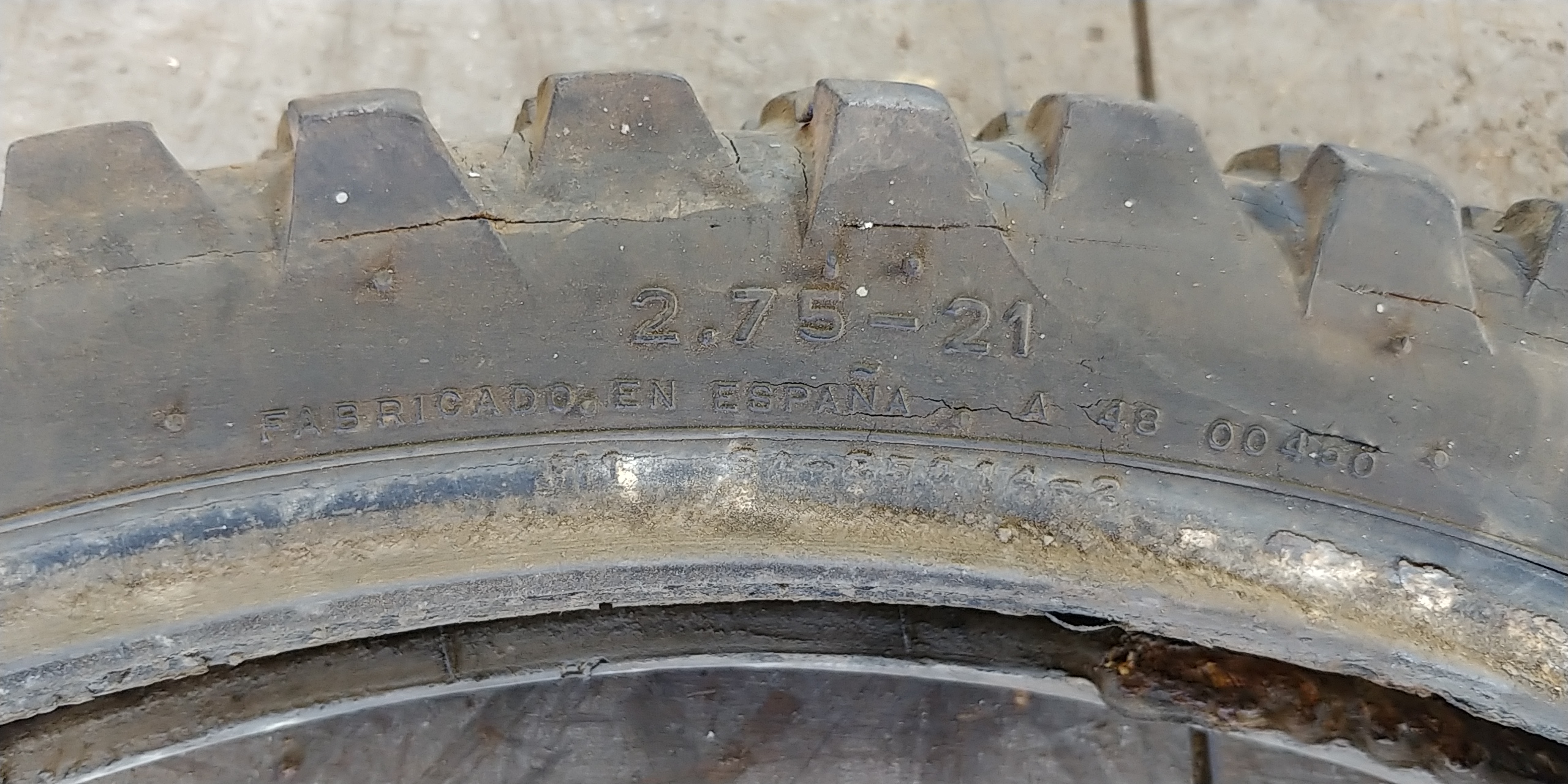

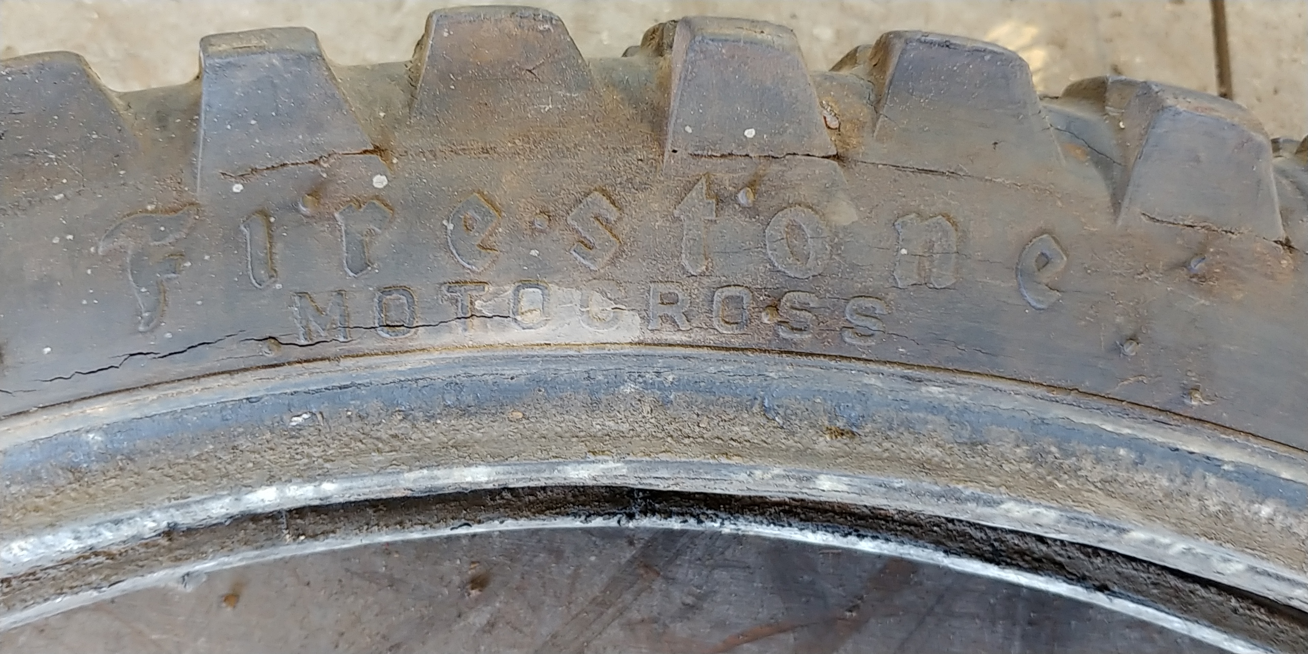

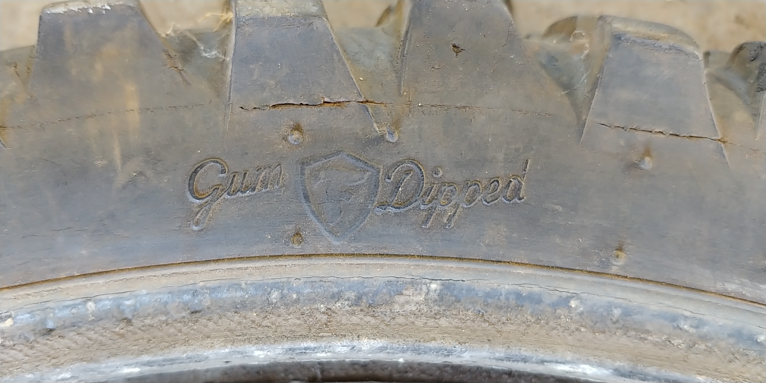

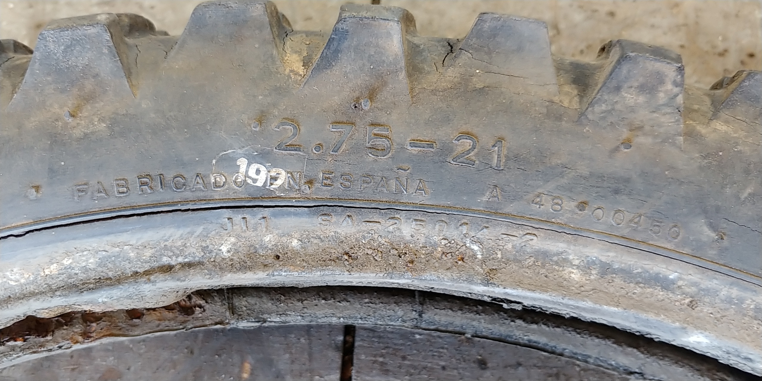

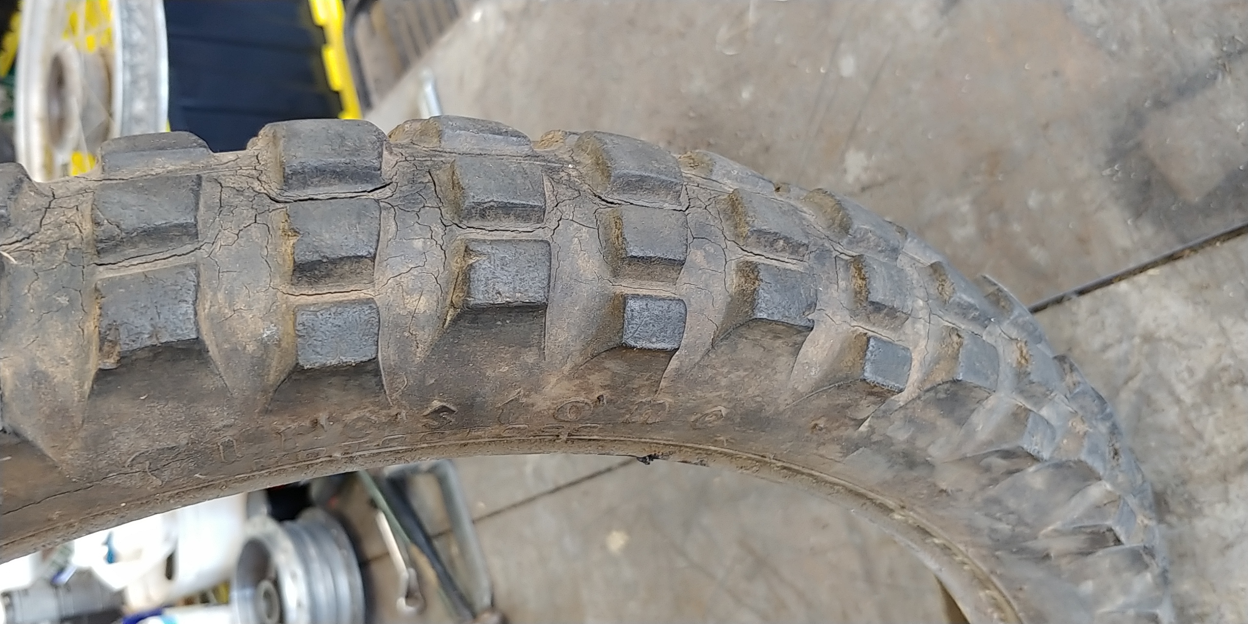

Very old tyre
I started rebuilding an old Bultaco front wheel last weekend and noticed that the tyre that was on it is an old Firestone "gum dipped" type. Until then I thought that those old Firestone tyres were made in the USA but it clearly says otherwise. The wheel is late 1960s era and I'm thinking it might even have been the original tyre on it.
Does anyone remember these tyres?

I can remember seeing new Firestone tyres in at the bike shops in the mid 70`s. I`m sure Don Newell had some in the Valley.
Bully fanatic wrote:I can remember seeing new Firestone tyres in at the bike shops in the mid 70`s. I`m sure Don Newell had some in the Valley.
I can remember that my M99 Alpina came with (worn) Pirelli knobbies on it in 1975. They had a funny name (xxxx-cross?) that I can't recall but do remember that they also came on Spanish MX bikes and the US magazines didn't like them.

David Lahey wrote:Bully fanatic wrote:I can remember seeing new Firestone tyres in at the bike shops in the mid 70`s. I`m sure Don Newell had some in the Valley.
Pirelli "GARA-CROSS" from memory

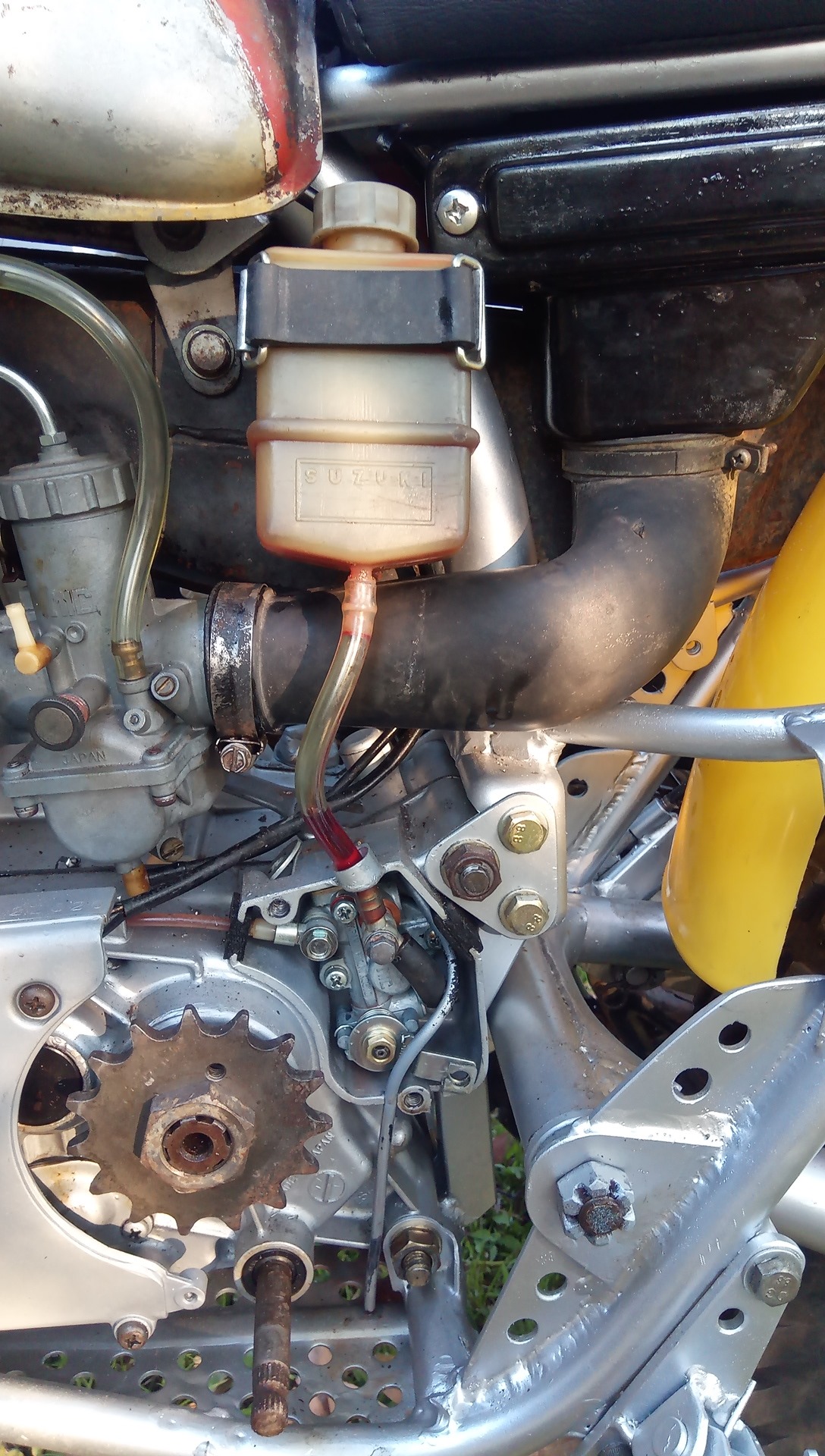

RL 250 oil tank
This is the oil tank set up on my RL. I made a bracket that mounts to an unused boss on the frame and the oil tank slides out to fill it.
It tucks under the seat but interferes with the side cover so I'm not sure what I'll do there

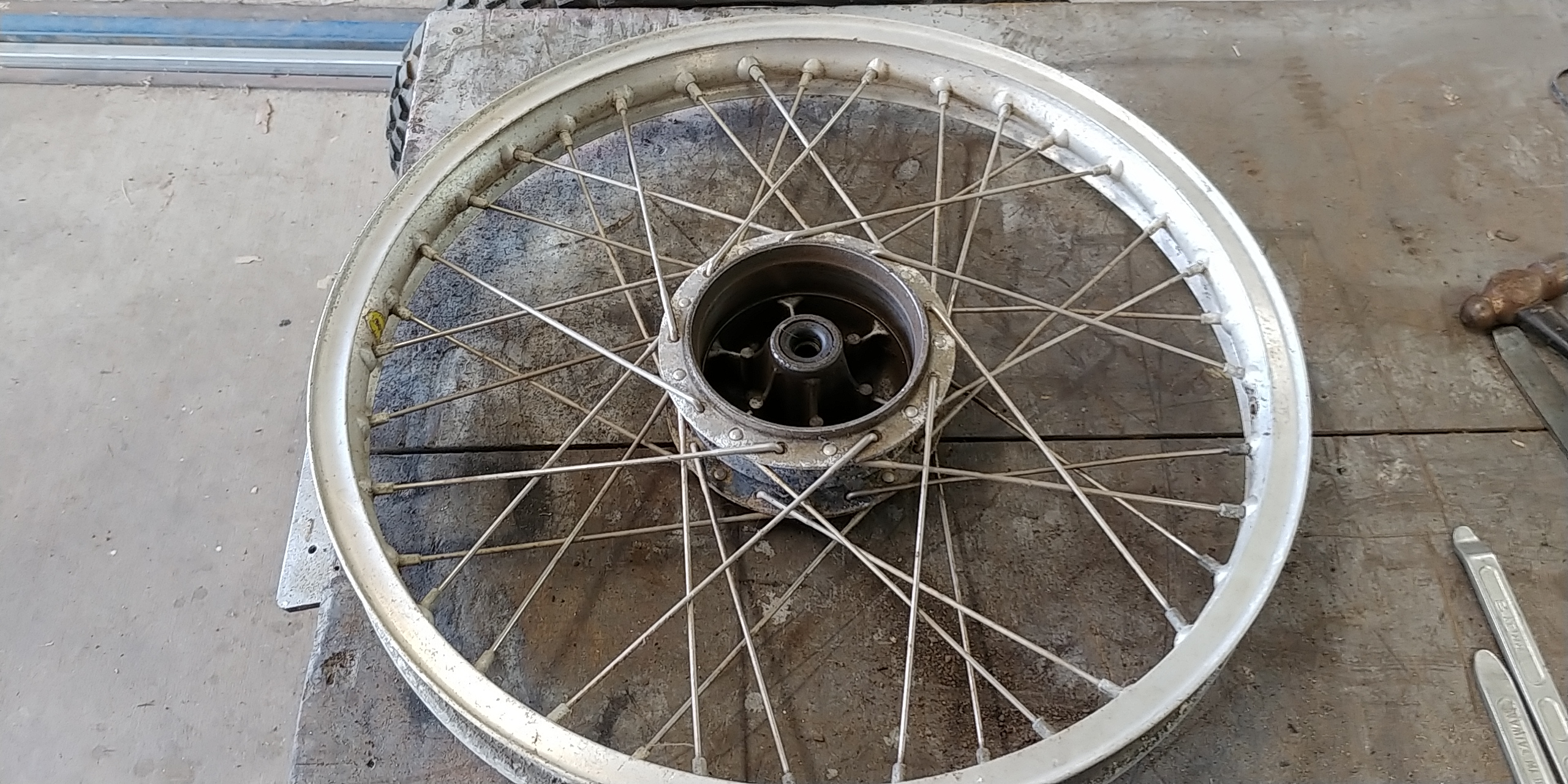

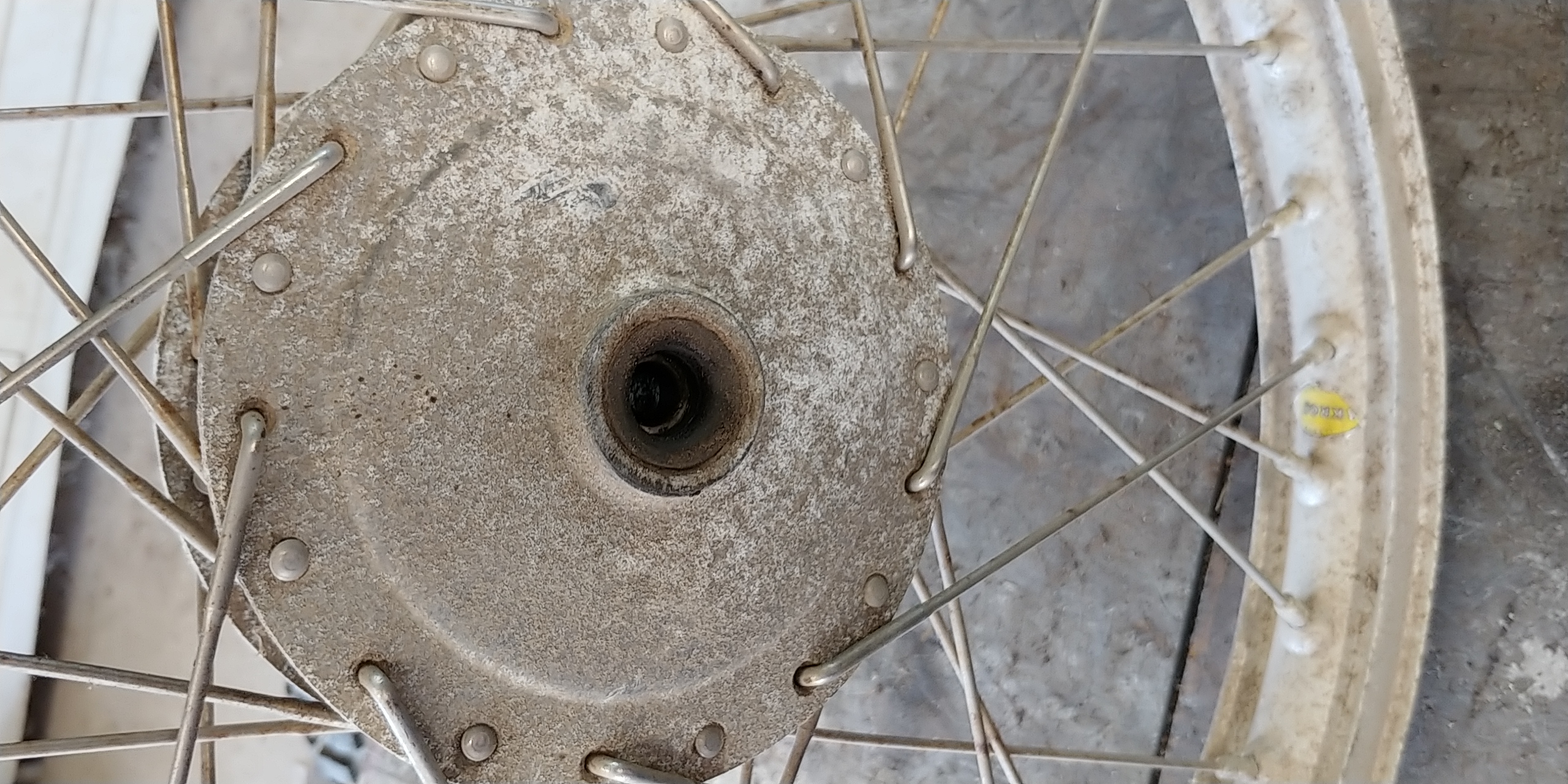

I had an RDO today so spent the day setting up the rear wheel for my RL250 project.
I knew it was rough but hadn't worried too much up till now. 4 out of 6 studs had been removed and drilled all the way through the hub and had bolts and nuts. The bolts were a mix of 1x10mm metric coarse, 1x3/8" UNF and 2x3/8" Whitworth. On stripping the wheel I found that not only were the other two studs broken but one had been drilled through the side of the stud and the other had a broken of "Easy-out" imbedded in it.
I have another pair of hubs (front and rear) but they are put aside until I get the bike running and buy new spokes.
After a few hours work the broken studs were removed and all the holes squared up, re-drilled fitted with 10mm fine thread bolts cut to length. There are nuts on the inside because there wasn't much choice.
Then there's the sprocket.
I got hold of a new 54 tooth sprocket that is off an unknown bike. The centre hole is about 170mm dia. I used an old Suzuki sprocket with the correct centre holes and machined it down to about 190mm OD and cut a slight lip to suit the larger sprocket centre. I've welded the two together and the overlap has the same effect as the spacer I would usually have to make.
Win some, lose some.
No wonder these jobs take so long................
