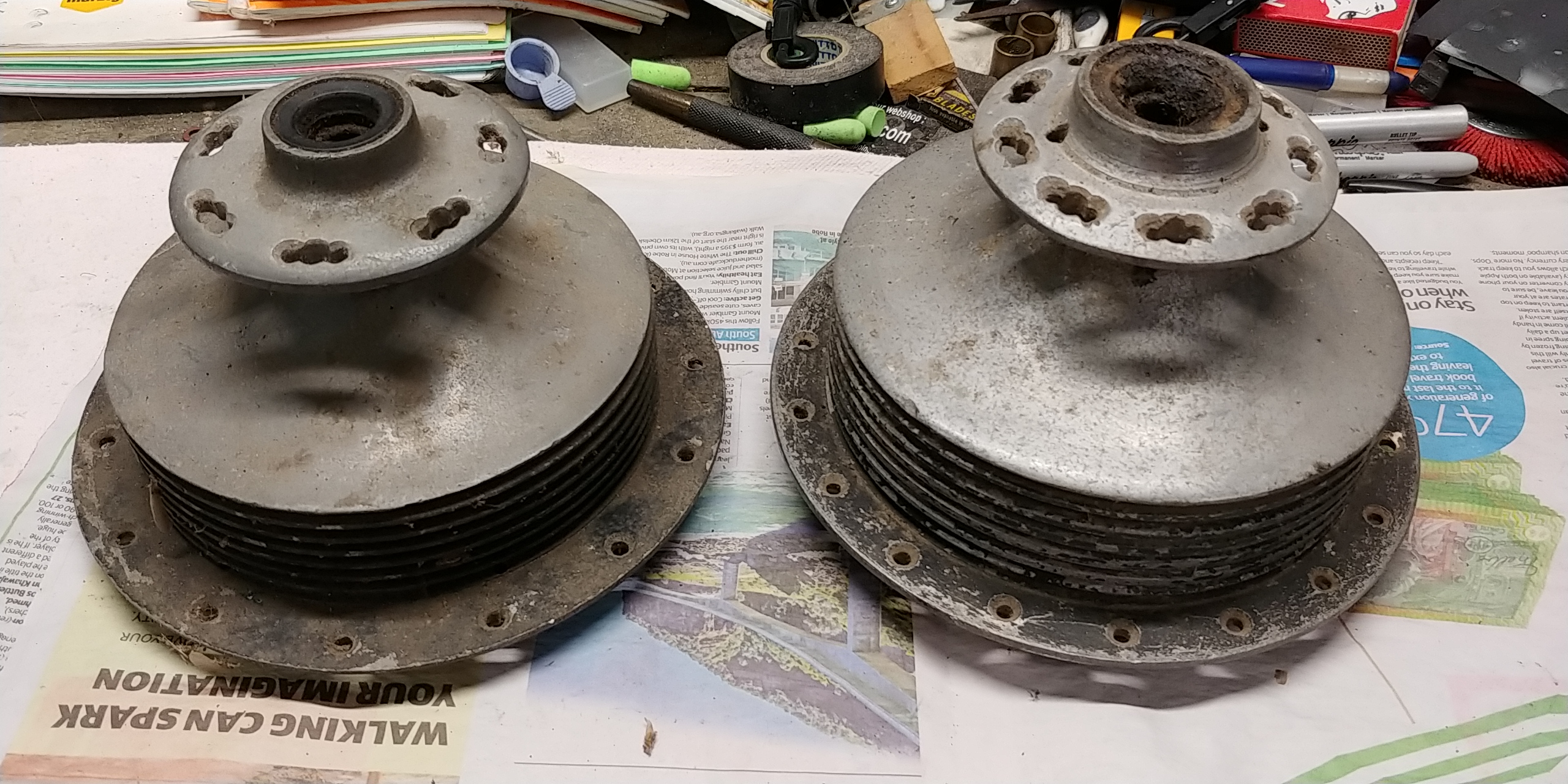

So I decided to have a closer look at the all-aluminium :bultaco: rear hub I posted up a photo of a couple of days ago. When I lifted it up for a better look I found another all-aluminium :bultaco: rear hub hiding underneath.
I then realised that they are quite different and this might give clues to Bultaco experts who might see this posting to identify what :bultaco: models they might be from.
I see that one of them has 28 spoke holes while the other has 36 spoke holes. I figure the 28 spoke hub is made for a small diameter :bultaco: rim because old 18" wheels usually have either 36 or 40 spokes.
Both have 140mm diameter brake drums.
Does anyone know what :bultaco: s they are from?

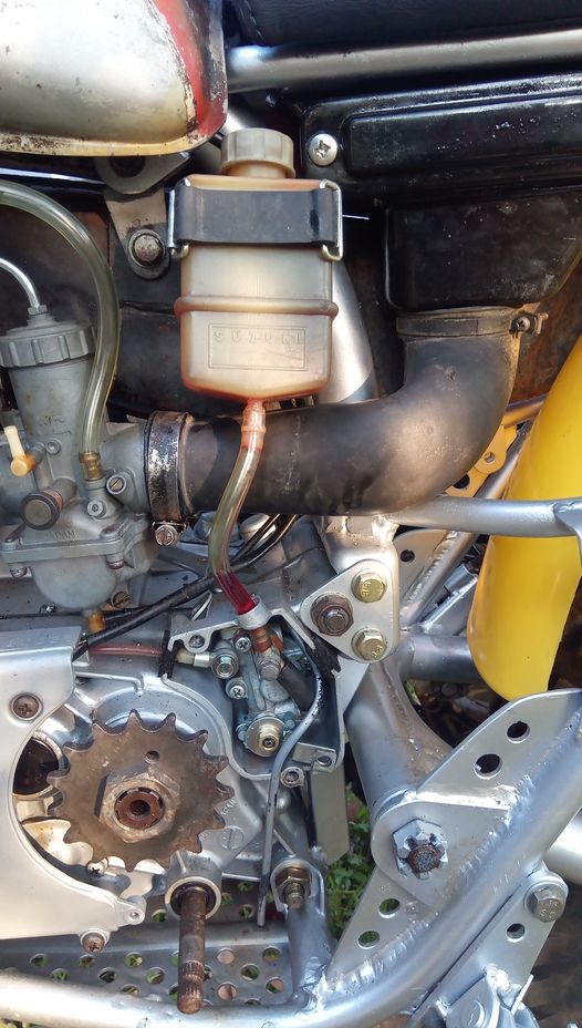

I'd heard and read stories of how RL 250's can be hard on LHS main bearings, largely due to the extra flywheel weight and a lack of lube with pre-mix. When I got my TS250A engine (for the clutch mechanism) it had the oil pump and slinger in place. The RL cases are drilled and tapped for oil to the crank so I fed the cylinder oil feed back into the pump inlet line and dropped the 250A crank in complete. The TS crank is the same as RL and was in better condition than mine.
Now I have a dedicated feed to the LHS main bearing and big end. There is no cable to the pump so it stays in the idle position.
I'm running about 50:1 premix and the little Suzuki racing kit oil tank last about 3 tank fulls of fuel.

brent j wrote: Now I have a dedicated feed to the LHS main bearing and big end. There is no cable to the pump so it stays in the idle position.
Love your work Brent, I always wondered what that bracket was for, it is a neat little oil tank.

As for my 28 spoke rear :bultaco: hub, I finally decided to do a google search and was rewarded with someone selling a set of 28 spokes for a :bultaco: Mercurio. With that info, I then did a google search for photo showing the back wheel of a :bultaco: Mercurio and there it is.
One mystery solved. Now what about the 36 hole :bultaco: all-aluminium rear hub?
Seeing I was on a roll working out the identity of old Bultaco parts, I had a go at identifying the other all-aluminium hub which according to this UK eBay listing appears to be early :bultaco: Pursang. Wow
